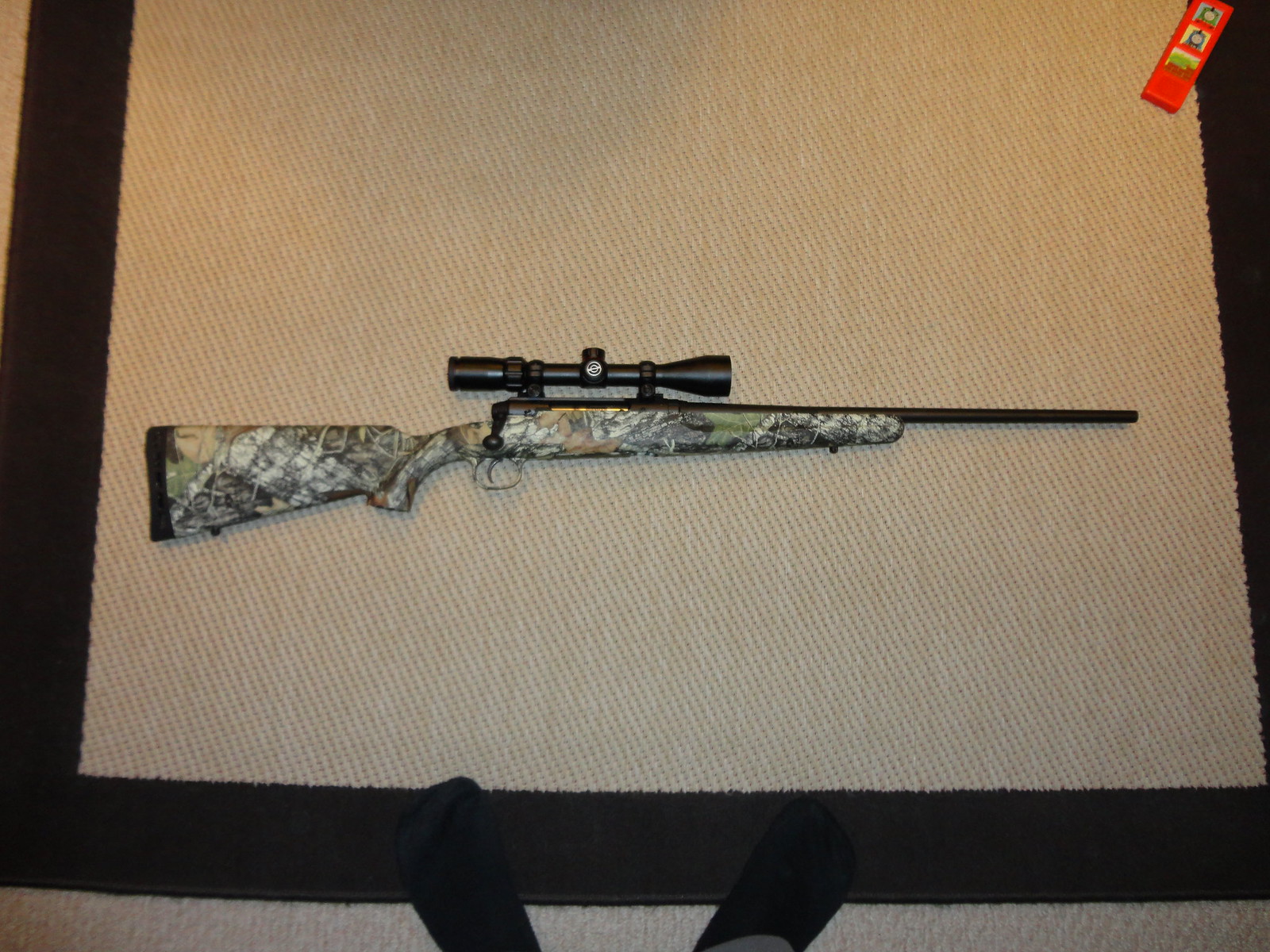

The rifle has a 22 inch barrel and a 1:9.25 twist. I was wondering if anyone here has experience with this rifle and calibre combo. I want to hunt white tail. Looking for bullet weight info that would be best for that twist and barrel length and if anyone has any Data that they worked out for theirs.

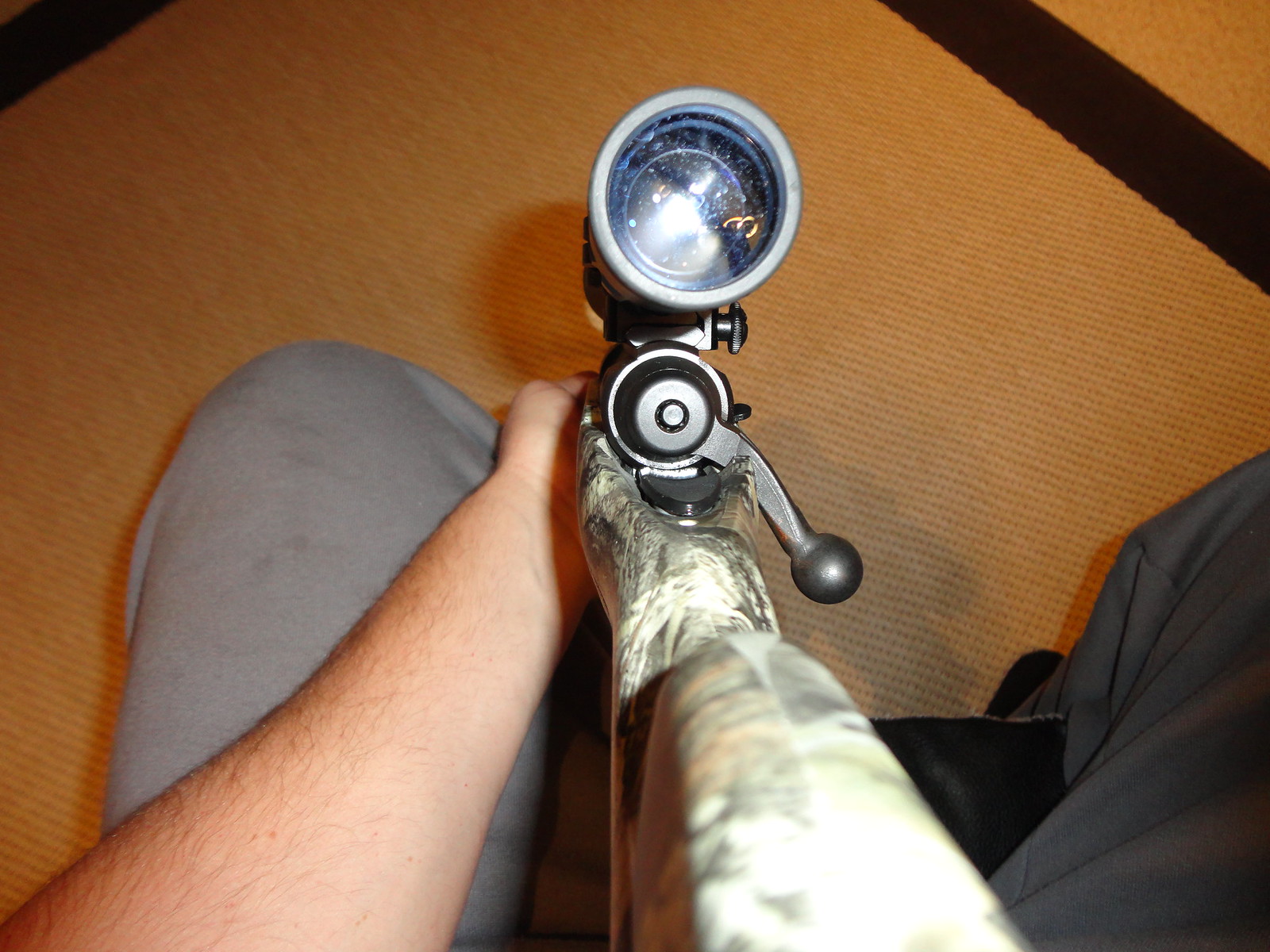

You might want to look at getting some lens cleaner for that scope.... It looks like a bit of water spotting / grunge on the eyepiece end of it.
Sorry, can't offer any suggestions about bullet weights.....
