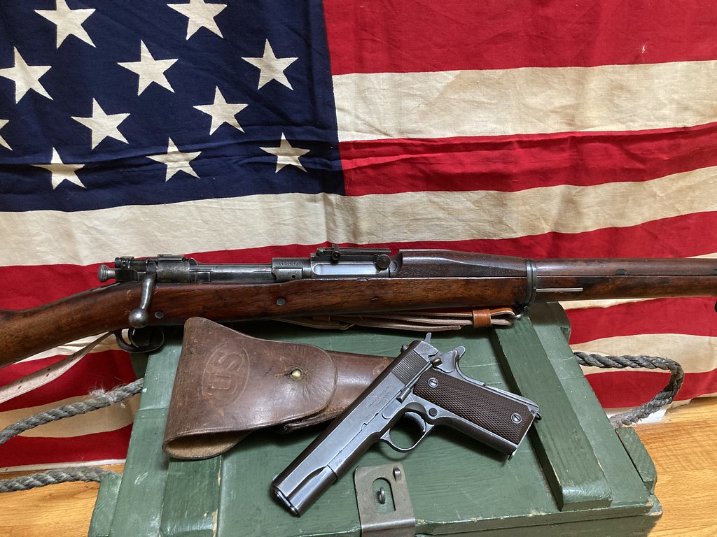

Personally, I was looking for an M1903 that would be representative of what the USMC was issued and used during the early Pacific campaign during WWII. I ended up narrowing it down to a few key elements that generally fit the bill. I wanted the rifle to be an M1903 and not an M1903A3 pattern rifle, I wanted a rifle with a pre-WW2 dated receiver, and if it did have a newer barrel, to be 1930's dated at the latest. I also wanted something that hadn't been NON-USGI refinished or overhauled, even though a rifle that has gone through Vulcan or had a commercial barrel on it would almost certainly shoot much better. Given that an overwhelming majority of rifles issued to the USMC immediately before/during WWII would have been through some form of refurbishment/rearsenal/overhaul/rebuild etc... during their service life, I was quite happy with a "Government" rework. I ended up finding a very nice Springfield 1917 dated rifle with a 3-17 dated barrel and Remington M1903 stock from the 1941/1942 time period, which fit the bill perfectly and didn't cost anywhere near the amount of what a "correct" 1917 dated rifle would cost me. This rifle is a "low number" rifle that I have and do shoot on occasion with my handloads. More on that later.
