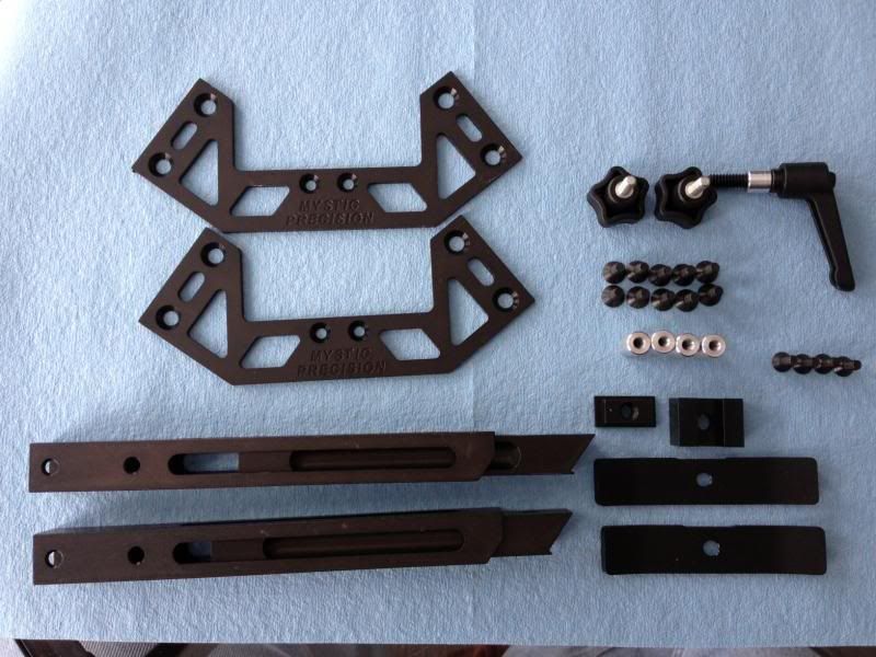

So I received the MPOD today. Come in piece that you have to assemble yourself, takes about 15 minutes to put together. Nice machining, everything fits tight and precise. Very happy with my purchase.

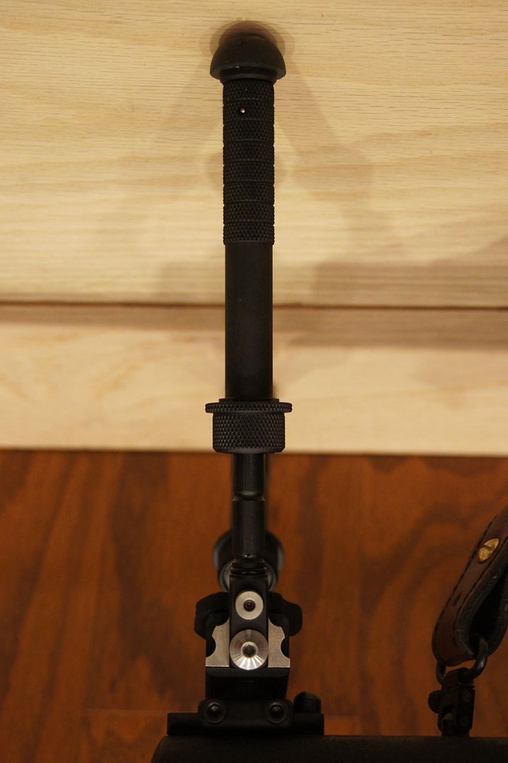

Do you concern yourself with minimizing play in the leg mechanism? Do you tighten the side screw after dropping the legs down, or just leave it tight enough you can swing the legs in and out of folded?
