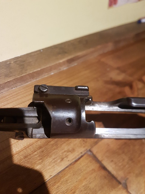

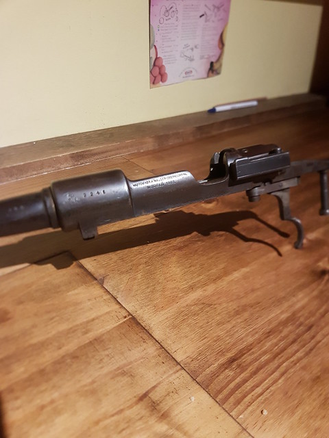

i picked up this rifle receiver for a sporter build i have in mind, but im not sure what it is exactly, im assuming its a m98 large ring.
will just a standard 98 bolt fit this receiver?

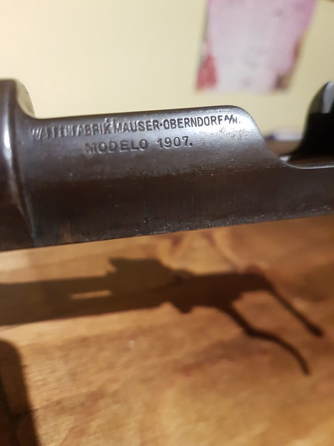

i believe this is a Modelo 1907 made for Paraguay
this is what wiki says about it
"The Models 1904 and 1907 were similar to the Gewehr 1898. They featured a longer cocking piece. Only the rifles made for Paraguay kept the Lange Vizier sight of the German rifle.[1][2] While most of the rifles were fitted only with a short bayonet lug that required a bayonet with a muzzle ring,[3] rifles ordered by Paraguay and Ecuador had another lug to fit the Mauser Model 1895 bayonet"
The intermediate length is referring to the size of the action - the bolt will be slightly shorter than a standard 98. Other parts, like triggers, might be the same, but bolt body, extractor, firing pin, possibly cocking piece and shroud are found in both "standard" and "intermediate" length mauser 98's.
From Ball's "Military Mausers of the World" 5th edition, pp. 273-275, the Paraguayan Modelo 1907 would have been chambered in 7.65x53. It was made at Oberndorf - same as yours - and was received as both rifles and carbines. No mention that I could find regarding the action's length. Do you have another mauser's bolt to try in it?

"the Paraguayan Modelo 1907 would have been chambered in 7.65x53. It was made at Oberndorf " yes this is the rifle in question

Your rifle appears to be one made for Paraguay that was shipped to Turkey for the first world war . the two holes in the rear reciever bridge were for an extended clip charger , this was a Turkish modification. there is more info on this on line.
I have used a Yugo M48 bolt in a German made intermediate length action. The Yugo's use the "safety breech" style bolt face but they will work in the standard breech style receivers without issue. A M48 bolt is probably your best bet as other intermediate length bolts are hard to find. Turk 1903's (German made) are fairly common but it seems hard to find a bolt that isn't heavily worn from years of hard use by the Turk military.
Also, I would suspect your action has a small ring thread diameter with a longer shank than a standard M98 barrel. You will most likely have to modify that 9.3 barrel from Tradeex to fit.
