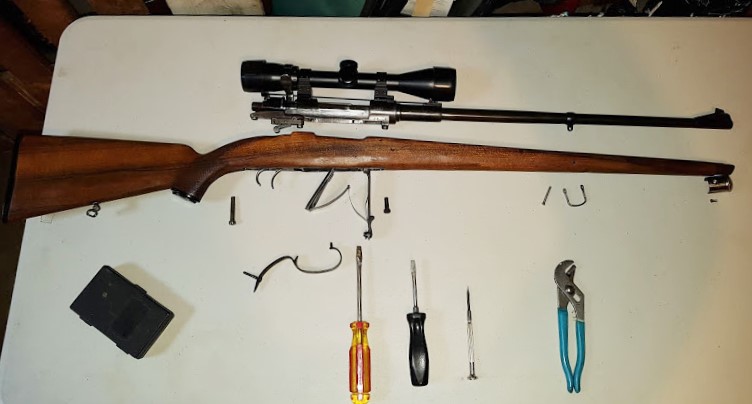

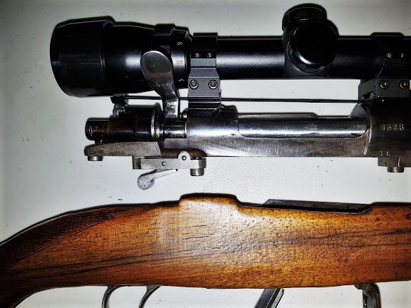

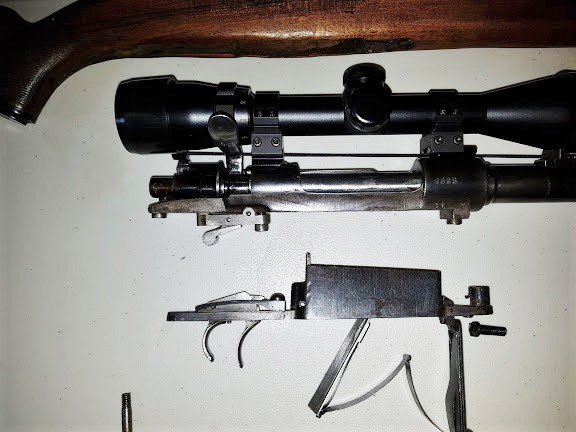

I want to say this is what i have for a receiver. All the measurments are correct other then mag opening in the receiver.
