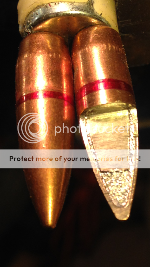

I didn't load the bullets backwards, but I went "full hillbilly" and made a simple jig (7/32" hole drilled into a piece of 1/4" steel and tapered for a decent fit with the bullet tip taper) and using my belt sander, ground down the tip of the bullet to a flat slightly larger than the primer, i.e. about 7/32" or 0.218". This is not benchrest precision in handloading (it's a 30-30 Lever Gun!), but they shot as well as the 150's and 170's I usually use.
I used a cruder method. A side cutter to clip off the tip[ and then a file to clean it up.

You'd be hard pressed to find surplus that isn't steel core. From my experience anyway.
Last batch of Czech surplus I got from crappy tire:
You can't see it in the pic, but the base is exposed and the rear of the steel core is visible. You can see how, if enough of the tip was ground down, the steel core might try to become the bullet instead, and squirt out of the softer lead and copper.
You can also see that there's not much lead in there to expand in an animal once it's ground down, either.
It'd be interesting to see some high speed video of what a clipped bullet looks like as it clears the muzzle.
