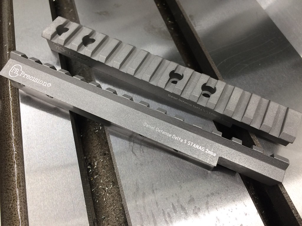

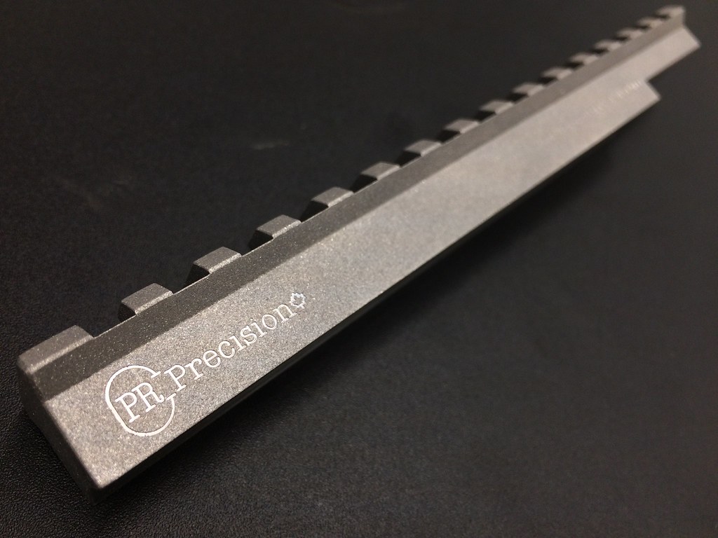

I was able to ship out a pair of rails I made for a CGNner's Daniel Defense Delta 5...
(Yes, that is a TWO moa rail)

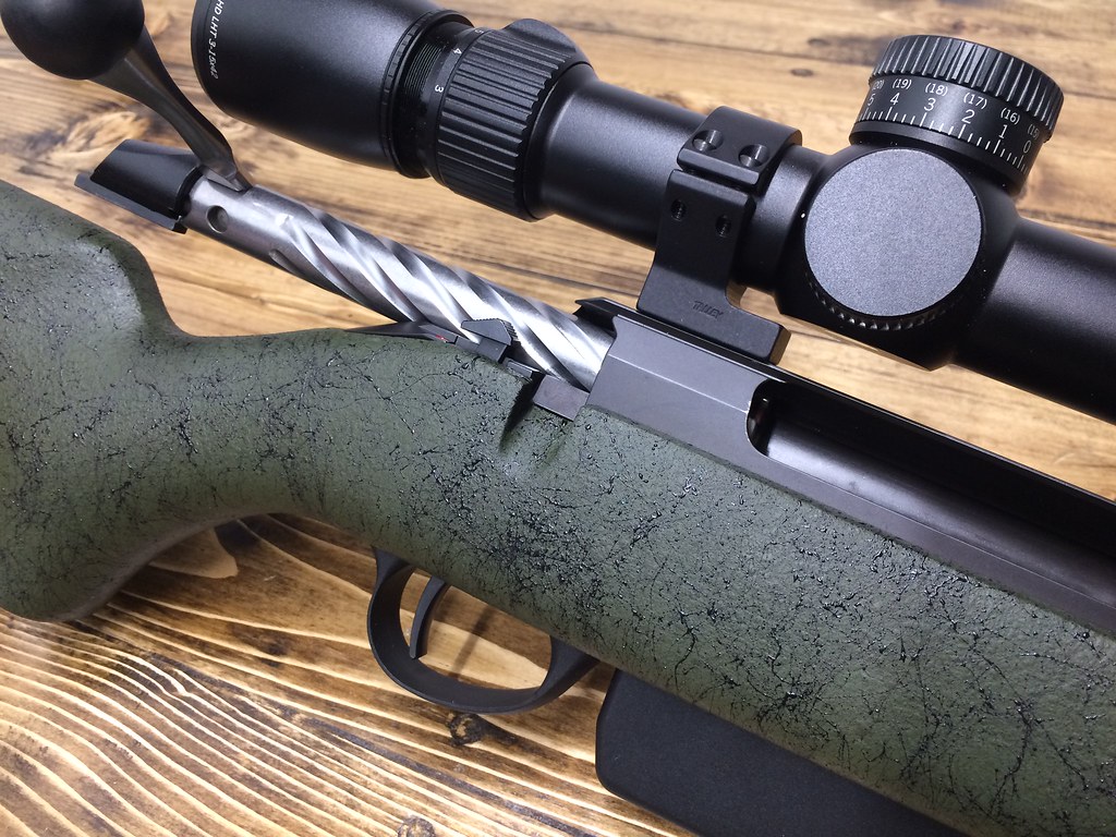

I finished bedding/ assembling a P14 project for a local customer...

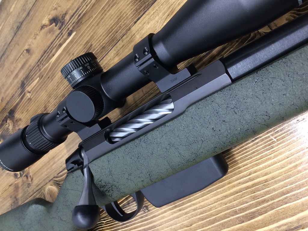

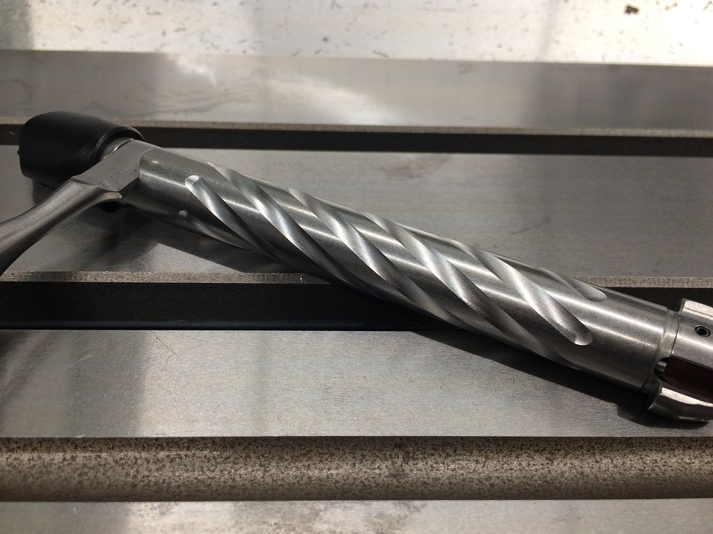

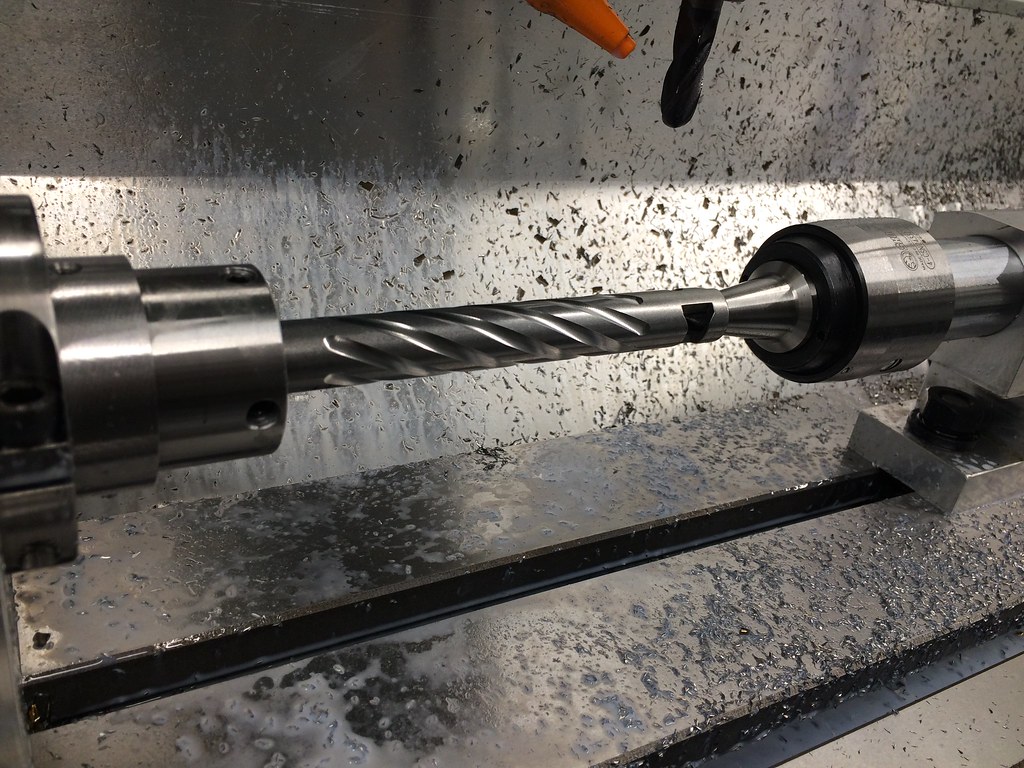

Fluted a couple of Tikka bolts...

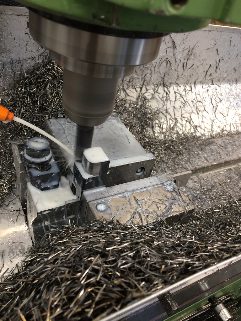

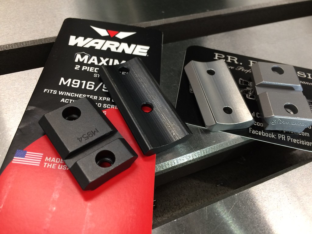

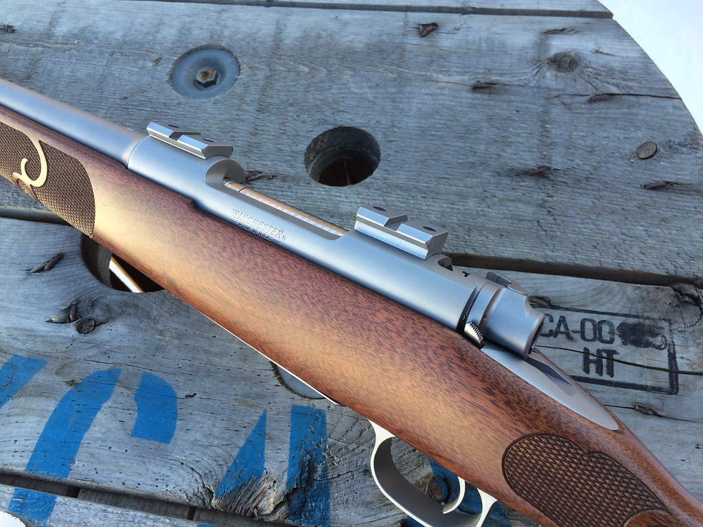

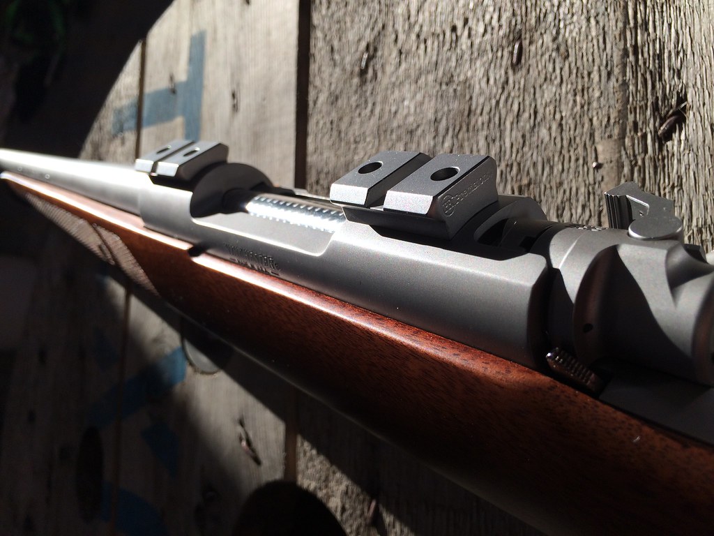

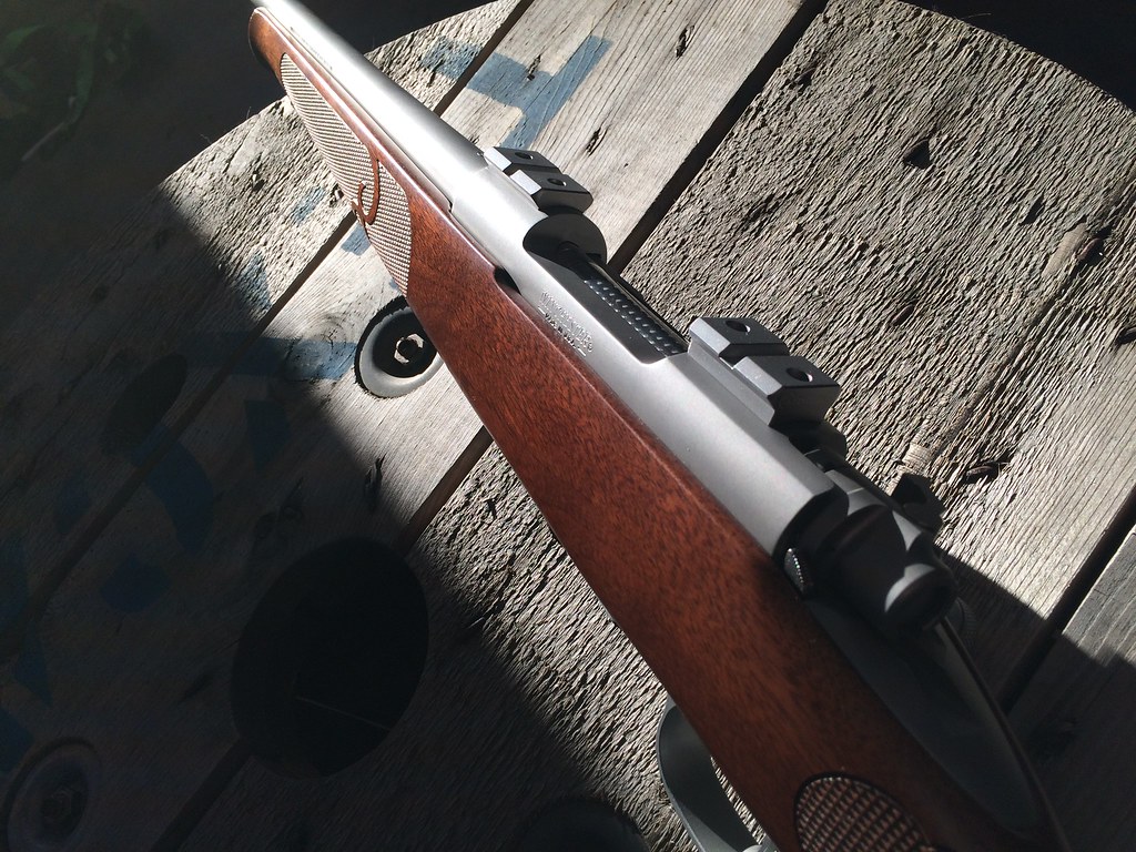

And I made/installed a 2-piece set of stainless, 20moa scope bases on a Winchester M70
Besides not being available in stainless, and not having any cant to them, here is a comparison to a set of Warne Maxima bases.
The customer was very happy!

That P-14 is a beauty! Love the fluted T3x bolts, too. And definitely better quality bases than the Warne bases, which is interesting since they are usually quite good.

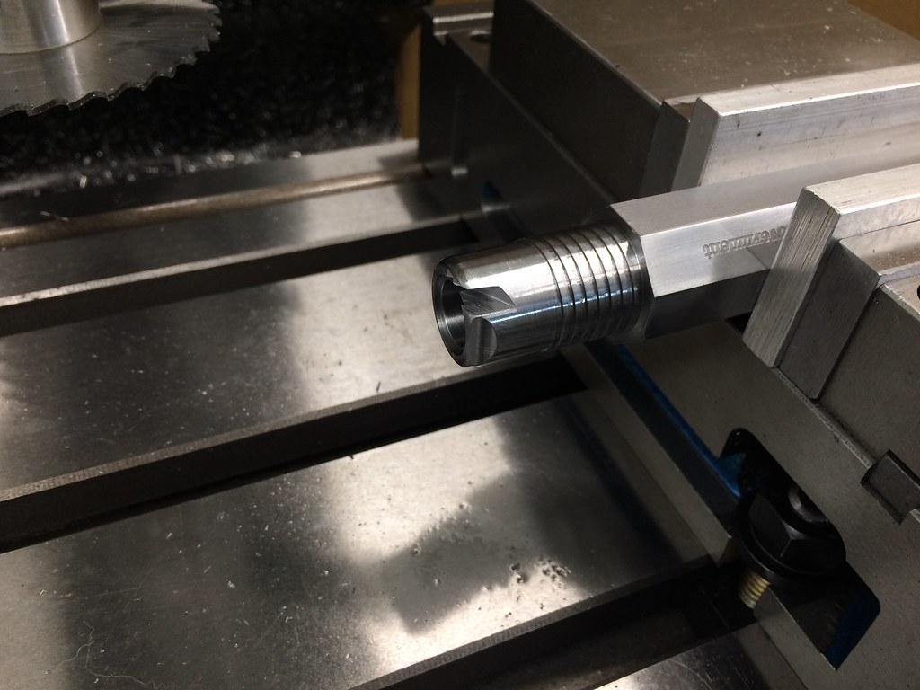

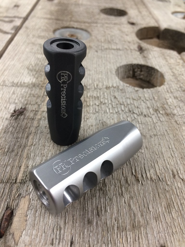

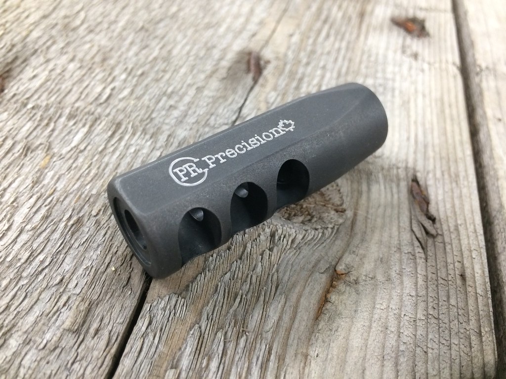

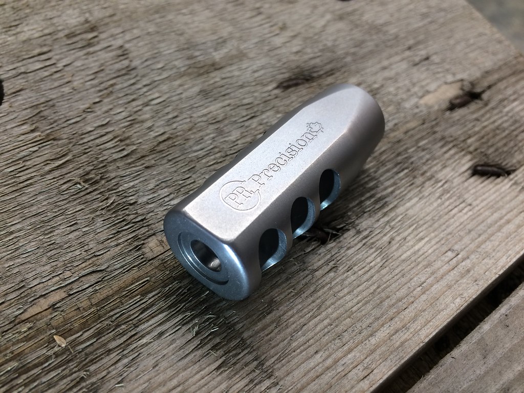

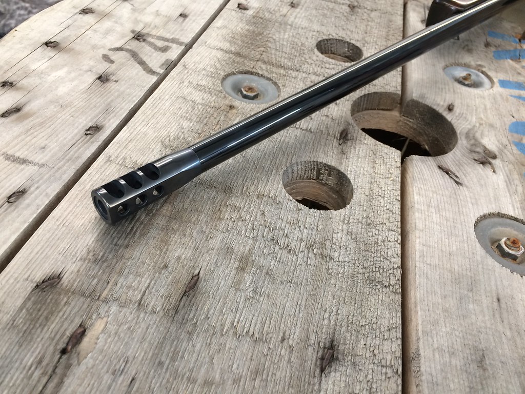

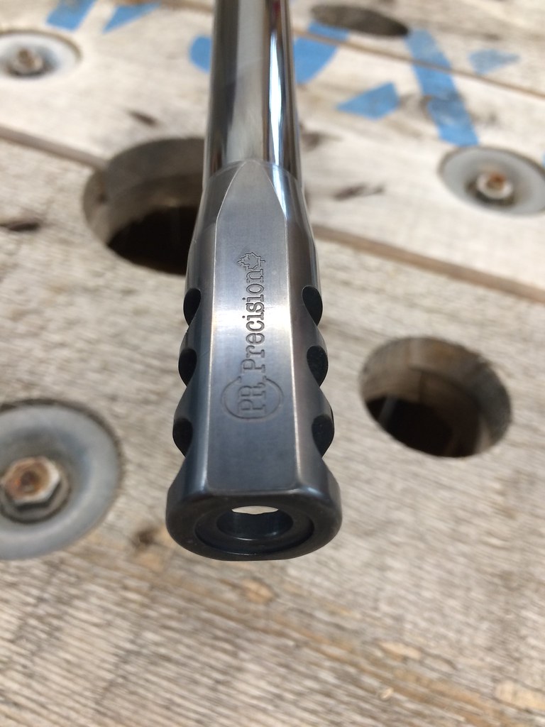

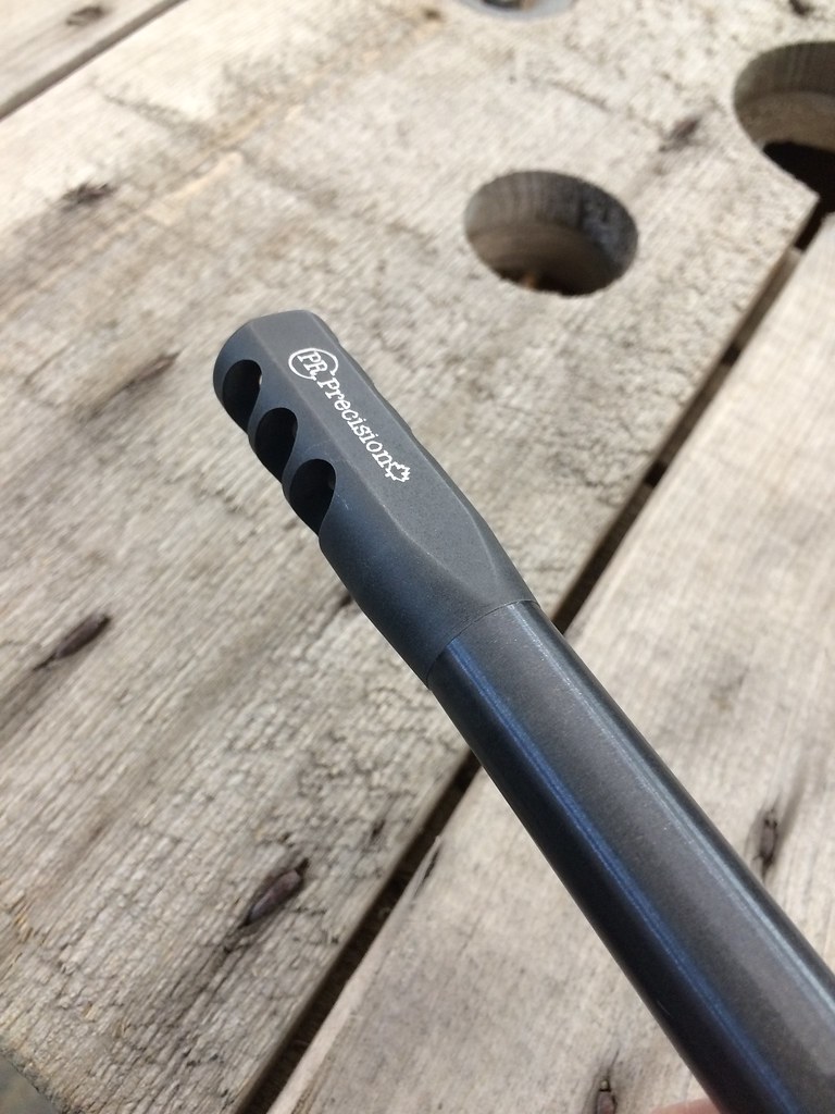

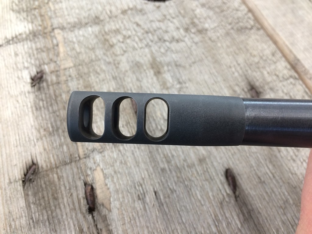

Shop update: I'm offering a new line of muzzle brake!
There are a million brake designs out there and I have no desire to to re-invent the wheel. However I've kept running into customers looking to brake their hunter weight rifle with something that is built straight, bored true, has no sharp edges/burrs and tries to maintain some level of elegance while remaining highly effective.
I'm making these available on a built to order basis with full options on material, contour, thread size and finish.
The goal here is to offer something that is low-profile and yet highly effective.
This is one mounted on a tikka with a .63" muzzle diameter. Thread in this case is 9/16x32tpi but can be threaded to customer spec.
If this sounds like something you're interested in, let me know!
Paul

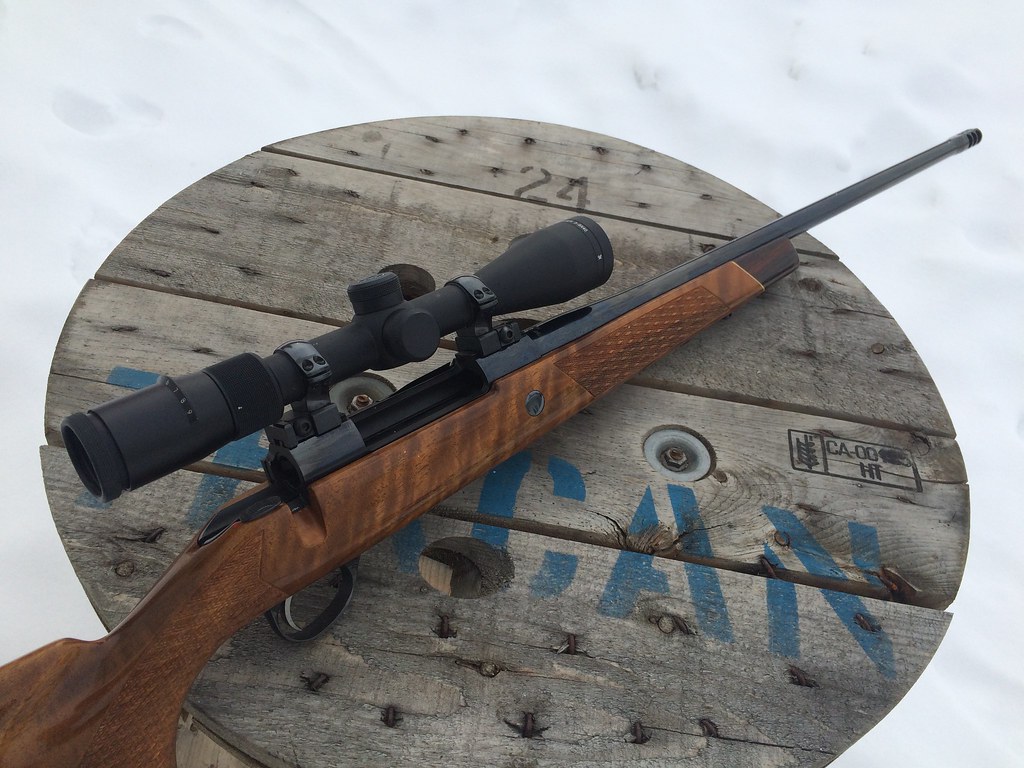

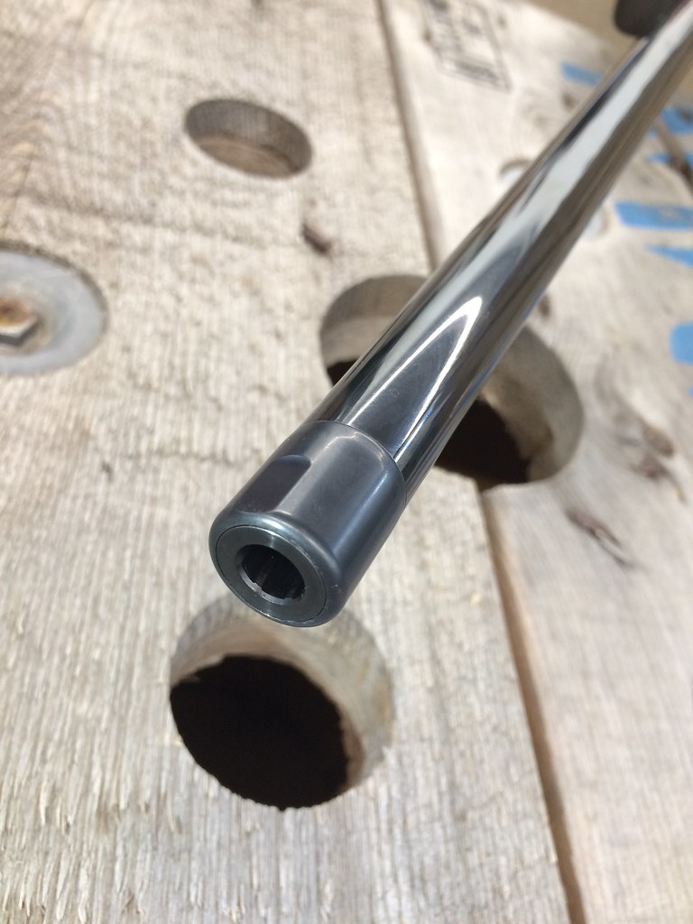

This week I did a muzzle brake for a kindly gentleman in his 70s.
He contacted me, saying he is determined to hunt for another 10years but that his (gorgeously mint) Sako AIII in 30-06 is getting "a little rowdy to shoot off the bench". Could I thread the muzzle and supply a gill brake that would be classy and wouldn't look too out of place on his Sako, along with a matching thread protector? His desire is to thread on the brake for sighting in and then remove it to save his ears while hunting.
A witness mark for timing and anti-seize in place of loctite, he should be good to go...
I flared the OD of the protector as discretely as possible while providing just enough meat for a couple flats...
did I mention this rifle is MINT??

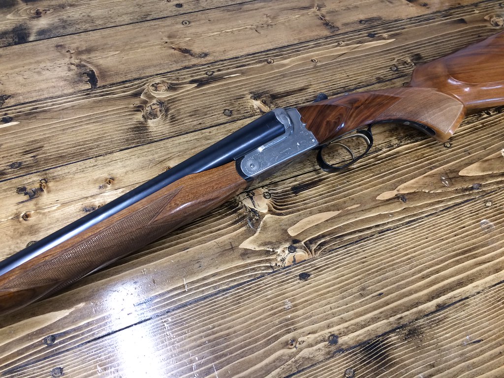

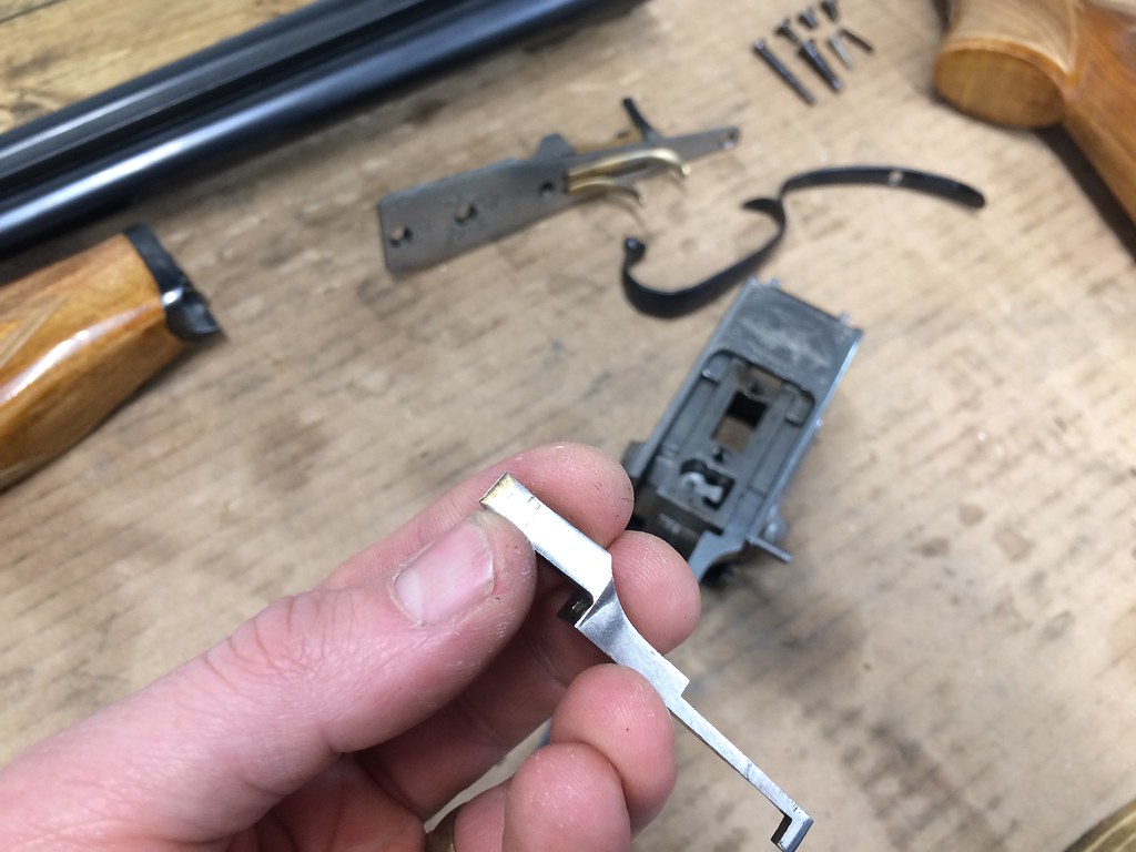

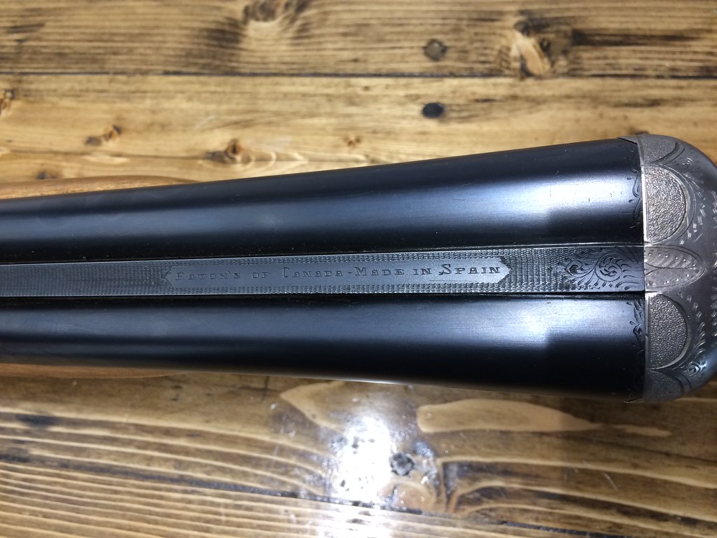

I also did a small repair job to this "Eatons" SxS.
The right hand barrel wasn't firing. Disassembly showed a small bur on that sear, causing it to ride over the notch in the hammer and fail to ####.
Not a high end gun, but its back on the road.

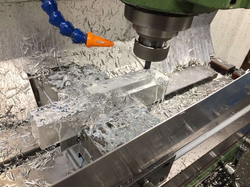

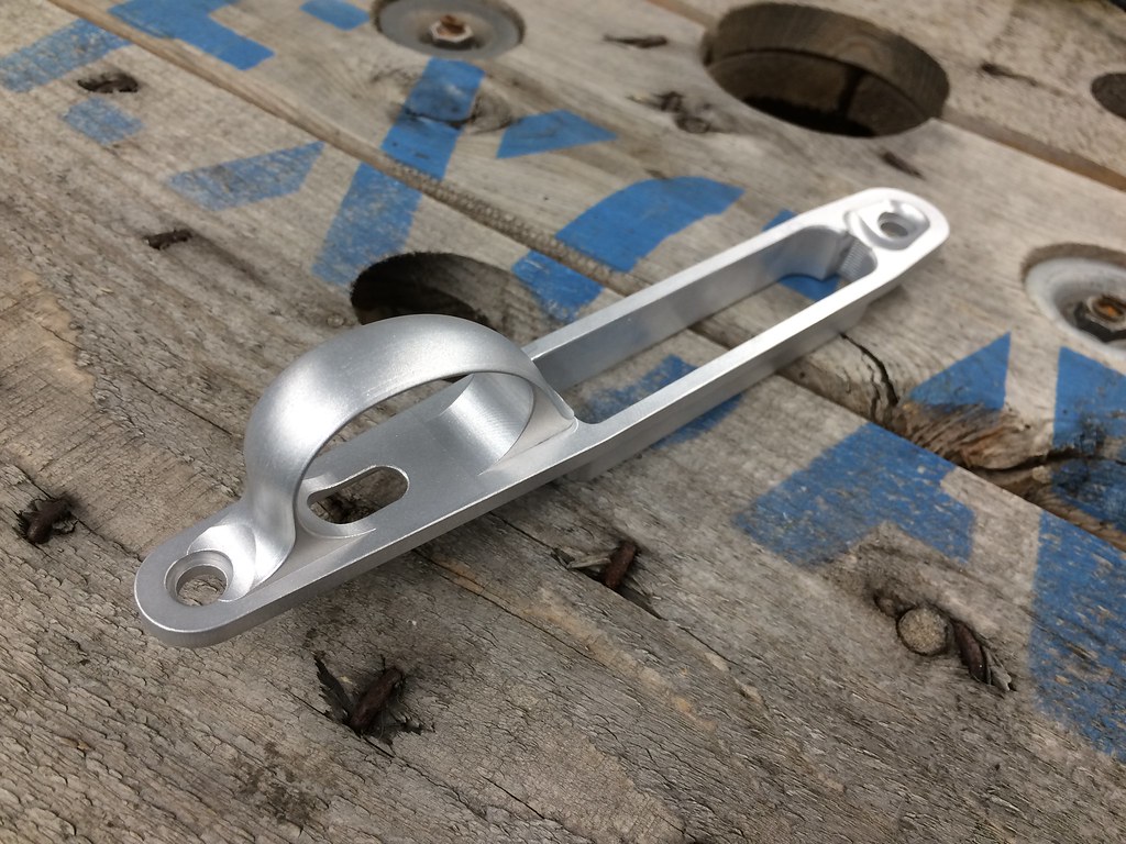

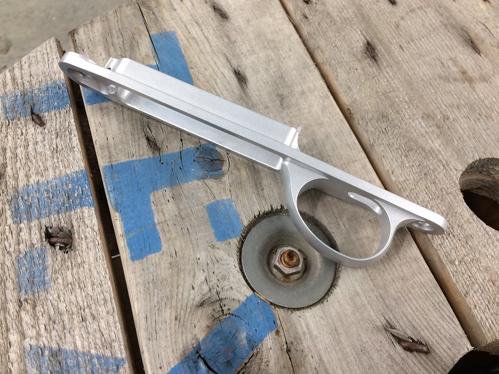

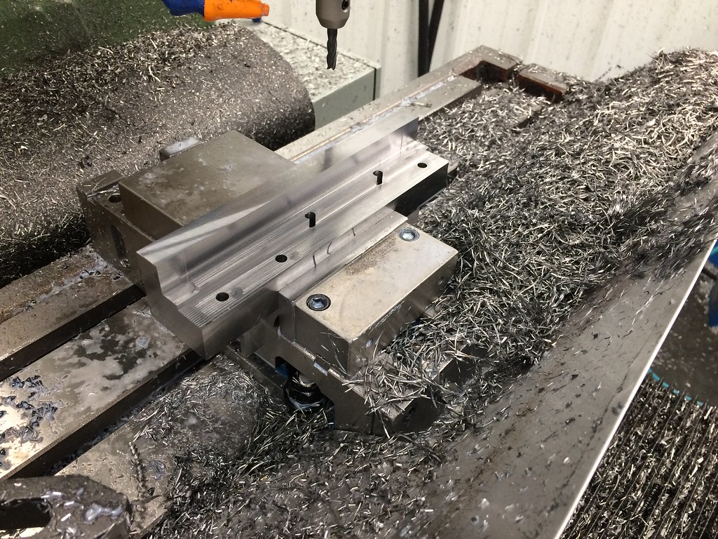

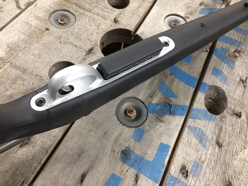

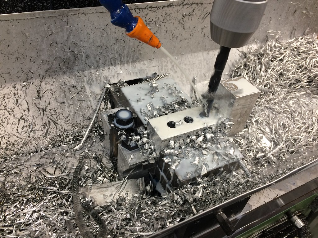

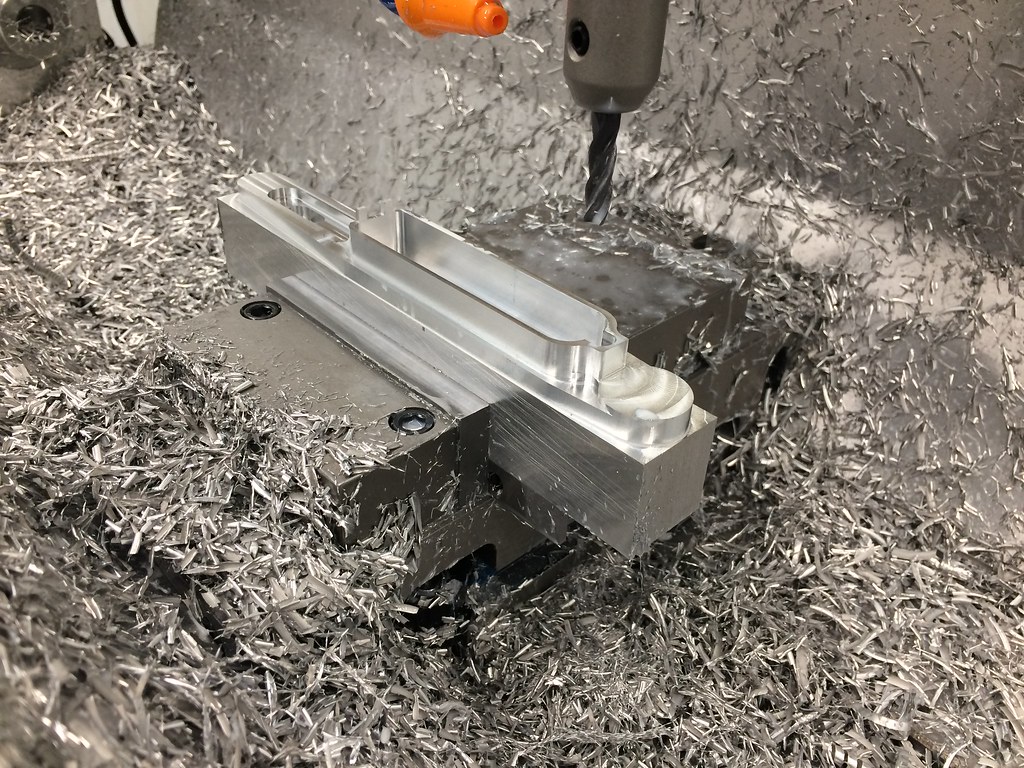

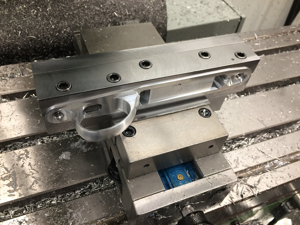

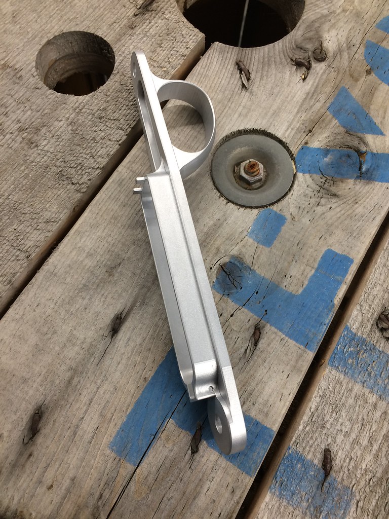

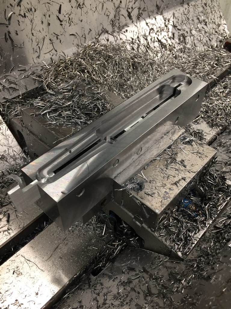

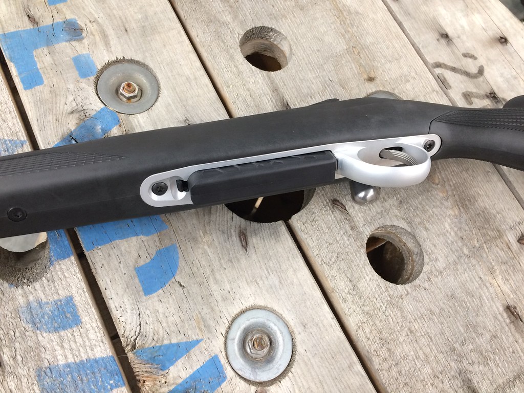

In other news, I've been working on a bottom metal project for a Tikka. Four Tikkas actually...
This customer has a fleet of stainless Tikkas and feels that a stainless hunting rifle deserves stainless bottom metal with smooth rounded off lines to match.

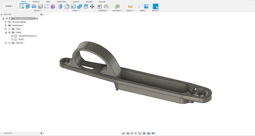

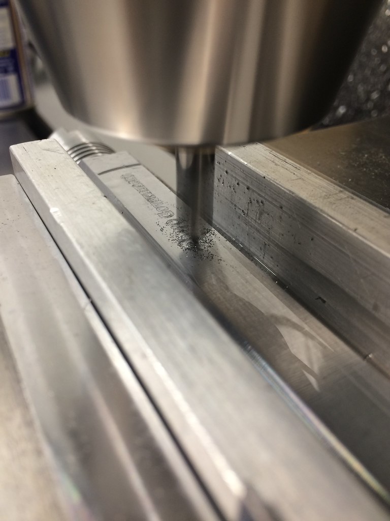

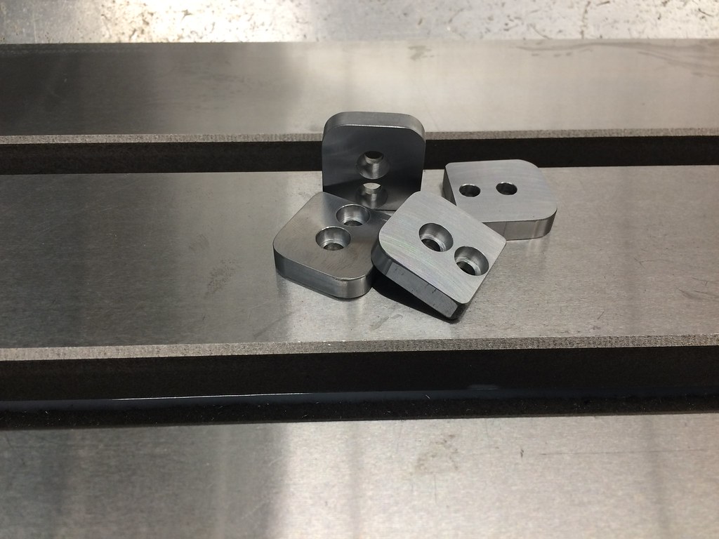

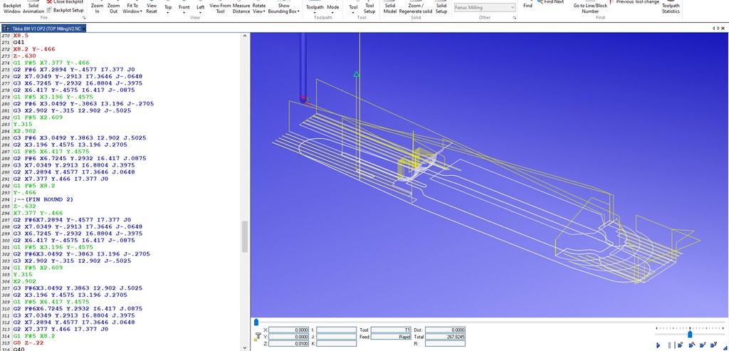

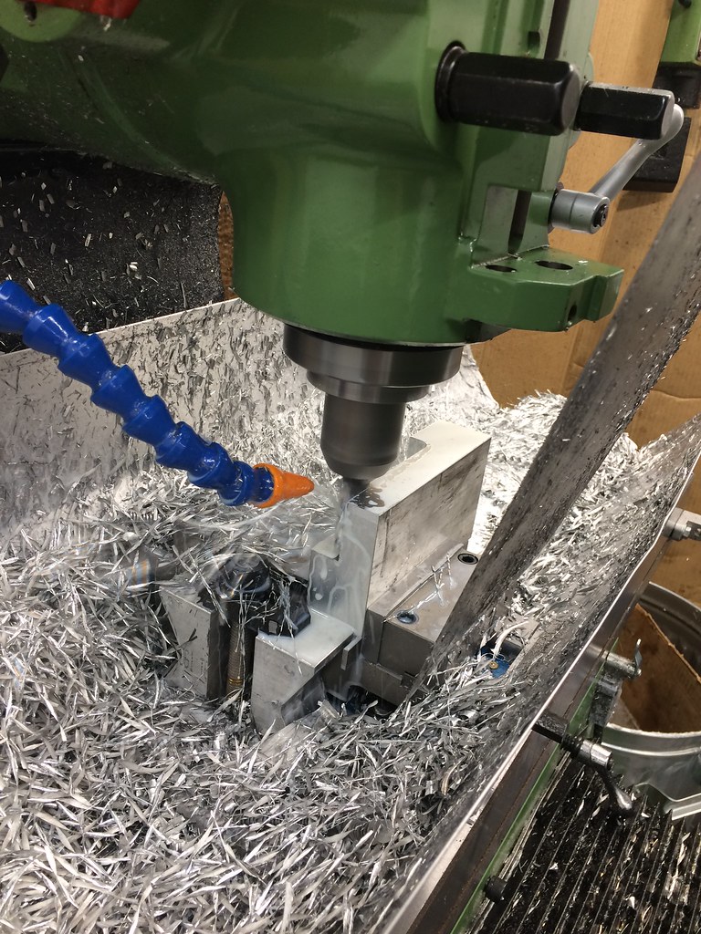

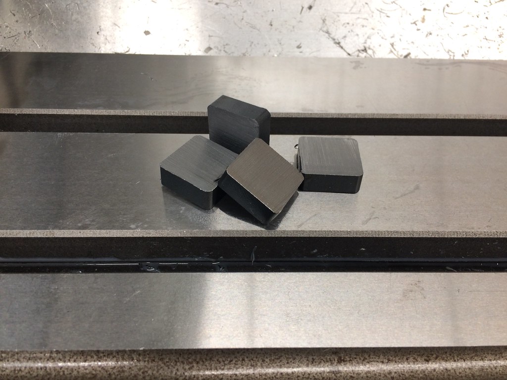

First step: make a model based off the sample...
Then start writing code...

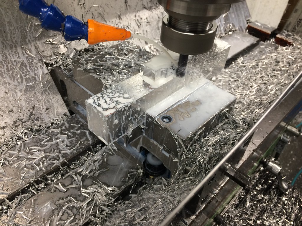

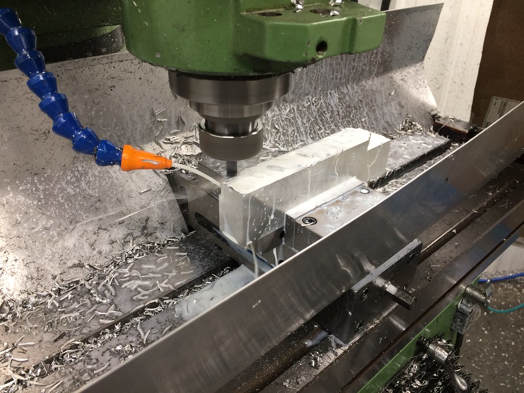

I'm starting with an aluminum test piece as its much cheaper material and is easier on tooling.
OP1 done.

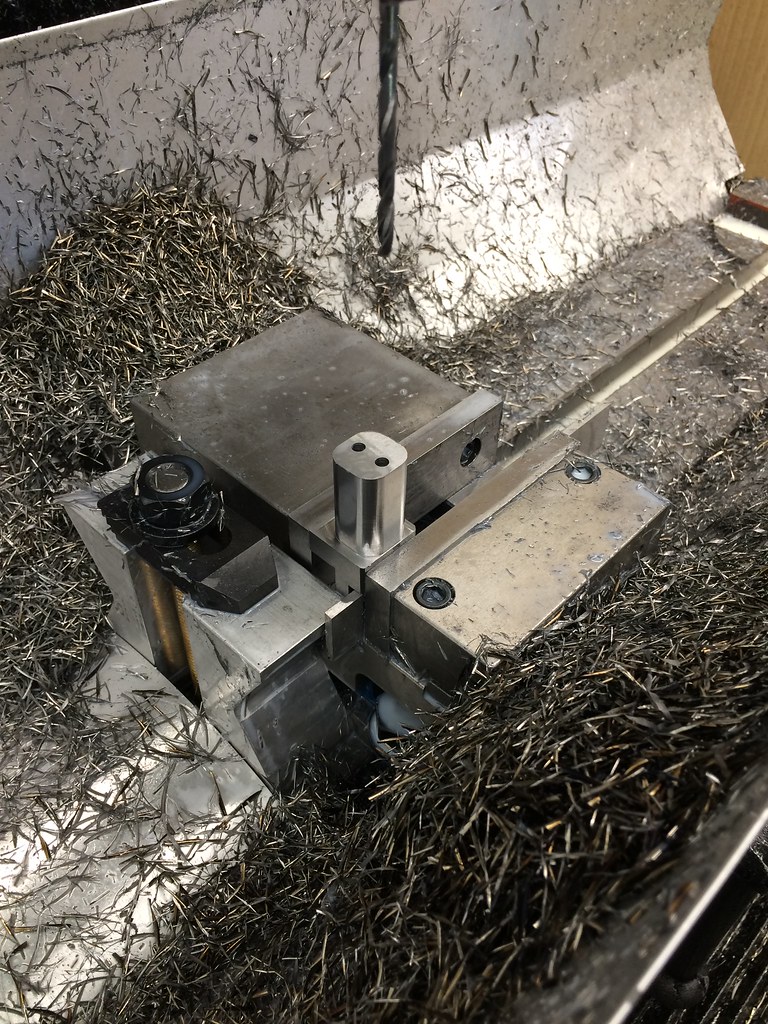

Now to make a fixture for OP2 and 3
I'm sorry but, I love this stuff!!
Ready to deburr!
There's more tool marks than I'd like if it was the real thing but for a test piece, things are looking good!
I apologize, these aren't great pictures but they should give an idea...

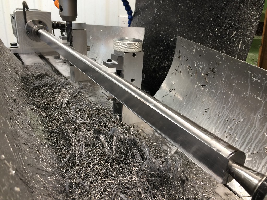

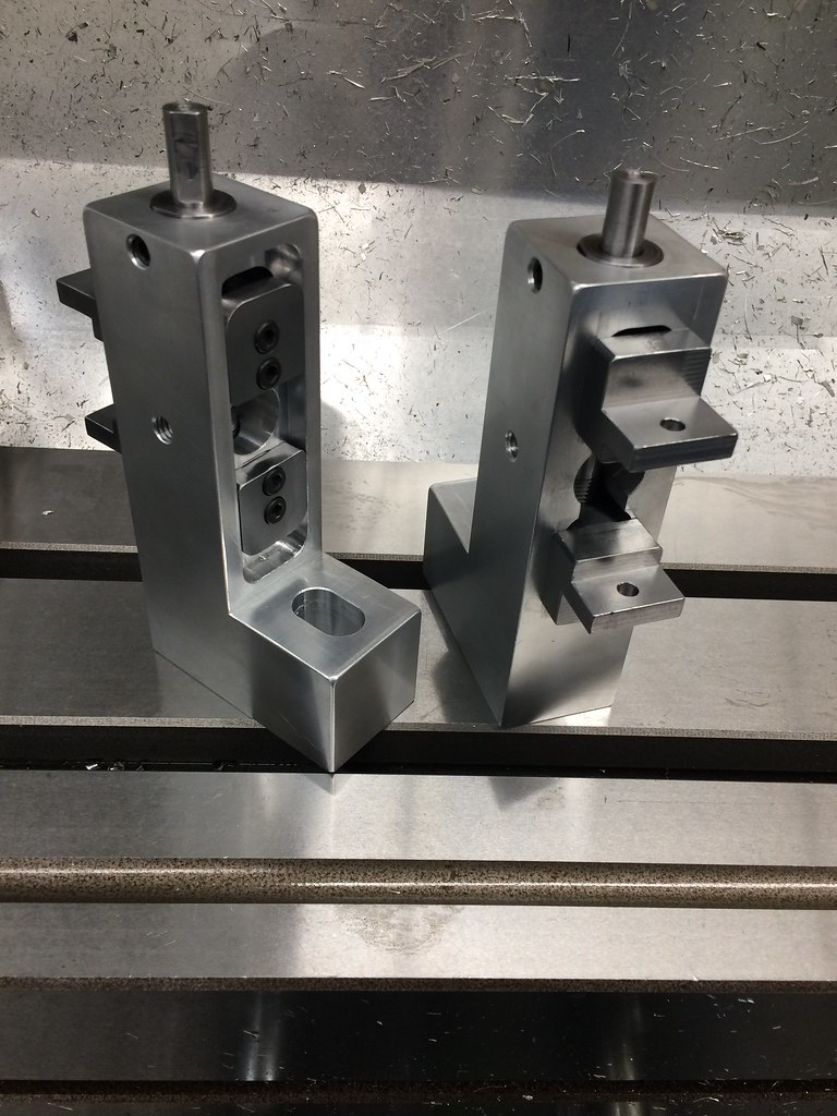

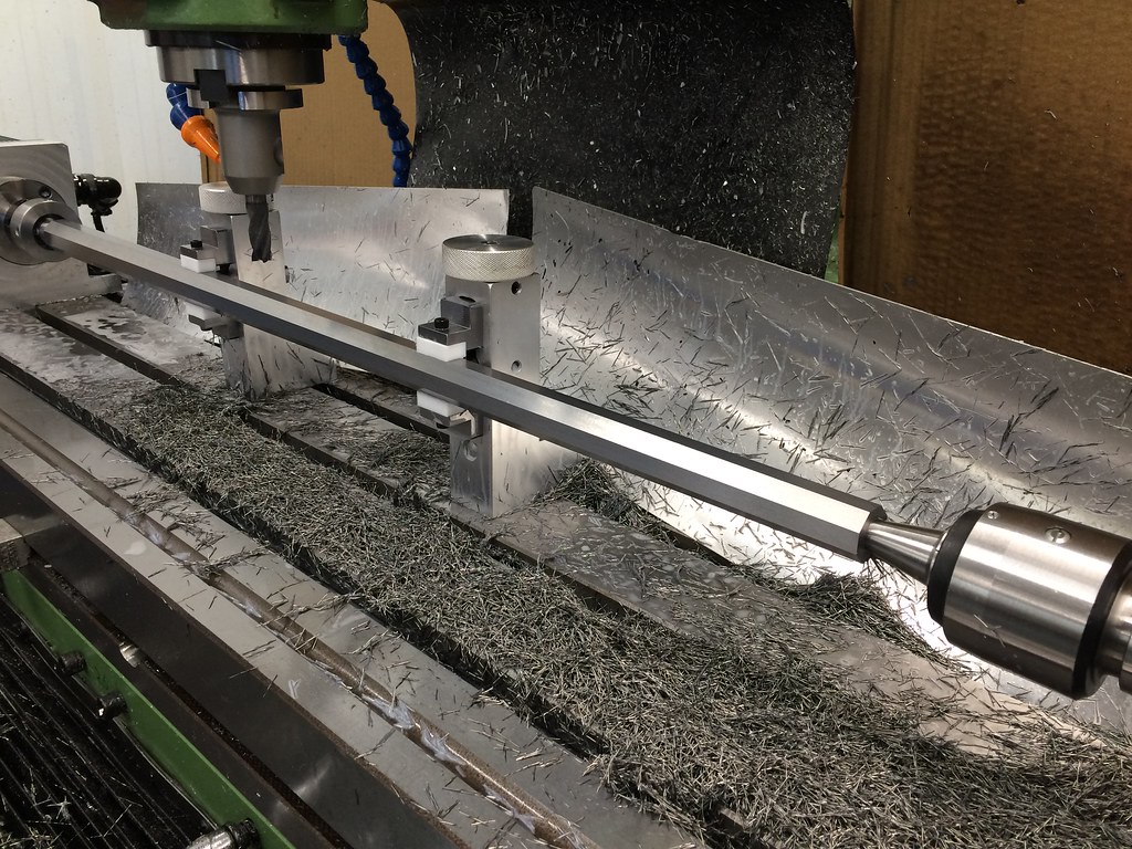

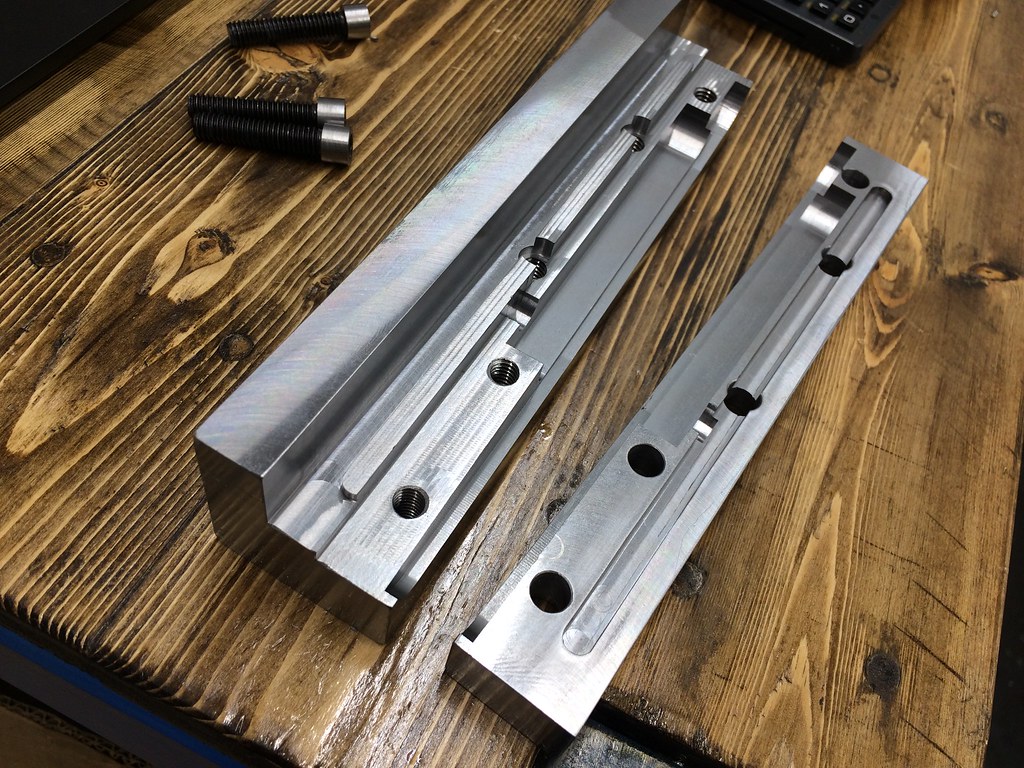

About the only picture worthy project I did was making some new "barrel steady rests" for some particularly long barrel milling projects I've got coming up...
Still a few components to go but here they are assembled to this point.
More to follow.

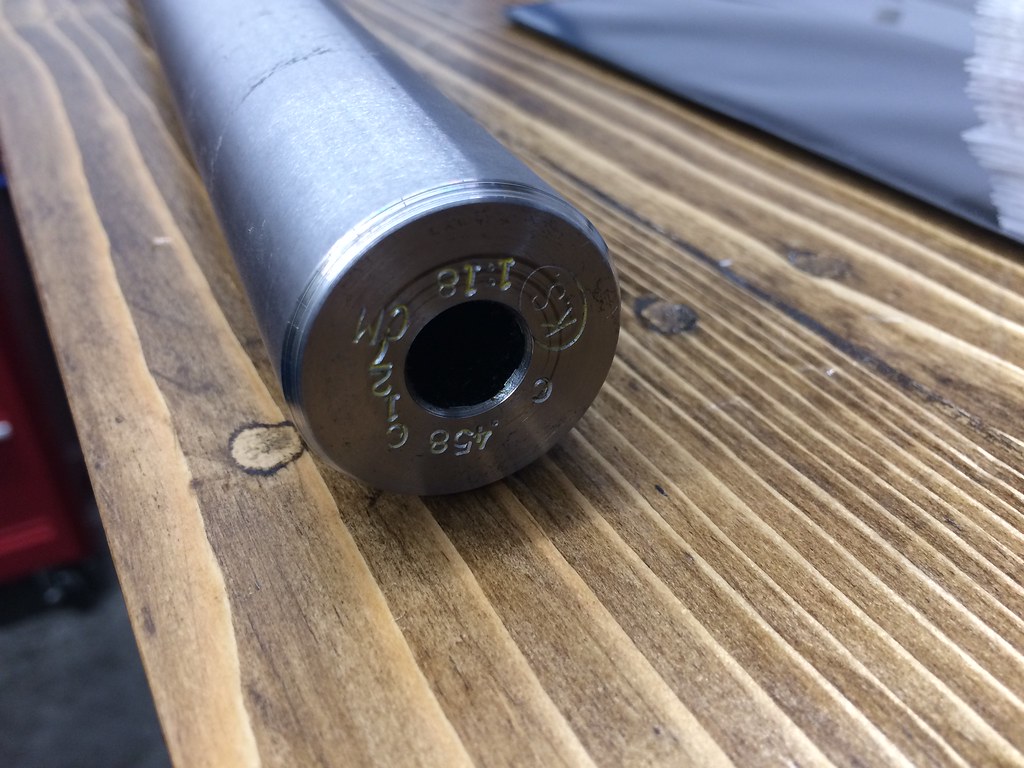

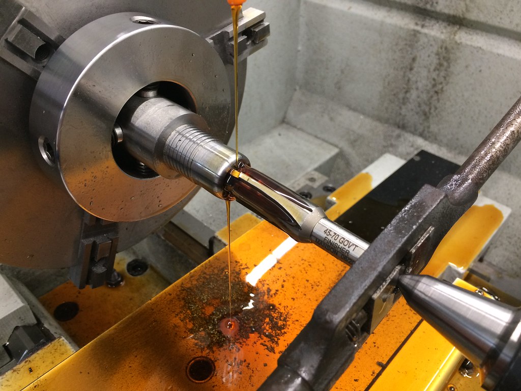

Alright I got these steadies finished up just in time, the first slated job for them showed up the very next day!

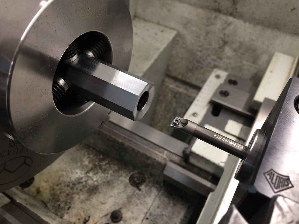

KS barrel blank, .458"bore to finish at 32"OL...

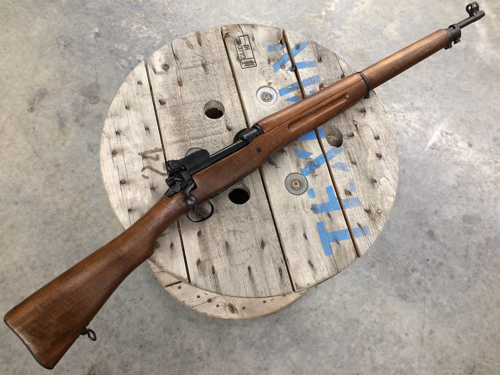

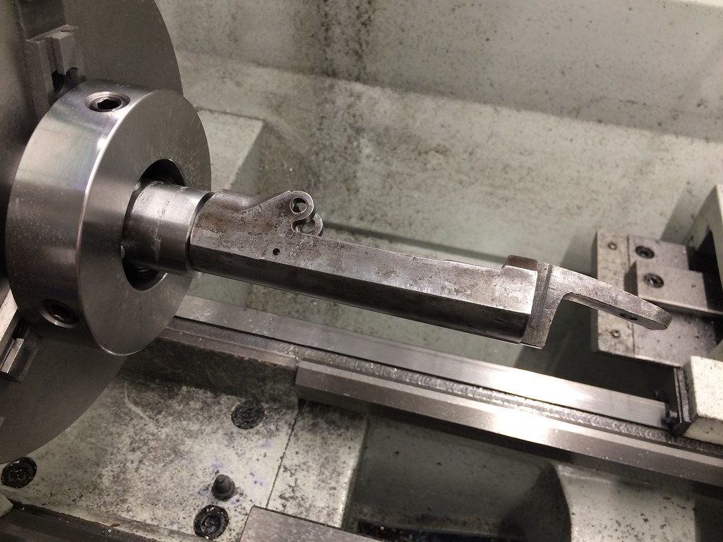

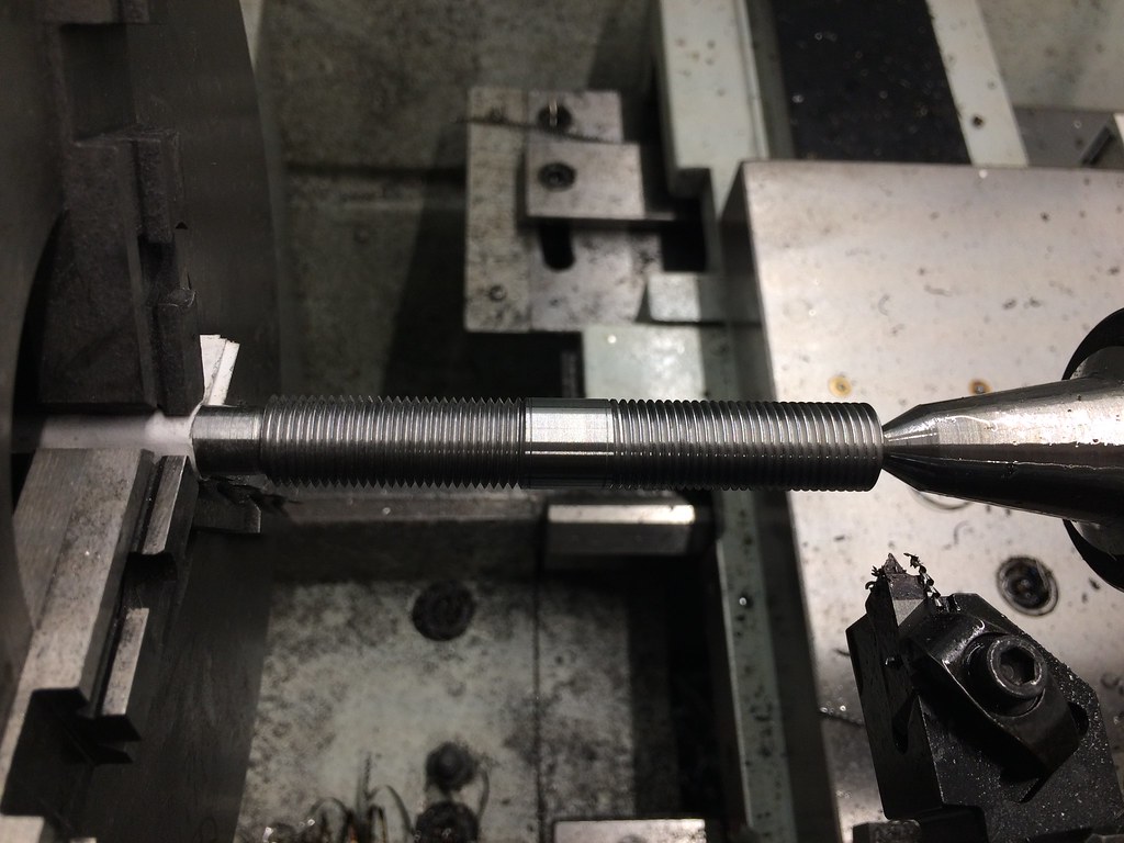

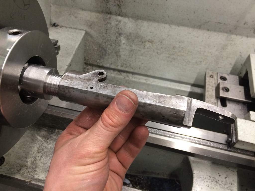

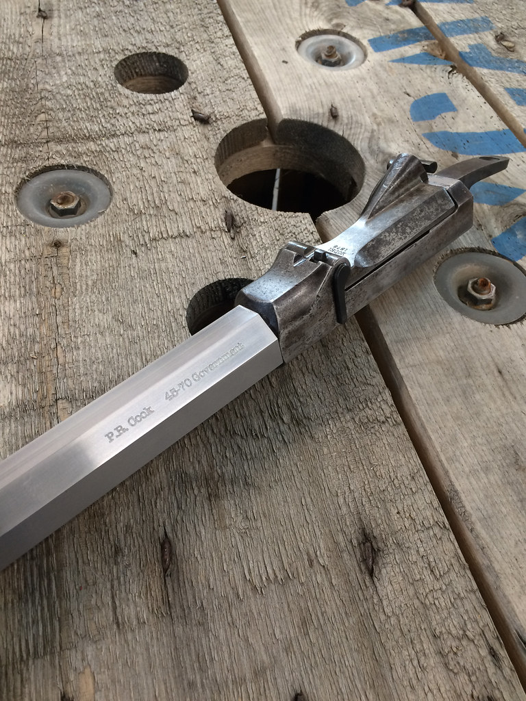

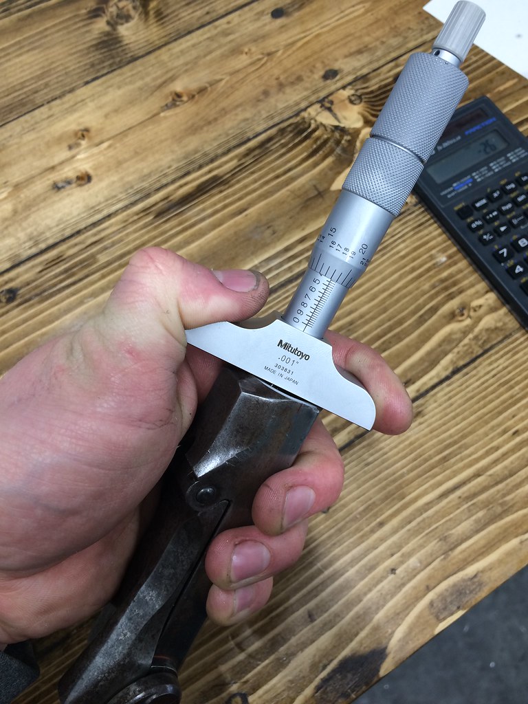

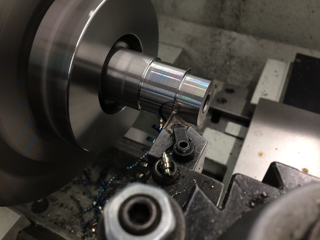

Taking some measurements on this 1878 Springfield Trapdoor receiver...
IMG_1041 by PRCook, on Flickr

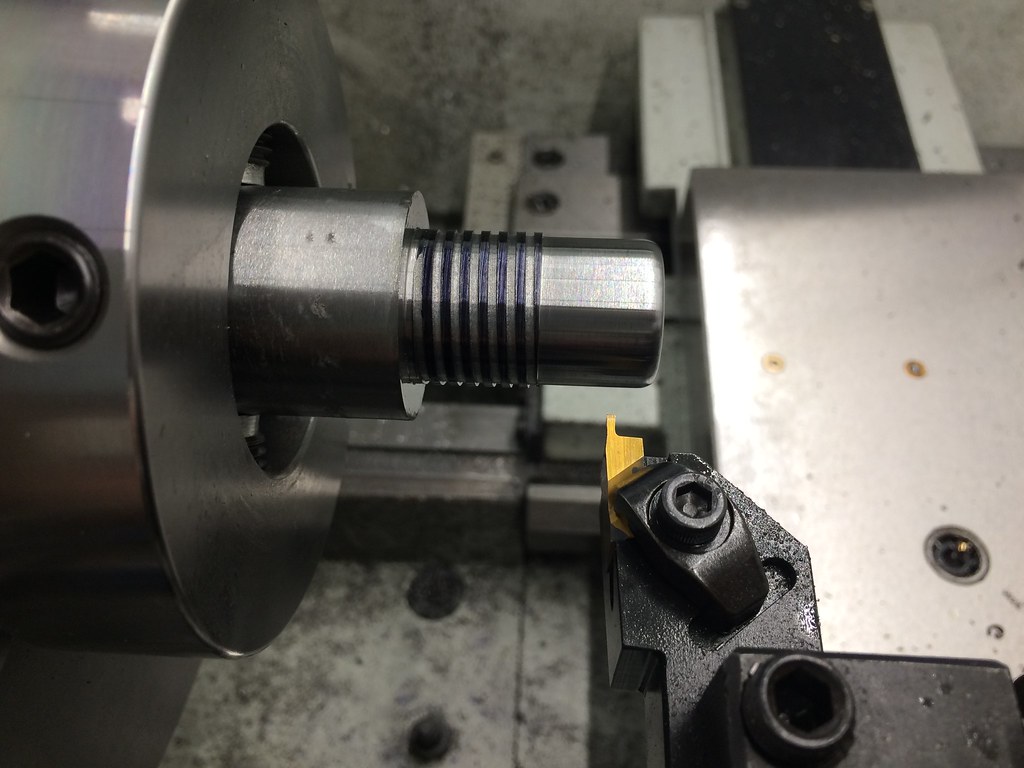

To the lathe...
These actions require a square thread form. Not a huge deal, but it requires a slightly different approach than a V thread and a modified grooving insert.
Test fit...
Good to go!
A classic 45-70 chambering...
And now... Octagon contouring.
I am pleased to report, these barrel steadies worked a treat!
A bit of engraving...
And some extractor/hinge cuts...
And finally, cutting/crowning the muzzle.
All buttoned up, ready to ship!
This is for a well known gentleman here on the forum, I'll let him chime in if he so desires, sufficive to say; I look forward to seeing where he takes it from here!
