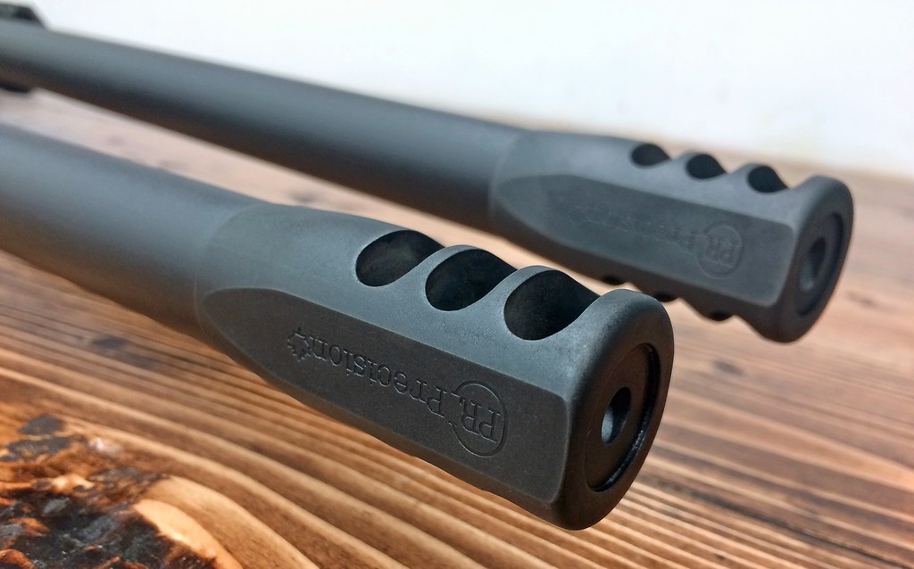

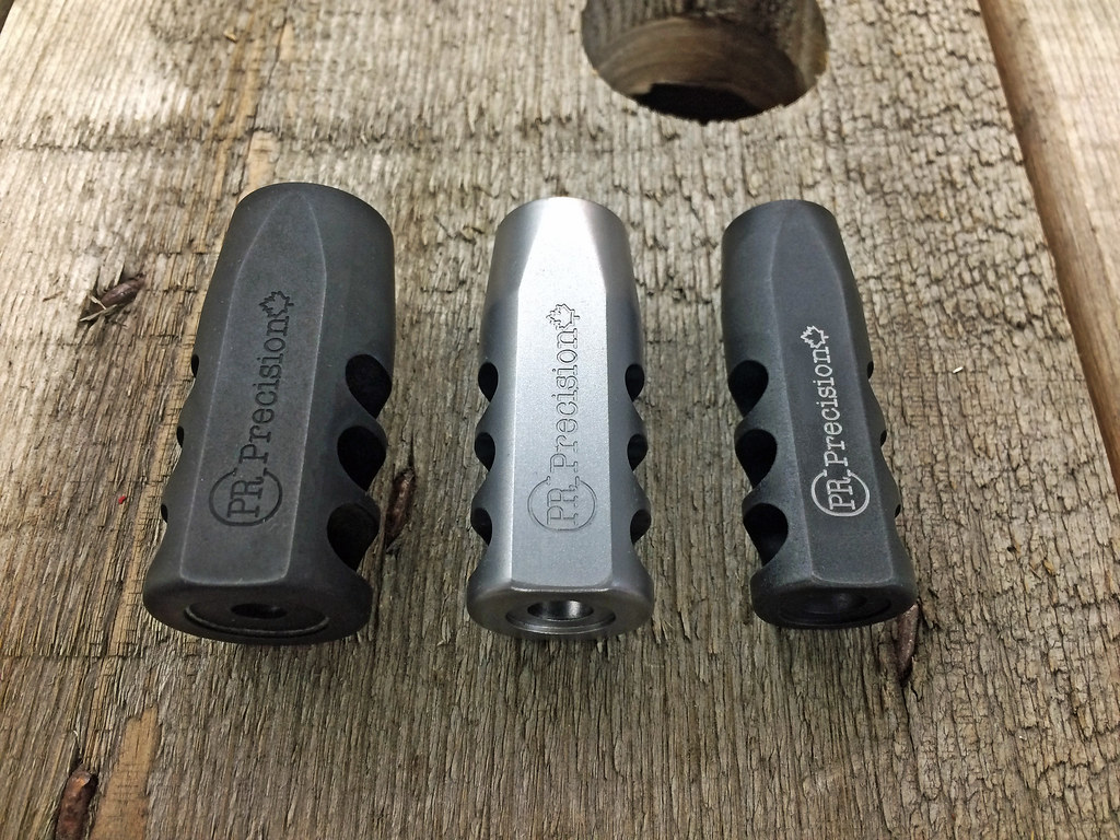

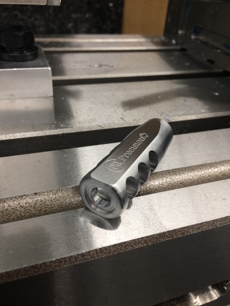

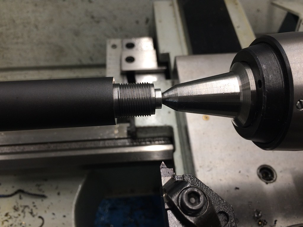

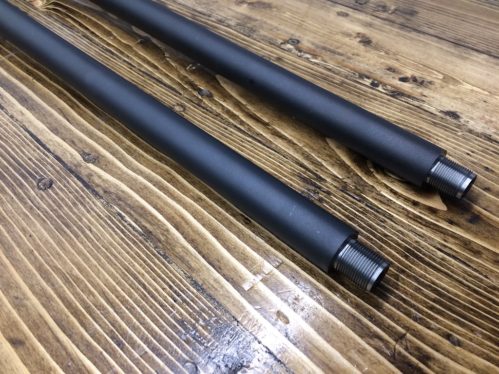

I did a few more muzzle brakes this past week.
It seems there is a market for precisely made, effective, low profile brakes that are custom made to a customer's specific rifle.
Small medium and large templates, fully customizable from there!
"Twins" granted a .223 and .308.

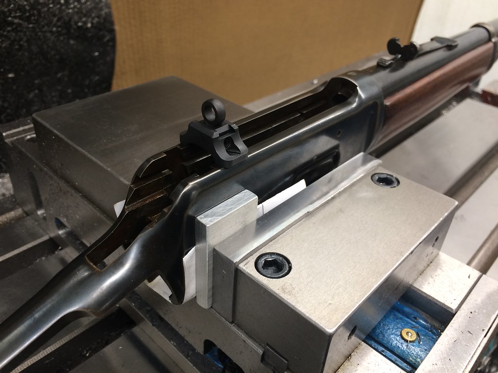

Here is a post 64 winnie94 I installed a ghost sight on last week. It's basic smith work but it fills in the cracks!

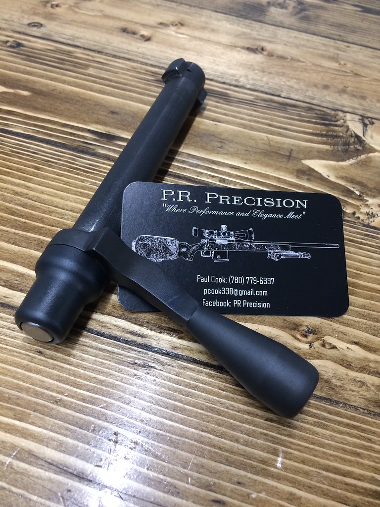

Here is a Rem700 bolt handle I thread milled for an over size knob...
The beauty of threadmilling is that the old knob becomes the new thread making for a very strong and accurately aligned handle.

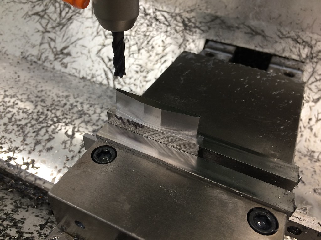

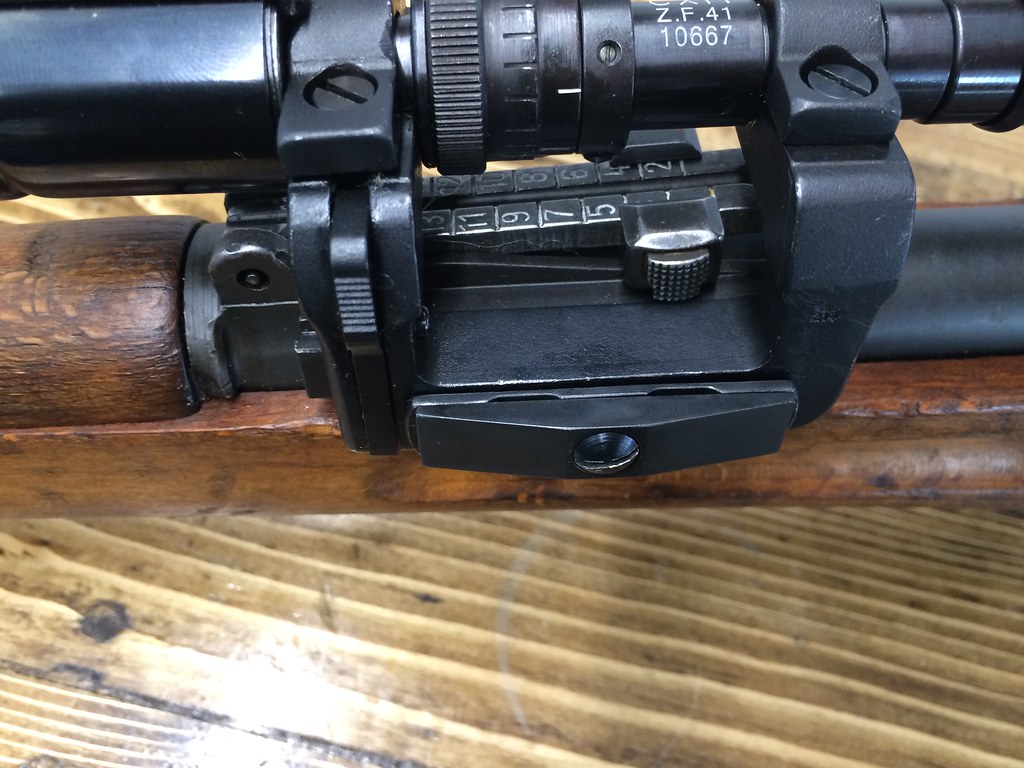

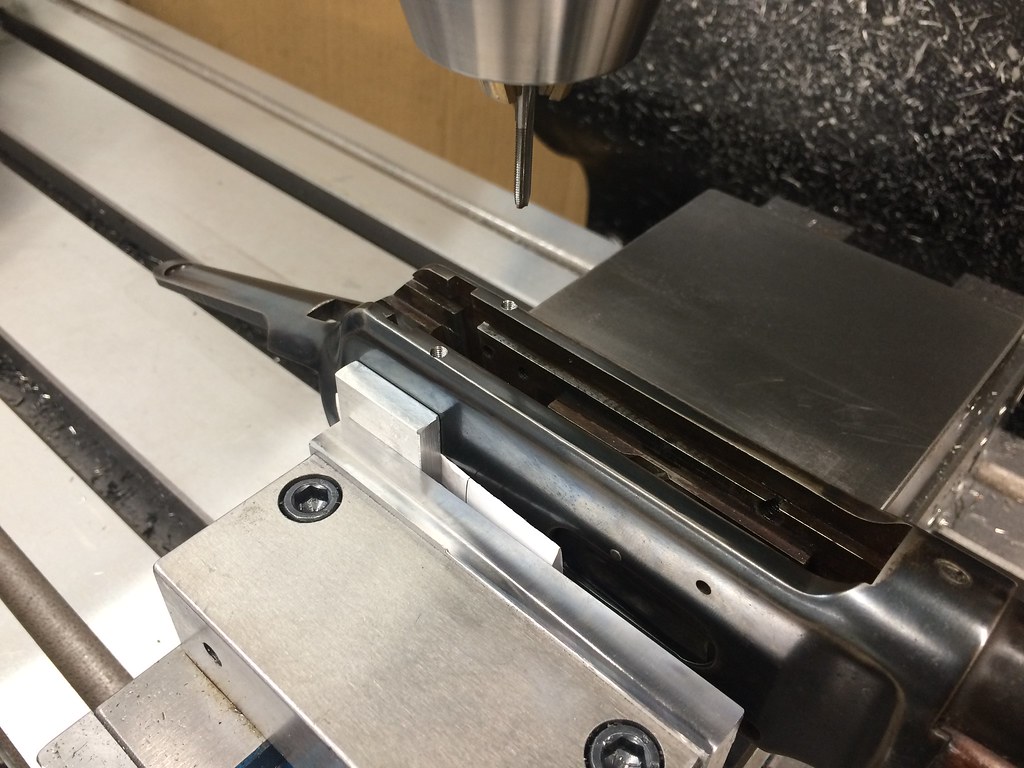

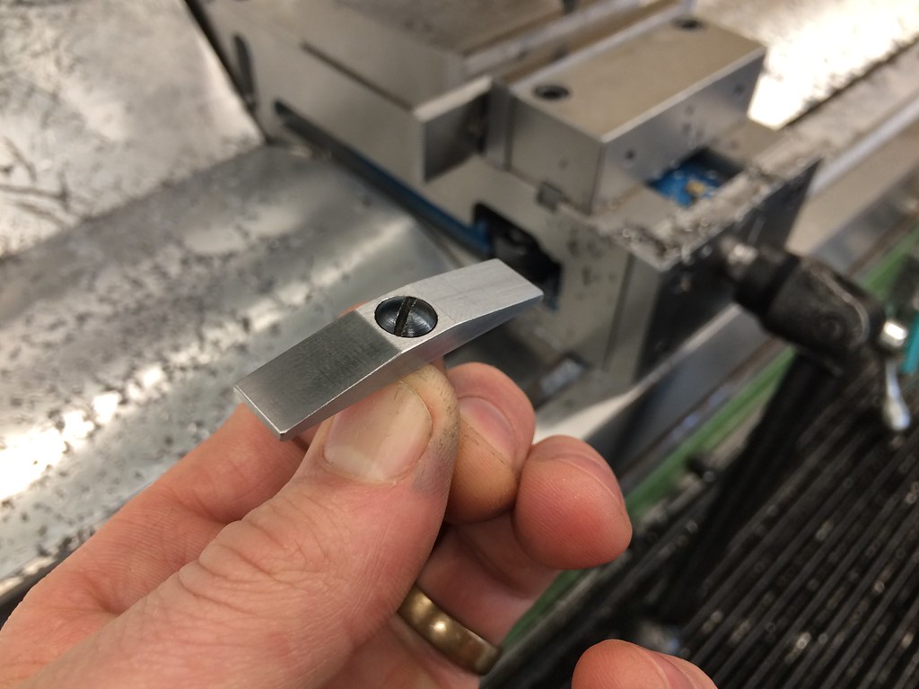

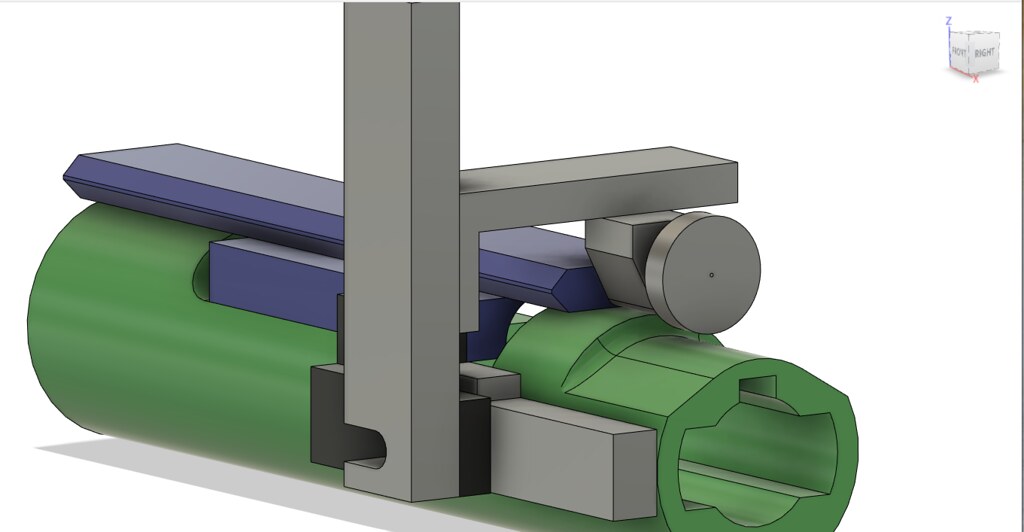

And finally, I had a customer with a repro ZF41 scope mount (on a shooter rifle) that wouldn't lock up tight. My budget friendly solution was to make a "top clamp" to reinforce the roller spring.
Making it out of 4140 allowed it to be low profile without bending or flexing.
He'll need a screw driver to mount/dismount the scope now but at least it locks up solid...

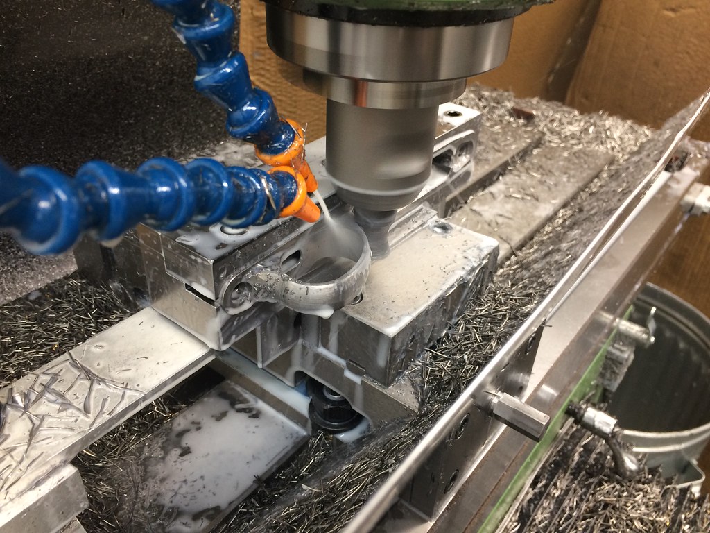

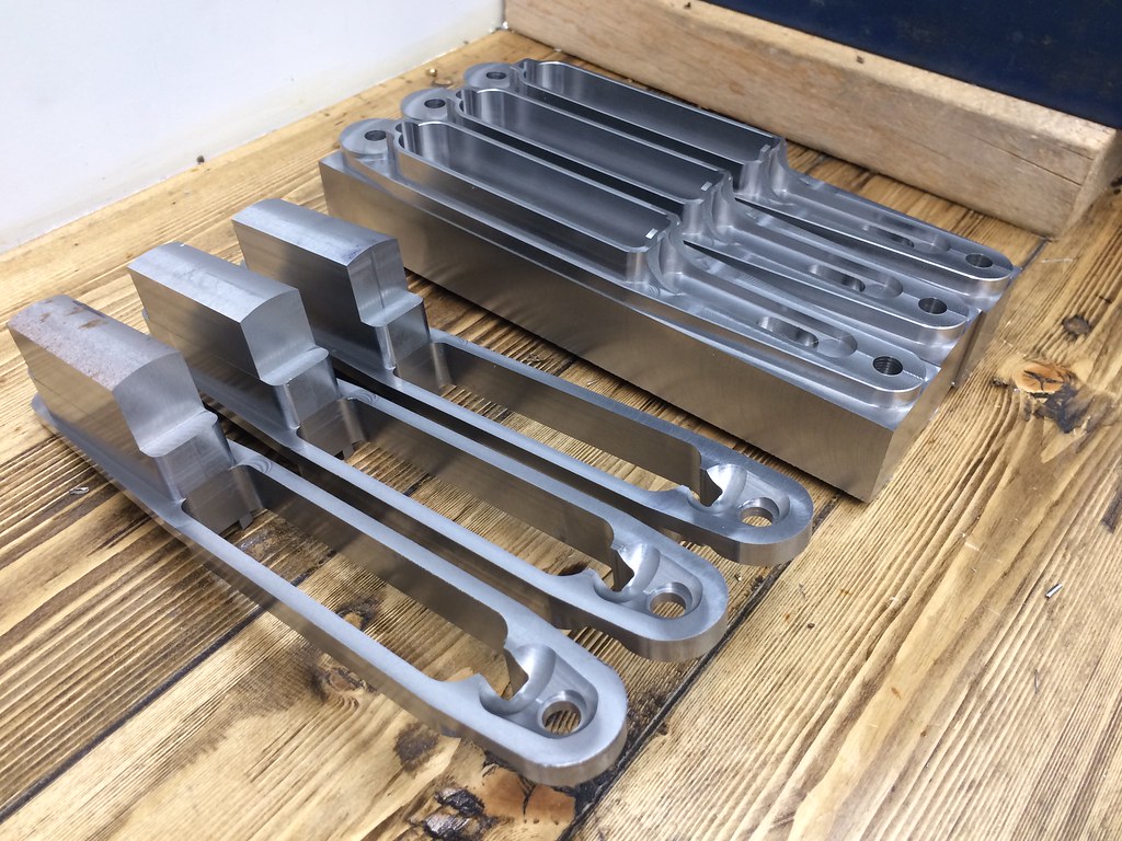

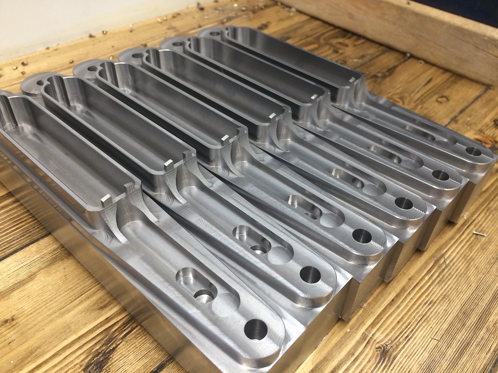

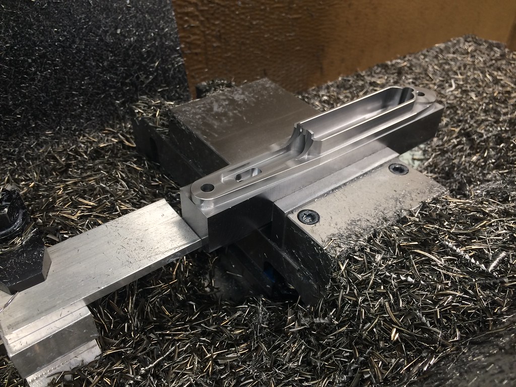

I'm currently setting up to make a run of stainless steel, Tikka bottom metal. If anyone is interested in being added to the list, let me know!

Thanks RJ. I certainly could make self timing brakes if there is interest. My feelings have been that those are already widely available on the target/tactical market with a lot of "brand recognition" in place making it a difficult market to break into. I chose to design my current brakes to fill, what I perceive, as a gap in the market. Namely: a highly effective, low profile brake that is built and bored precisely and true, that is aesthetically pleasing with no sharp edges or burrs and is primarily intended for use on a lightweight hunting rifle.
I'd be happily proven wrong however and would certainly entertain adding such product offerings!

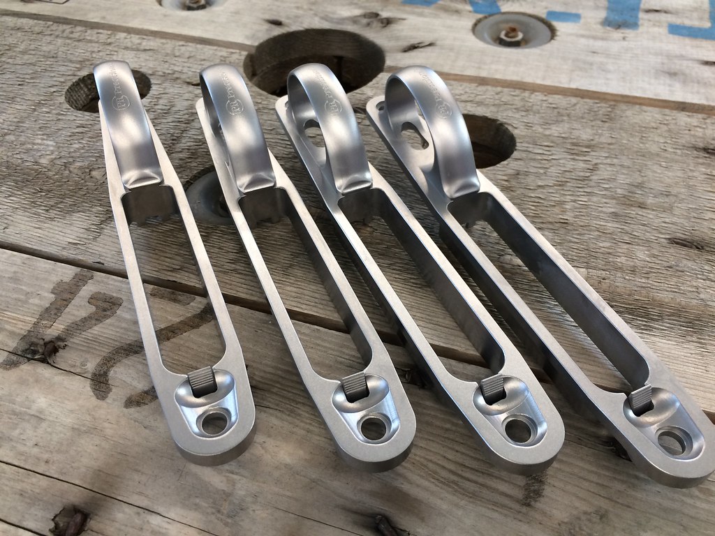

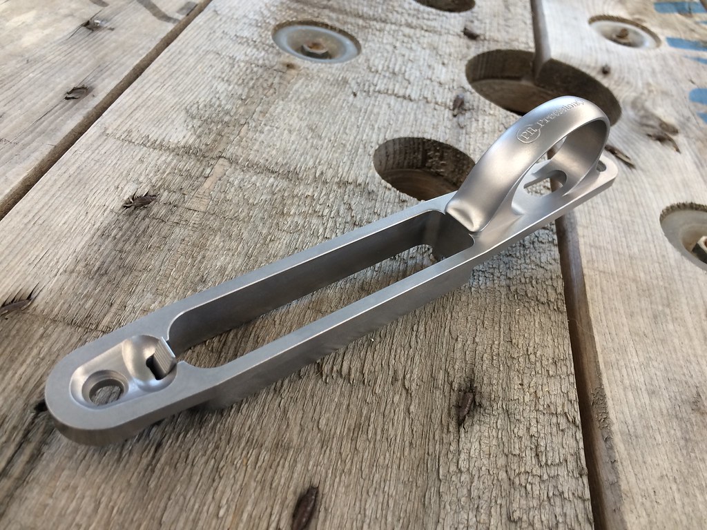

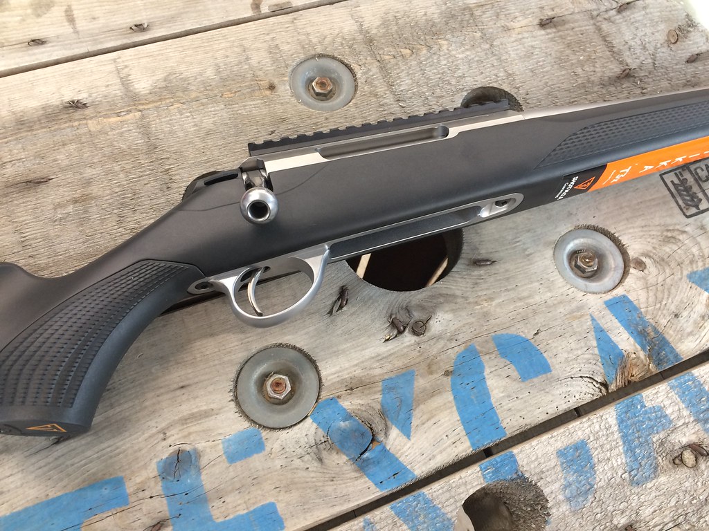

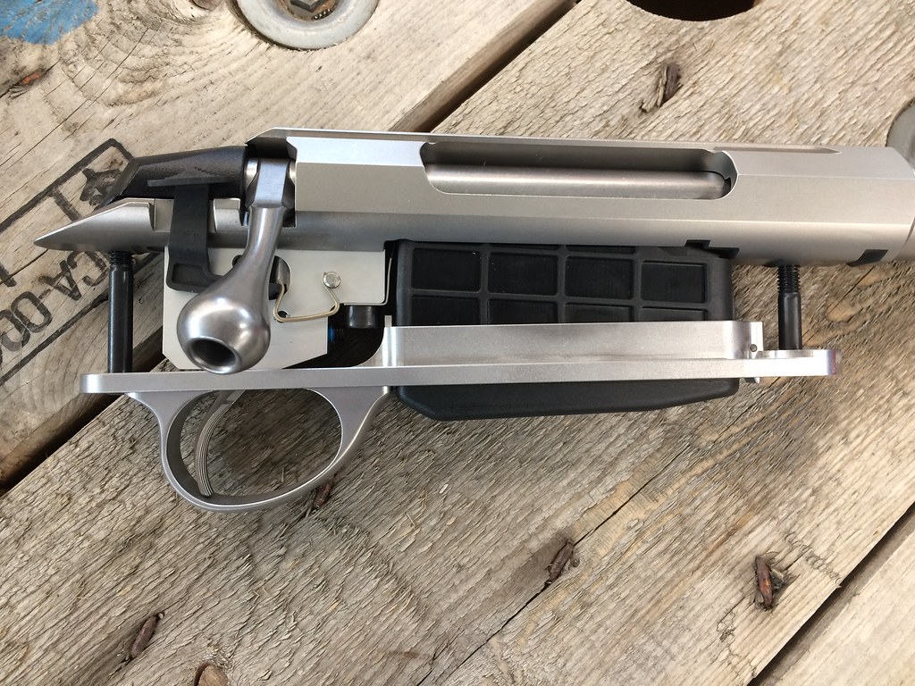

I'm just de-burring and cleaning up this run of T3 metal. Not gonna lie, its looking pretty slick...
How it "should have" from factory!
I've got a couple extra available from this run if anyone so desires.

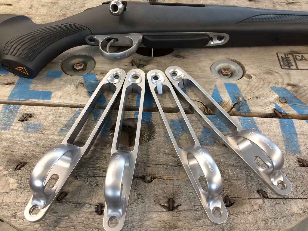

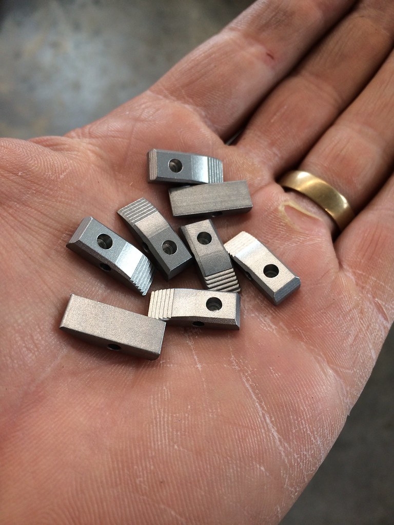

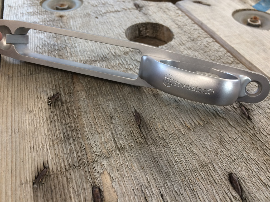

Some times its the little things... I spent an entire day this week designing and making these stainless latches. Fiddly little critters, but they're they complete the product!
Ready to roll...
I've still have a couple available from this batch, the others shipped out this week.
I've got a few more projects in the works at the moment. I am very pleased to report, the shop seems to be steadily getting busier!
Update: I've had quite a lot of interest on these bottom metal sets but few takers. Price by volume is a very real thing (especially where purchasing raw materials is concerned). Making these 5-10 at a time doesn't appear to be financially feasible on the customer end of things so I've re-crunched my numbers including larger quantity material supply options. I think, if I can get my numbers up, I can offer these at $250.
Call it a gamble, call it introductory pricing, lets give it a shot! CGN introductory pricing on these is $250+shipping.

Unsolicited marketing/branding advice:
1. Logo would look better if the maple leaf were to be distanced a hair from the company's name. Like 0.5 or 0.7 of a millimetre (over its current spacing).
2. Your business card should have the same fonts/branding as the logo.

Steyn: Noted. Things are moving pretty fast here, The card pictured is from the last batch. Current ones are up to date.

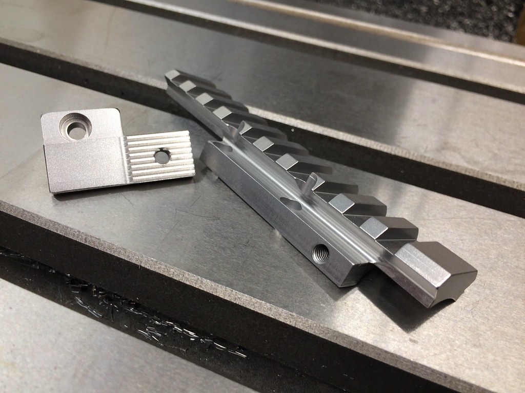

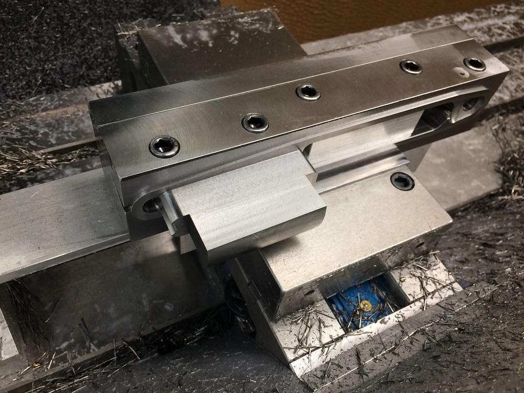

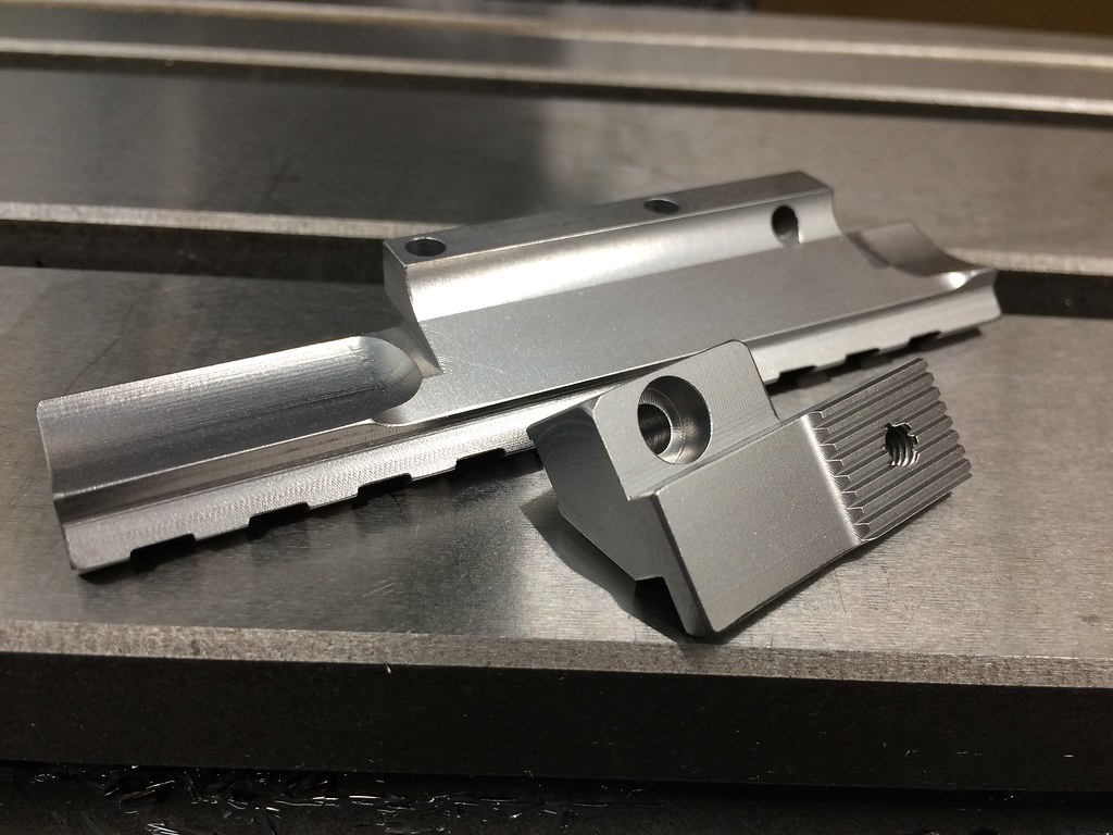

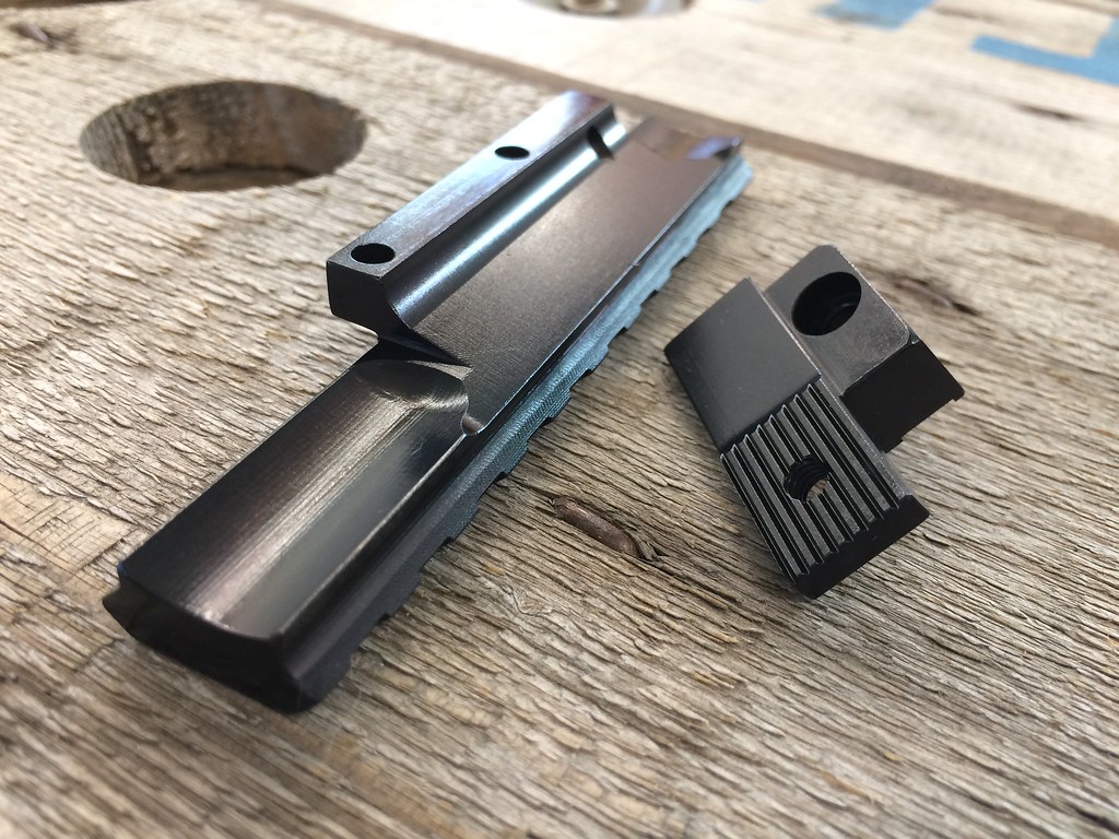

As to this week, Here's a combination picatinny rail and diopter sight mount I made for a Swedish target rifle...
This took a fair bit of design work to ensure everything would function and line up correctly without a costly trial and error process,
as well as to collaborate with the customer on what he envisioned.
Fine satin hot blued finish...mmmmmm
Should work a treat!

Nice custom rail, I am looking for a way to have a custom rail for my Miroku Win1892 44 mag.
