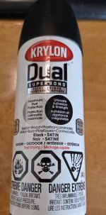

I have one rifle that my gunsmith did with Krylon, seems to stand up pretty good.

Cleaned well and sprayed with a clear protective top coat works!! It’s cheap and pretty durable plus it can be touched up when required.
Krylon camo paint from Crappy Tire. Tough stuff, paint my 4Runner and several toys. Holds up to rain, snow, sun for years !!
I have used this stuff on several older rifles, a M96 6.5x55 and a P14 .303, with at best 50% original blueing left. Seems to stand up pretty well and looks better than before, at least to me.
