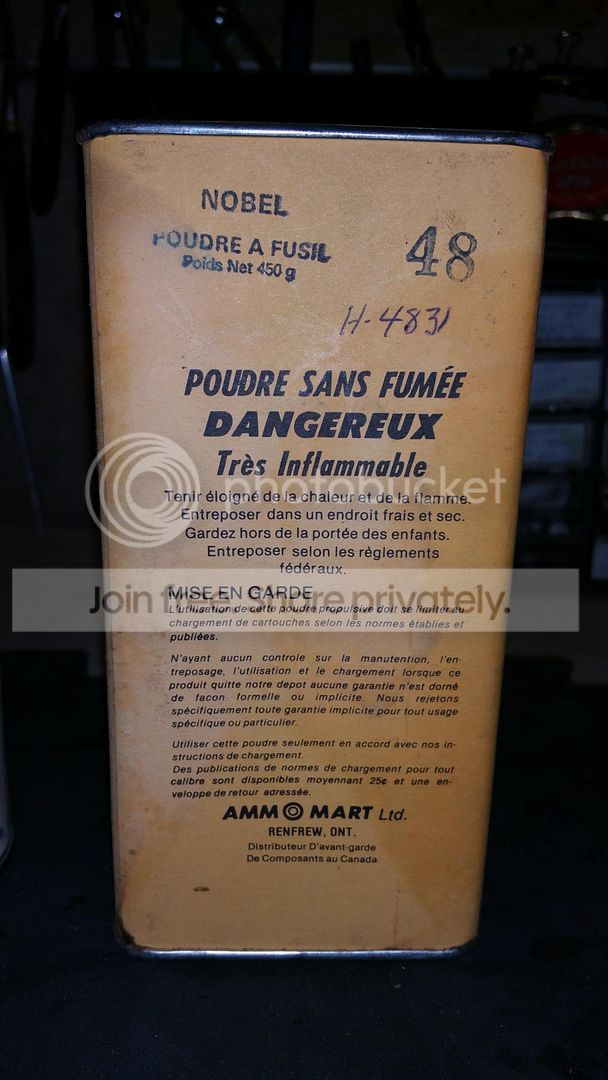

Tinman; You'll notice that that cardboard container says "Ammomart" on it.
That is the previous name of Higginson's Powder.
Still earlier, the outfit was known as Xelex Explosives.
Several of us began patronizing the original company when they were importing European ammo, particularly 22 rimfire stuff at phenomenal prices. [1950's]
I have bought and used Nobel powders numbered 41, 44, 45, 46, 47, 48 & 49 by Thomas Higginson [I still have a quantity of 47]
Regards, Dave.

Dave thanks for the info, I knew it was old but not that old!!!
It's been well stored and it's all gone bang thus far so I'll keep loading it til it's all gone.
