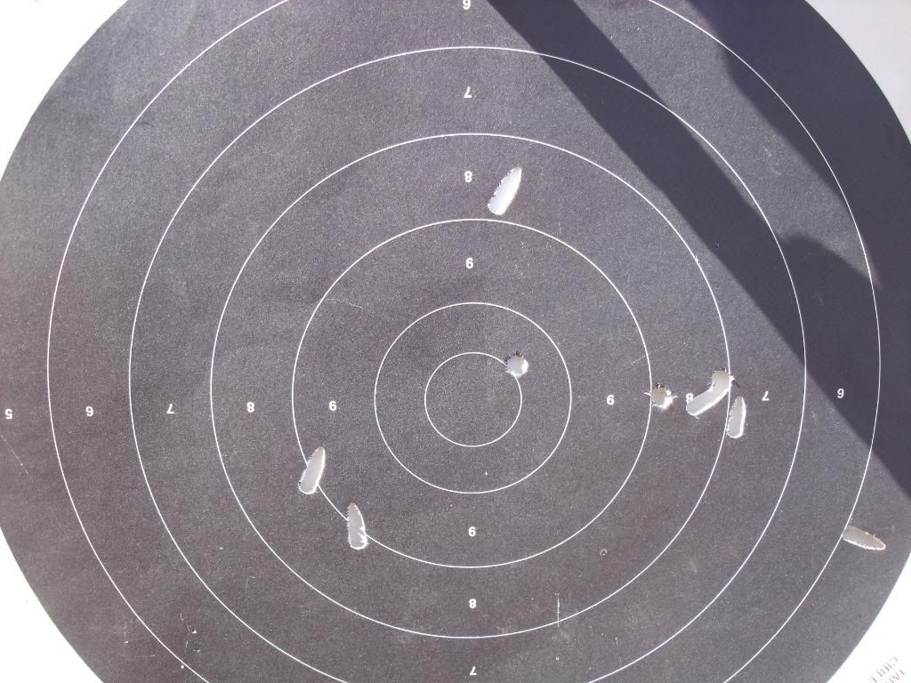

.243 WSSM didn't like 100g anything no matter how fast I pushed them. It's a 1/10 twist. Not a bad group though?
I see what your problem is.....the target was upside down.
were you using a sling-shot?

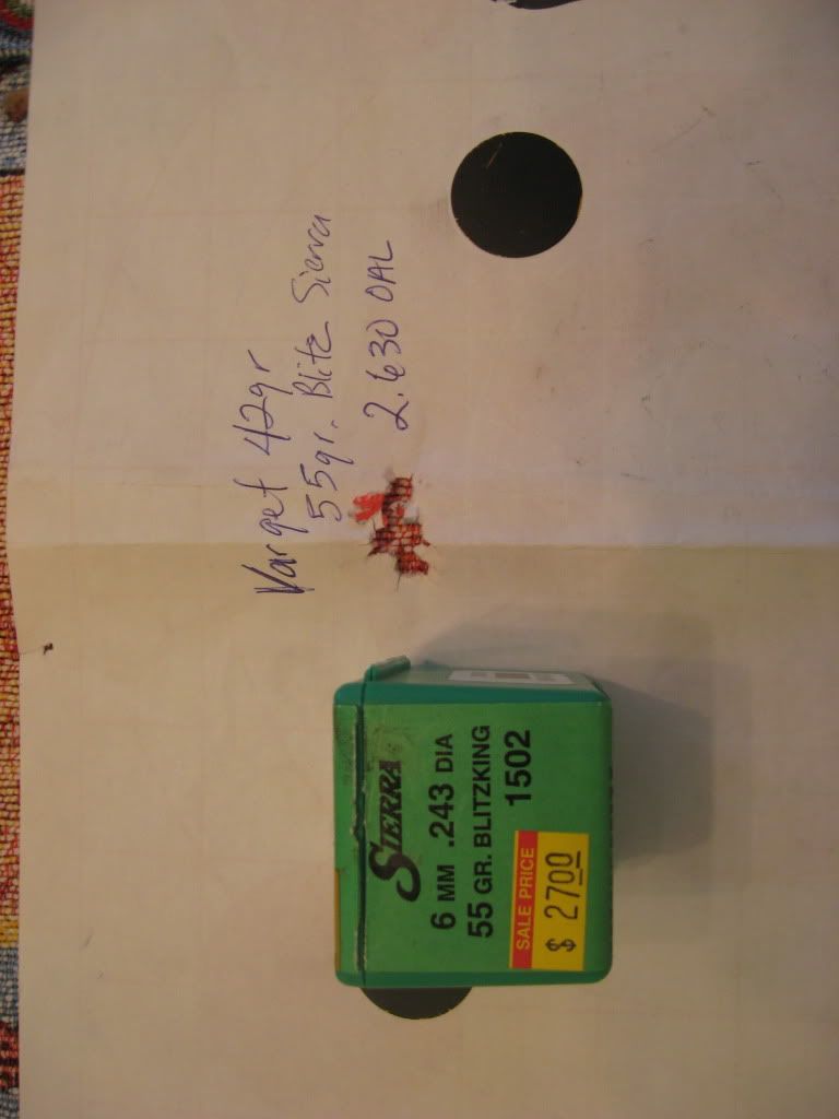

OK Ducimus here you go, I will share with you what I have learned. I also have a Remington SPS Varmint with 9-1/8 twist barrel and tried all the bullets you haved and finnally stumbeled onto this recipe that defies all logic as to what a barrel is "supposed " to like based on twist rate or even bullet seating depth and being close to the rifling.
I found this to be the best so far and can get 1" or less at 200yds even on a windy day. Up until this point I was lucky to get that at 100yds with 85 and 87's and forget anything heavy, 105 A-Maxes were 3" at 100yds. Likes em light I guess, but I am glad because I prefer that so lucky for me.
