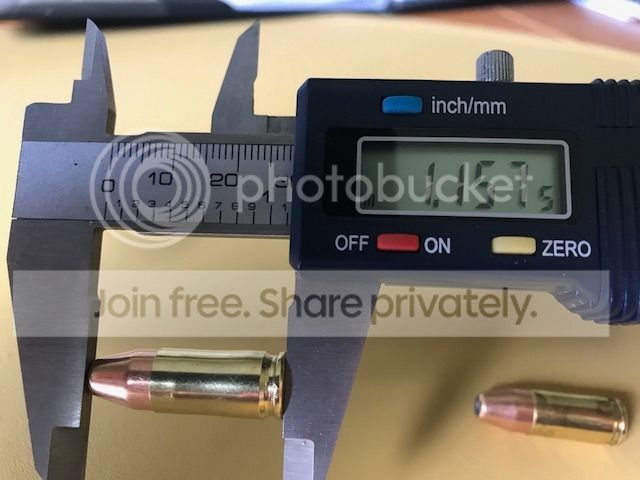

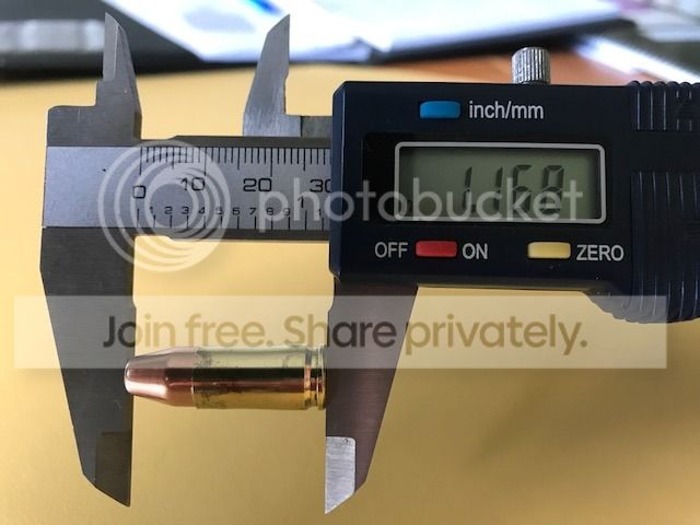

Hi all, been having a really hard time trying to figure out why I can't get consistent COAL's on my 9mm reloads with the Zero 125 JHP's. I'm loading using a Dillon 650 with the Dillon dies, tried using the Lee 'seating/crimping' die as well and the same results...variation between 1.158" and 1.164" and trying for 1.160" but never more than 2 out of 5 where I want them.
I measured the bullets and they are within less than 1 thousandth consistently. Tried measuring with the ogive adapter on the digital micrometer and the same variations as measuring base to tip.

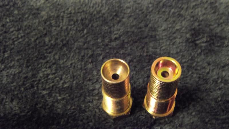

Check the seating insert in the die may have the wrong one for the type of bullet you are using.

Have you reloaded wax lubed bullets with that seater die? If so take it apart and look for lube buildup in the die. You might also check your brass for consistent length. That one that is measuring 1.157 looks funny to me. Are the casing getting all the way into the sizer die? the back end of that one looks wide. Maybe that's hanging up in the seating die and causing a shorter seat?

1) Try the round seating stem.

Thanks for all the feedback guys...just had a 'eureka' moment. Even though this Dillon 650 has never seen anything except Zero 125 HP's, I decided to examine the interior of the seating die. When I pulled the pin to remove the centre of the die a black pin fell out onto my bench. I was wondering where the heck that came from, it looked a lot like the 'tool head' pins, when another part 'fell out' of the portion still in my hand. To my surprise, ( am I the only one who never knew this...?), that part is a reversible bullet seater. The conical end had been in use so I reversed it to use the 'flat' end, put it all back together and ran some bullets thru the press.
Eureka! The variation is now reduced to .002-.005. This is my first progressive press and my first Dillon, so live and learn. I learned something else after looking at the brass closely again, ( after another comment mentioned the 'bulge' at the bottom of one of the pieces of brass...), and then checked the re-sizing die. It was loose and wasn't even touching the shell holder. I adjusted it properly and tightened it down...again. Never thought it would work itself back up out of the tool head like that. Again, live and learn!

That 1.157 brass looks terrible.
I've seen many people complain online about this, and it appears to be common when using dillon dies. 9mm is naturally a tapered cartridge, so some coke bottle effect is going to be a common thing. As long as it chambers and functions normally, appearence is not a huge deal.
