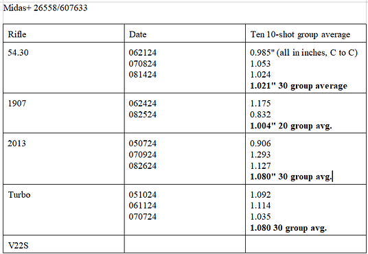

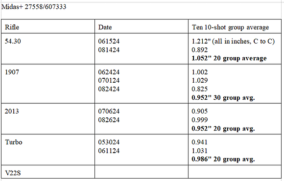

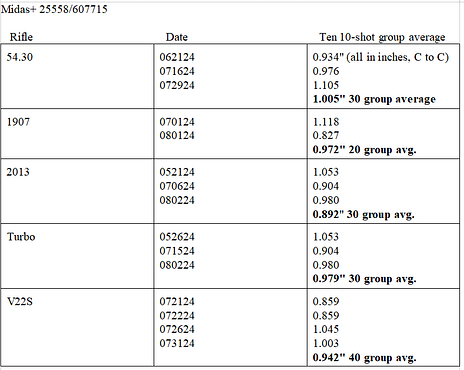

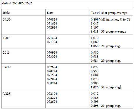

For anyone wondering how the same ammo shoots in different rifles, I've put together the basic results for four different lots of Midas + shot with as many as five different rifles. The results shown are ten ten-shot group averages at 100 yards.
The sizes are of ten 10-shot group averages or 100 rounds. Group sizes with the same ammo in the same barrel vary from day to day because conditions -- air movement between shooter and target -- changes. In addition, sometimes some boxes of the same lot had more "flyers" than others.
Differences in results may be affected by the amount of data developed. Some differences may not be sufficiently significant to have much relevance.
Readers may decide for themselves how much any differences between results supports the idea that different rifles shoot the same lots differently.

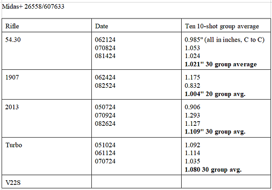

It's come to my attention that there was a mistake on the chart for Midas lot ending 633. With the 2013 rifle, the 30 group average is incorrect. Below is the correct chart.
With this lot, it doesn't seem that the four rifles shot it with very different results. In other words, same ammo with different rifles produced very much the same kind of results.
The other lots show something similar -- that different rifles may shoot the same ammo to the same results. While this doesn't prove anything, it supports the contention that different rifles don't necessarily shoot the same ammo differently.
In the case of M633, the results shown above, the comparison is of 110 ten-shot groups. That's a total of 1100 rounds. Two other lots compared the results of 150 ten-shot groups (1500 rounds) each. The smallest comparison was for the lot ending 333, and it had 90 ten-shot groups (900 rounds).
