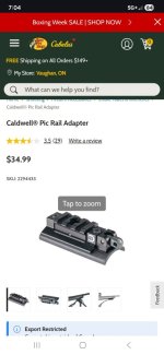

Seen these. Too long. I have 5 slot rail and need to keep the front 4 available for the tripod. View attachment 1061883
