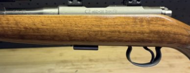

A CZ 452 threaded barrel end cap?
Seems these go missing like the rear sight insert.
Someone must have a bucket full of these including the infamous 10mm sockets.
Could this be Mikeezs work? 😳🤔😇
I don’t have the rifle yet.
It’s on its journey this way.
Once it gets’ear I will know the thread.
I figured they were standard for size.

Unfortunately no.
Not sure if CZ did the same as the Tikka T1x
1/2-20 UNF for Europe (maybe Canada and Australia as well, I'd have to check mine)
1/2-28 UNEF for USA

My Varmint barrel has the thread size roll-stamped on the barrel. Also if your barrel is marked C-ZUB it will be 1/2 20; if it is marked CZ-USA it will be 1/2-28. I have a take-off thread protector, I was able to find a CZ Compensator in 1/2-20 at a dealer. I like it.
