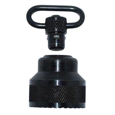

Update - I could not find one, so I made one. I took an Uncle Mike's mag cap that had a swivel stud on it and removed the factory stud (comes off with a snap ring). Bought a steel QD socket, the type meant to be epoxied and screwed into a wooden stock, for cheap off e-pay. I machined a shallop lip onto the base of the QD socket to fit the hole in the cap where the stud was installed. I then machined a bevelled counter-sunk head onto an M6x1 SOHC and fabricated a stepped flush nut from bar stock to fit the original stepped recess inside the mag cap. Assembled it all and then heavily peened the tip of the screw into the flush nut.
This will get cerakoted with the rest of the gun when it goes to TacOrd.
