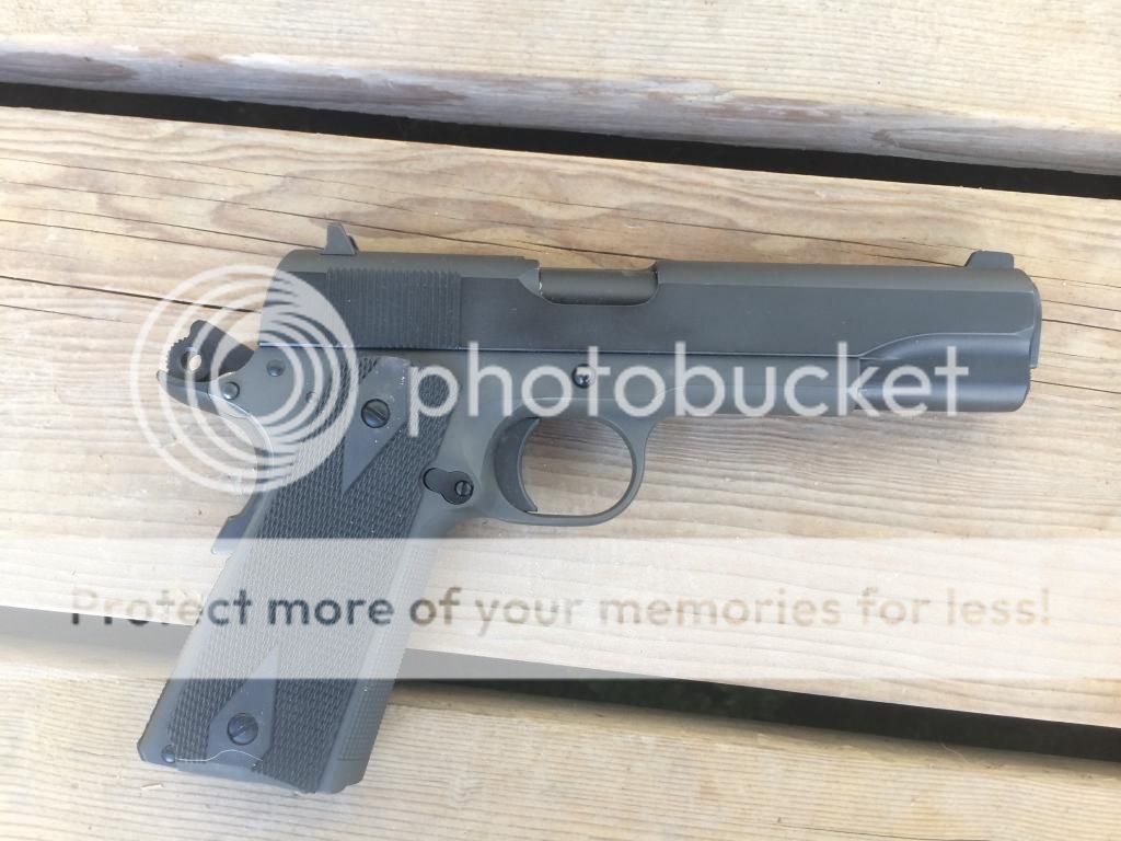

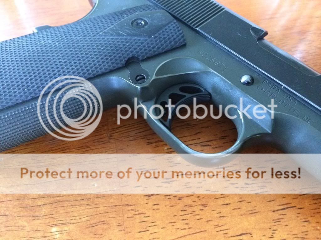

These wrap around the front strap and the edges are bent into to the frame cutouts under the grips and are held down by the grips. They are very thin aluminum but work very well.

Ok, so how does it attach? I was under the impression you glue these on, but please tell us how it really works.
As has been said, there is no glue. The strap is easily removable with no damage or alteration to your original gun. The strap is bent in such a way that it "locks" in under the grip panels (I don't recall if it locks to the frame or panel or both) and once its in properly it doesn't move.
If the texture gets dull after a few years (mine hasn't) you can just replace the strap...try that with a cut strap!?
I see that Wilson has a blued version which is a little bit noticeable as an add on IMHO, however my stainless one on the stainless SR1911 is barely noticeable...you really have to look to notice it as something that doesn't belong.
