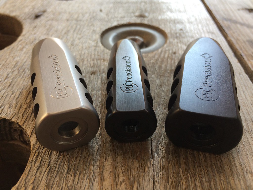

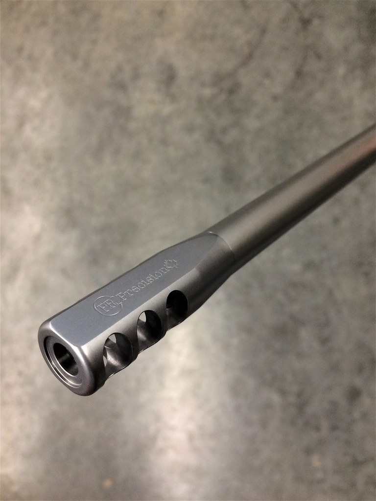

I make custom brakes and can use any thread you like.
Those look really good. If I'm unable to find an adapter I'll be in contact. Thanks!
