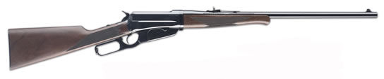

I will give that a try. Probably won't try to lean on it to much as the rifle isn't a bolt-action.:eek: :eek:
You know your stuff, if it's not a semi, pump, BLR or bolt, what could it be?:) :confused:
Oh, and it isn't a single either.:)

Good try. I forgot about those possibilities. But........... it's a magazine fed repeater, not in production anymore. :)

I figgered you had some behind the scenes help since we aren't talking M700s.:p :)
The rifle is a mid 80s Browning replica, which an artical I read last night says can take modern pressures safely. Still, it's a rear locking bolt design, not as inherintly strong or stiff as a good bolt rifle. One of the main reasons that I reload is to get as much as can be safely gotten from a rifle/cartridge, so, I'll see how it goes and how brave I feel.
My grandfather had a '95 in 303 Brit as well, it was his faithful deerslayer for years. I thought I would never buy another levergun, since finally getting LH bolts, but I guess I'm still a bit of a sentimental gunnut.:)
