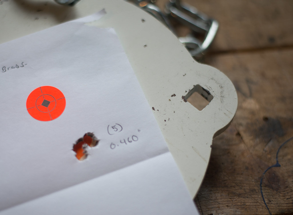

Thanks for all the help guys. I called insite, but their lead times are quite lengthy at the moment. Another CGN'r sent me a message regarding EM Precision Rifles. Steve Emblin did a fantisitc job on this build!
All thats left is a brake, which Insite Arms will win that spot!

Hornady 200gr VLD-X over H4350 are perfect for ragged holes and for Moose! (Rifle is chambered in .300WSM).
Thats a gorgeous looking rifle! What brake are you gonna slap on it?
nice ! what barrel is that ?

It was a PGW factory ordered .308 Barrel that I took on a trade here in the exchange section. The PGW barrels are made from Krieger barrel blanks. Since I don't have a PGW Coyote, EM Precision rifles re-chambered it to .300WSM and fitted it to the tikka action. The barrel was also turned down to match the shank diameter of the tikka. From my knowledge, this is the first time this has been done. Most of the other Gunsmiths I talked to didn't want to take on the project / told me it wouldn't work.
Nicely done. the accuracy is truly something. You started on a CTR receiver right ?
There isn't a lot of smith that d work on Tikkas to this extent. my smith lectured me on why it is not worth doing it vs get a new rifle but I asked him to do it anyways.

What stock is thay, and what does it weigh?
Beautiful rifle! Pretty spectacular accuracy too, nice shooting!
