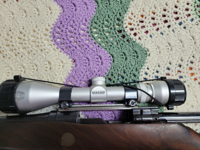

I sent him mine in the hopes I could post them here :dancingbanana:

Some pictures. It seems whoever makes a magnum Ross it always has a “ funky” stock

This rifle came to me as barreled action, and I bought the inletted blank I could. That is maple and ebony stock tip a Luther buddy made for me, and a home made cross bolt and picatinny rail, as the fitted Leopold rail cracked. It has a Simmons aetec scope. It also has a home made butt pad.
