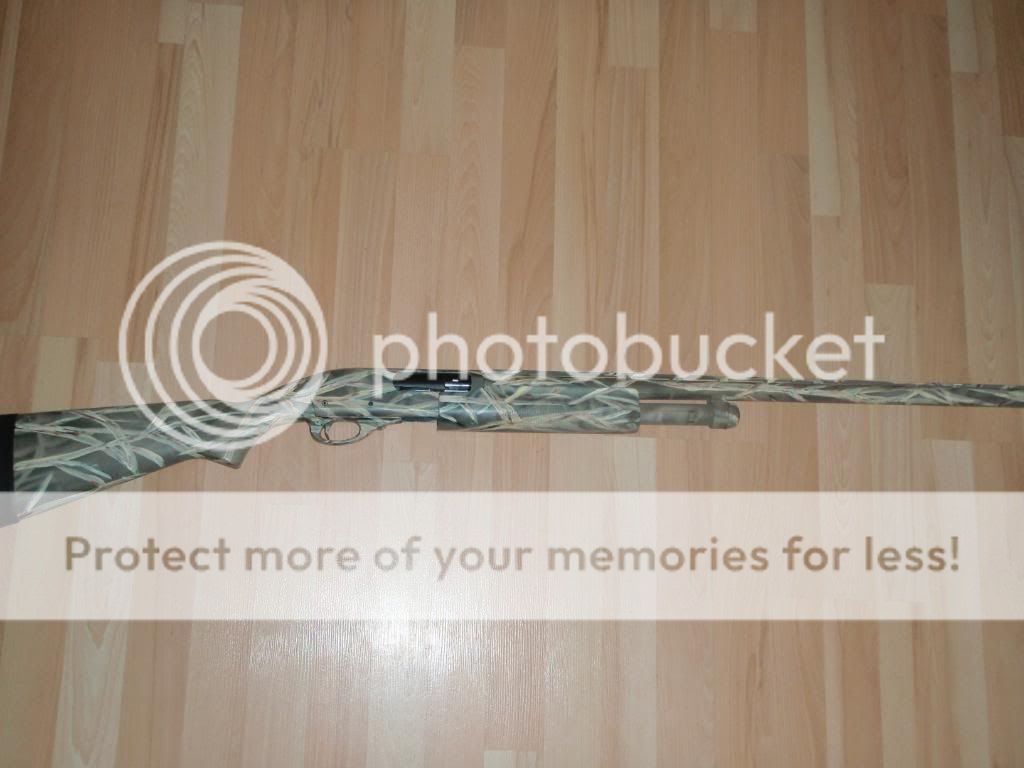

If you want to make your shotgun Camo, just sand it down and paint it like the way I painted my 870.
I'll pass. This is a ZOMBIE GUN, not some duck shooter!
