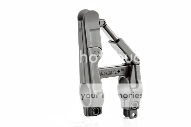

Got the YHM 1 on mine and I got to say I really like it.
1 point guys he asked for a railed gas block - not a flip front sight gas block - to mount a folding sight.
