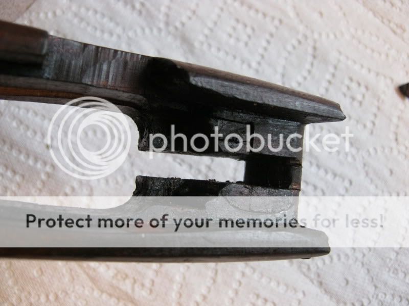

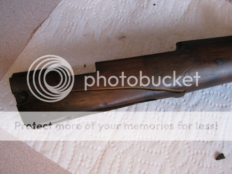

I went to take Gido's .303 out today and found a big crack going from the front action screw over onto the side of the reciever and all the way to the butt socket. I then removed the magazine to try and get a better look and a small piece of wood fell out! Now I can't find the damn wood!
I put surplus wood on Gido's old sporter when I was about 16 and haven't shot since I went to college. As best I figure is that I didn't get all the old oil/ grease out of the stock and a shift in temperature caused the wood to swell and crack.
I live in a small house without a shop/garage and the fiance won't like me taking over the kitchen table for a resto project. I also don't know what I'm doing. Ergo, I need a line on someone who knows a bit about repairing stocks and doing a proper refinish of the wood. Does the CGN community know someone (in AB, if possible) who does this kind of work?

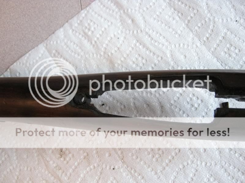

An update on the stock:
I removed the stock from the action and little bits of wood started falling off. The pictures should show what I'm talking about but, suffice to say, it's a real mess in there.
As this is a mix-master I think I'll try to do the best I can as I don;t think this stock set will be much good to anyone without major work being done to it regardless. I'm at my Dad's for the weekend so I can do some tinkering without incurring the wrath of the Mrs.
Looks like a later model Indian made stock. It has "The Damned Crack" and the draws are chewed up and rounded over.

With the oil soaked wood on this one, it would be difficult to glue it back together even with epoxy. Replacement is probably the best way to go.
Nope, made sure the butt was as it should be (was given very detailed instructions by the guy I bought the wood from). It think years of hard use, teenage ignorance, and a cool cabinet came together for this one.
Gorrilla Glue, will put the "crack"/break back together but as mentioned, that stock needs so much more work done to it.

The ways, receiver bed at rhe rear, are pooched. It won't matter how well you fix the crack, the rifle won't shoot well until the "ways" are properly restored.
Look up Peter Laidler's posts on Milsurps. He has posted photos and diagrams that anyone can follow. You will need a few days, for the glue to dry properly, before you start to fit the receiver to the stock. Be careful. You need to keep the ways square to each other and the receiver.

Quite agree with BOBFORTIER, especially if $$ is a factor, although I generally use Brownell's Acra-Glas GEL.
I use the thinnest bed of AG GEL that I can possibly get away with. I'm not interested in doing a book-style bedding job; I just want to RESTORE the bedding to what it should be. I have this strange idea that, just perhaps, the factory that built these things might have a rough idea how they are supposed to be done.
Further, I don't use the Release Agent included with the AG GEL, but rather a very THIN coat of GREASE on the metal. I was using that pretty blue grease (highly visible for wiping off afterwards) but ran out, so now I am using this red grease. Almost out of the red, it looks, so I will have to find another tube of pretty blue ESSO UNITOL. You only need enough to coat the metal visibly: no ripples or heaps, just a super-thin, barely-visible coating that wipes off when you are done.
And I don't mix up a whole big bunch, either. Generally, I can rebed six stocks with a single AG GEL kit; the book sez ONE. All I want to do is bring the bedding back to what it was when new.
BEFORE you start with any repairs, though, get a spray-can of brake-pad or brake-drum cleaner and use that. Four bucks at the auto wholesale and worth every penny. It will pull soaked-in oil right OUT of the wood and leave you a surface which will accept your repair materials. You may have to spray several times. Spray, wipe off, respray an hour later, wipe down again. Keep going until no OIL comes out on a paper towel. Now your wood is DRY. It is now time to start with your repairs.
That stock looks awful right now but if you take it ONE STEP AT A TIME, it can be done and the repairs won't even show unless you look REALLY hard.

Incidentally, upon closer inspection of the mess around the back end of the forestock, it is obvious it has been pinned together before. We found a couple square-ish chucks of wood being held in loosely by small brass pins.

Anything is repairable, even this one. However, the wood looks to be oil soaked and crumbling. If you could work magic and put humpty back together again, I think that there will be likely problems further down the road.
Indian wood is not known to be always the best, although some of the early wood sets are made from imported english walnut. Not sure what species of local wood they used on subsequent runs.
You would be trying to turn a sow's ear into a ...sow's ear.
It appears that the damage is likely caused by poor bedding, the draws and trigger guard did not hold and recoil has hammered it all to hell
Get yourself another forearm and read up on bedding. The fit of those draws and the trigger guard are critical, otherwise you get a crack forming at the front trigger guard screw and..........
Perhaps you are up for the challenge, but an armourer would not waste his time making a dodgy repair, he would replace the fore arm I am sure. Just my tuppence worth.
