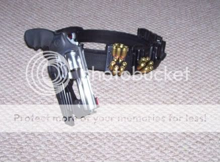

Here is the rig I'll be using next year in IPSC:
It's 4" S&W 610 in a CR Speed WSM II holster and Blade-Tech moon clip holders all on a CR Speed belt.
The 610 is a 10mm and can also shoot 40 S&W. I expect Dragoon is shooting 40 since brass is cheaper and shorter and does the job for Major.
Very nice setup BTW Dragoon!.
