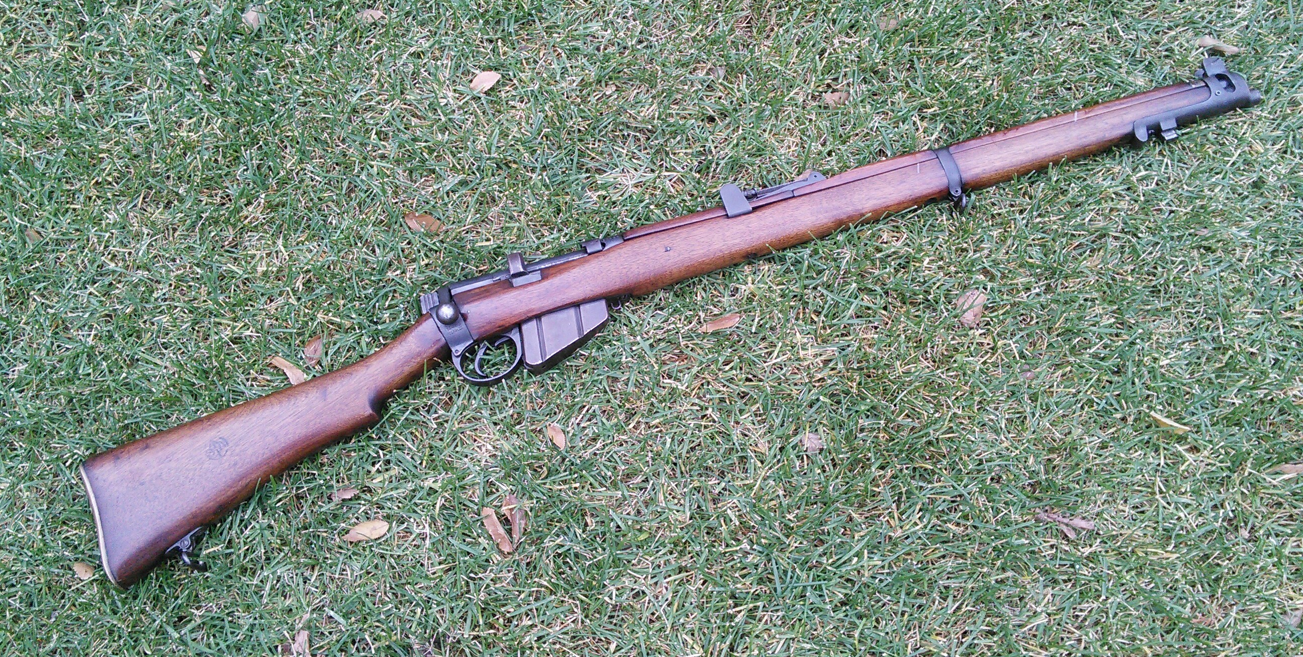

My 1945 Ishapore is a fine rifle. I don't subscribe to the snobbery either.
EL34/6L6: Beautiful old rifle! I own some Ishapores, including a nice one that was restored (not by me), two .410's, and a couple others. The restored one started off as an Enfield, was redone to a .410, the redone back to .303, all duly marked. The old girl shoots pretty good, too.
**Edit: I guess the restored one is actually an Enfield original build, put to .410 by Ishapore, and likely (?) put back to .303 by Ishapore.
And guess what...They all have that ISHAPORE SCREW!!!!!!!!!!!!!!!!!!!!!!! :runaway:
My Ishapore 410 barrel is marked as a 303 with a 1918 date. Obviously, it was rebored: cheapest way to do the job.
BTW, an Ishapore to be on the lookout for is one of the very few dated 1936 which had the Royal signet for Edward VIII. They are NOT common.
