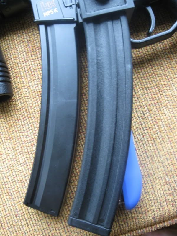

The new promag 9-22 mags have the same curve as a MP5.
