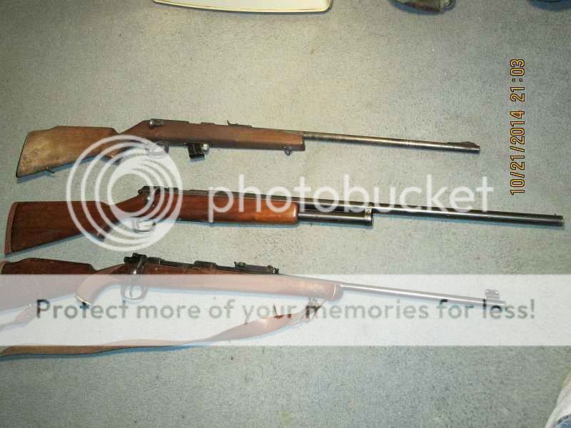

23 inches longwhats the barrel length on that one?

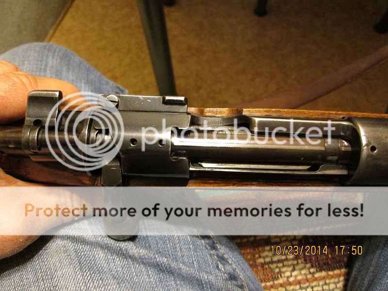

I have a weaver bag marked 46. It has numerous mounts that have the same hole spacing which will work for the front mount. The rear mount holes are 1/2 inch spacing. Could you verify which weaver base would work?The rear ring has been recontoured for a scope base, in addition to the drilling and tapping. One piece scope bases are only one option. Two piece bases are very common. I bet that Weaver bases #45 and #46 would fit. If you are lucky, the holes will be properly aligned.
Is that checkering on the grip?
Anyway the d&t is a common sporting modification.
I got the bases, what rings did you go with?My K98 is drilled and tapped and loads like every other bolt action out there. Sits in a full wood military stock.
