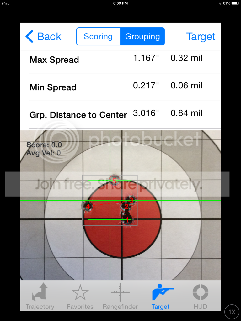

Ballistic ae also has a measurement tool for group size and off centre measurments. But I believe those programs use the age old method of subtracting the caliber of bullet which goes totally against the OP method as its apparently totally inaccurate.
Fact is, it's not inaccurate. When overlaying .30 circles on the image and bullet holes. The measurements happen from the outside of the overlaid circles thus removing the odd sized, ragged paper issue the OP is having issues with. To reiterate. If you use an app to measure, it's as close to accurate as you are going to get.
