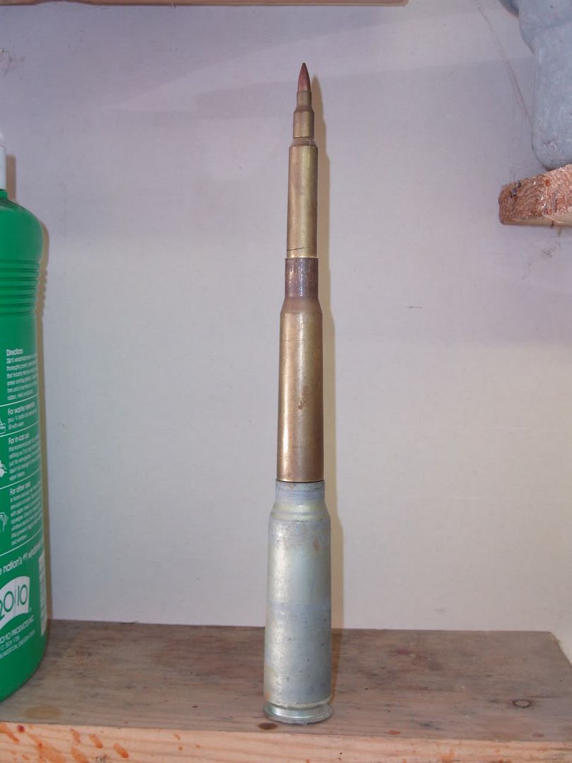

Just as a gag round, certainly not meant to be fired, I took a 20x102 Vulcan case, stuffed a 50BMG case into the mouth, then stuffed a hunting round of some sort (A 7mm REMMag with the belt ground off, IIRC, then put a bullet into the thing. It stood about a foot tall. If I can find a photo, I'll post it.

Yeah it is! Now I just have to get a barrel blank and custom chamber reamer for it.
