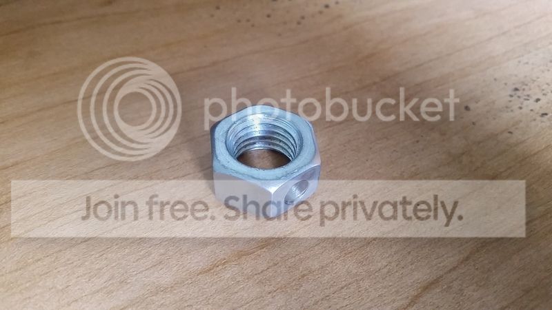

Hello all,
I was planning on buying the "Hornady Bullet Comparator" yesterday but after seeing wholesales price of $78 i decided to get it online for $48. Now as i will doing some reloading tonight I had to come up with something else in the mean time. I see that sinclair makes a gauge basically out of a nut and figured this should be easy enough to do. I'm sure my way of drilling a hole that just gets me on the Ogive is not as precise as a machined piece but still has to be better then measuring overall lenghth as a means of finding the correct seating depth.
I re-measure the length when the bullet hits the lands by using a fired case with a bullet put into the action and close the bolt...did this 4 times and got an average of 2.828. I then loaded up my current round and it measured at 2.787 a jump of 0.041, Here i though i was at 0.030 from the lands. I plan on playing around with different jump length from 0.025 - 0.015.
Am i crazy to use this home made tool or does it seem like it should be ok? Going to be on a 7mm Rem Mag
Thanks!

That homemade gauge is all you will ever need, and will be every bit as accurate.

Well it works, but it takes a bit of playing with to get it in the same repeatable spot, thanks for the remaining useless portion of your post. :jerkit:

The ogive diameter for 7mm is 0.284"
If your hole is accurate then your base to ogive length will be accurate.
Thanks for the actual measurement, just went and checked mine and it is .260" Can probably modify it a bit more.
You homemade hex nut will work in a snap and if similar to the sinclaire's hex nut comparator.
Ensure your bore diameter match the diameter of your comparator. If it's tighter that or larger you're seating depth will be slightly off.
Just trying to make a point. You are on the way to reloading enlightenment with your current path and creativity.
