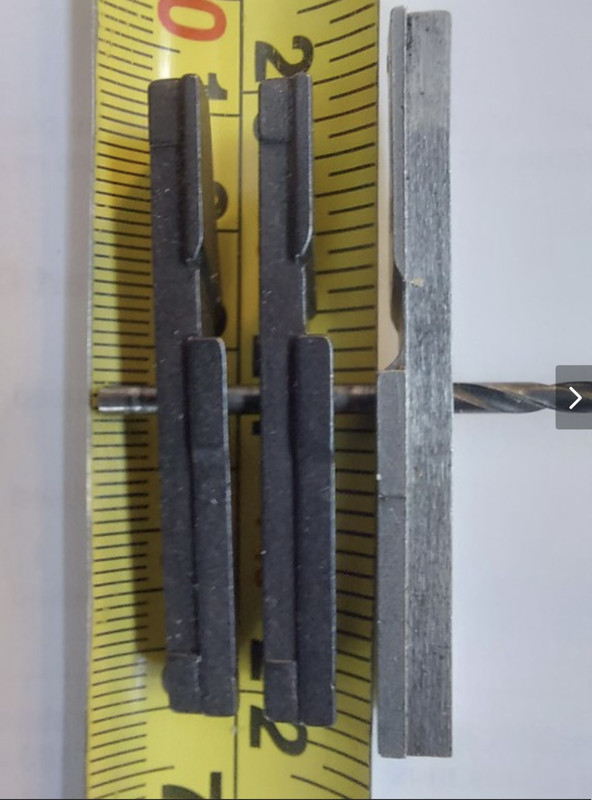

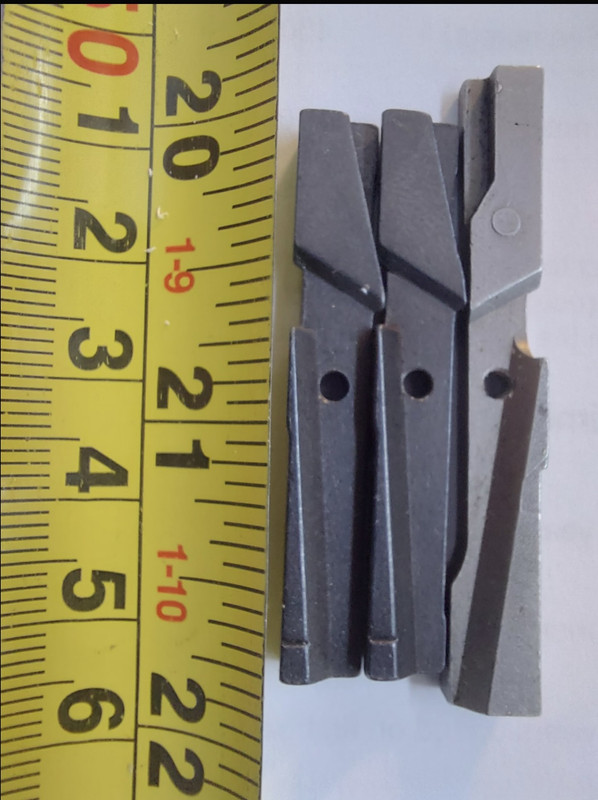

So this post 64 Winchester 94 in 44 mag was missing the left cartridge guide. Ordered one from one of the few US suppliers that will ship to Canada and when installed the cartridge guide grooves did not match up with existing right side. Notifed them and they sent replacement which is identical to the 1st one they sent. So I took out the existing right side guide and it measures about 2 1/16" long wheras the ones they sent are about 1 13/16" long and if I line them up by the screw holes which align in the action frame the guide grooves in the new left side are almost 1/8" forward of the original right one.
Anybody familiar with this gun and caliber that can tell me the correct length of the left guide? Anybody know anybody in BC that might have one?

Here are the photos I took showing photos the original right cartridge guide that I removed from the gun for these photos is on the right and both of the left side guides the ones they sent me are on the left.
https://flic.kr/p/2ojgt11
https://flic.kr/p/2ojiV8u

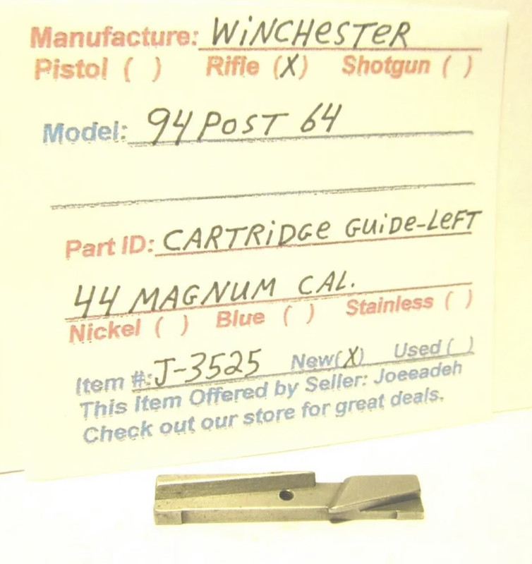

Maybe these images help somewhat.
LEFT Side cartridge guide for a 94 POST 64 .44 caliber magnum.
RIGHT Side cartridge guide for a 94 POST 64 .44 caliber magnum.
Pardon the photo’s orientation. It’s the best I could find with a ruler next to them and being clearly described as post 64 .44 Mag.
The second photos are from Numrich.
