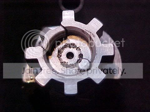

Was shooting my 25/06 the day when it happened. First I noticed a small amount of black stain on the head stamp and thought 1/10 maybe the primer wasn't flush. I wasn't shooting my best so I packed up. I had a hard time keeping steady even with the bipod. Next range trip first shot did t same with a tiny pin hole between the pocket wall and primer so I thought ill try one more. I had not left a trace on the bolt face
At the second shot the smoke rolled out around the bolt. It opened and ejected just fine but there's a definite hole between the primer and pocket wall and an ugly mark on my bolt face. It didn't cut into it but I can't get it clean
