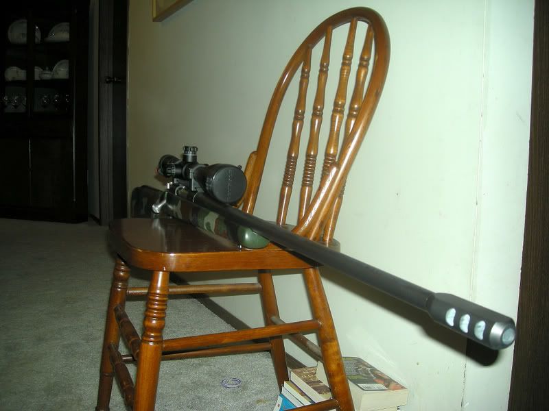

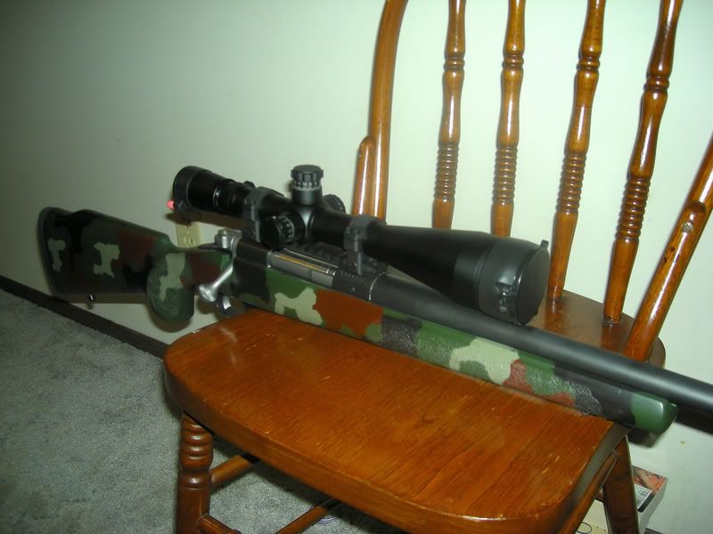

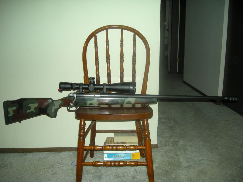

I'm just range testing my new one built by HWSNBN.
-MOD70 CRF Long Action (Williams Firearms replacement CNC Stainless Claw Extractor) action blueprinted
-McMillan M40 stock, Pillar & Glass bedded
-Williams Firearms one piece stainless CNC bottom metal
-RKS single point cut rifled barrel (1-10 twist) / 26"
-Custom made muzzle break
-Farrel 20 MOA Rail
-Badger Rings
-Leupold 6.5-20x50 TMR / Mk4 Tactical
The gun also has a mag box and follower from a 375 H&H. This way I can load 208 Amax type rounds almost right into the lands and still mag feed.
I have the jewel trigger for it sitting right here in front of me, just have to make one more trip to HWSNBN for the install.
The gun really likes the Amax and I just ordered some 210gr Berger VLD's to try.
Sorry for the crappy pics, my good camera is at work!
