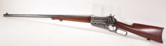

What a story! Incredibly interesting. It’s great to see a rifle handed down from generation to generation like that.I have my grandfather's civilian version 1895 that is chambered in 30 U.S. (30/40); it was manufactured in 1898. This is that rifle with him and two mulies up the Bull River, circa 1940.
I often wonder how my grandfather was able to align that razor blade thin front blade in the notch in the rear sight. When I inherited it from my father, I had Bill Leeper fabricate an identical appearing front sight about the thickness of the blade front sight on a Lee Enfield No.4 Mk1 to go with a replica of the Lyman no-drill aftermarket rear sight.
I hunted with it a bit as a kid from time to time and remembered my father telling me he couldn't get much for grouping ability from it with either commercial loads or handloads. Once Dad died and it passed to me, I tried fixing the problem my Dad hadn't solved.
The short story is that after a lot of failure I slugged the barrel and it is almost like they took a barrel destined for the .303 Savage rifles and then chambered it in 30 US and put it on this rifle. As soon as I ran a .303 Lyman M die into the case necks and seated .303 caliber bullets, the grouping issues were cut in half.
I expanded on that finding by slugging and measuring the chamber's bore seat and lead, and then had Accurate Moulds cut a custom mould for a WFN bullet design for hunting. That resulted in 2 MOA groupings with 2200 fps at the muzzle, out to 200 yards with that rifle and the aperture sights off the bench. Problems solved.
I'm not much of a lever action guy, but I would probably like the 1895 even if this one wasn't my grandfather's. I take it out hunting once or twice a year in the riparian bottomlands along the same Bull River that my grandfather hunting. It worked just as well as any other rifle in my gun safe on the deer that I have an opportunity to shoot with it.

The bore in this 95 of my Grandpop's is pretty pristine, despite the corrosive primers of those days. He was a fitter and turner by trade who immigrated here from Scotland to work for the railroads here, so my assumption is that he knew of the damage that the corrosive primers of the day could do, and used a machinist's care to properly clean and oil the bore after firing. A lot of 1895's from back then (i.e. circa 1898 on to the first part of the 1900s) are likely to have damaged bores due to inadequate cleaning from ammunition with those corrosive primers.
The way out of spec ball seat, leade, and .303 dimension bore may or may not be common in 1895 rifles of any caliber; a Winchester collector might have more knowledge of that. But it's a reality for my rifle.
One way to deal with grouping problems if the bore is bad or out of spec on these or other older rifles, including milsurps like Lee Enfields, is to use a bullet mould that drops bullets that give you a good tight fit. That is one advantage they have over jacketed bullets when you find your barrel is out of normal spec for the caliber it is chambered in. Powder coating makes bullet casting so easy peasy these days, once you understand the relationship between the bullet's fit into the ball seate/leade and matching Brinell hardness to your reloads' operating pressures.
