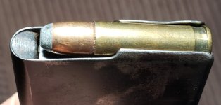

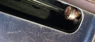

Here's the skinny on what is what with mags and rounds fitting in original 35 and 351 mags.
Pics of both mags. Seems like someone modified an original 35 magazine to fit the 351 cartridges. If you Look at my original 35 magazine, you can see that it has a square front to the follower, and the feed ramp is attached to the magazine body. Looking at your magazine floorplate, bps540, it looks like they removed the follower and the feed ramp, and welded the ramp onto the front of the follower to make it longer and to get the ramp out of the way for the longer 351 cartridges. It also looks like they modified the rear magazine lips to shorten them to what length of the top (351 mag) should be. The magazine bodies are almost identical between the two. All of the factory magazine bodies were supposed to be stamped with the caliber on the bottom. Either your's was ground off, or yours is an aftermarket European magazine

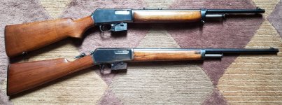

The 351 will not feed into an unmodified 35 rifle. Here's what it should look like.
The scary thing is, the forend on the 35 is very narrow, and it's highly unlikely that more weight was added to the counterweight under there. The 35 forend has very flat sides, whereas the 351 has a rounded forend to give more room to the beefier counterweight. Without that extra weight, and the stronger recoil spring, I would think that it would be unsafe to fire using 351 rounds. More investigation under the hood, so to speak, is needed to see if there were any more modifications done to the spring and counterweight. There has to be a catch here. I can't see them doing all that work, and not figuring out that it would blow itself apart with a bunch of rounds through it if the modifications weren't also done to the counterweight and recoil spring. But who knows!!!

I like both of them, find the 07 a bit better balanced. I use mine for deer hunting, they work well.
I plan to take mine out a few days this fall also. I tend to hunt with several rifles each year, it’s a bit random which I’m carrying when I bag my white tail. Maybe this year it will be this 1907 - who knows?
