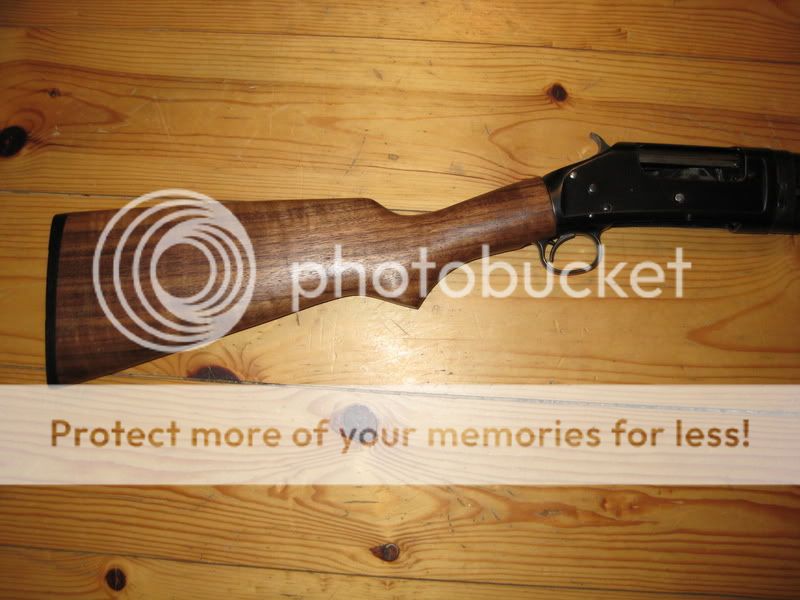

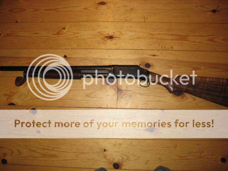

Here's a cuppulla pics of my just finished '97. She's a 1932, 12ga. When I got her, she was a bit of a dog's butt like Albayo's. Had a barrel that was somewhere between seven and ten feet long, dented at the muzzle. Finish was pretty well nonexistant, stock was cracked and gummed up to sheiss. I stripped it down, sent the barrel assy over to Casey @ TACORD, he chopped the barrel to 20.5", and did essentially a Vang Comp job on the barrel- lengthened the forcing cone, and back bored it to modified and put a big fat bead on it. The only thing he didn't do for a full Vang Comp mod was porting. Got a new stock from Jeff's- check the above link. Five coats of rust blue, and voila.
The stock and the pad aren't flush. We can all see that, but the pad has been very poorly ground to fit the contours of the stock. The pad should be ground to look like an extension of the stock. The pad also looks like it's not exactly new. For a great old gun like the '97, take it to your smith as is and he will fit the pad to the stock so there's no gap and he'll contour the pad properly. If you need a new pad , so be it. It may cost you $150.00 but that old girl should be made to look her best.The pad shows grooves and irregular spots , that any good smith would never give back to a client , never mind charge for.
