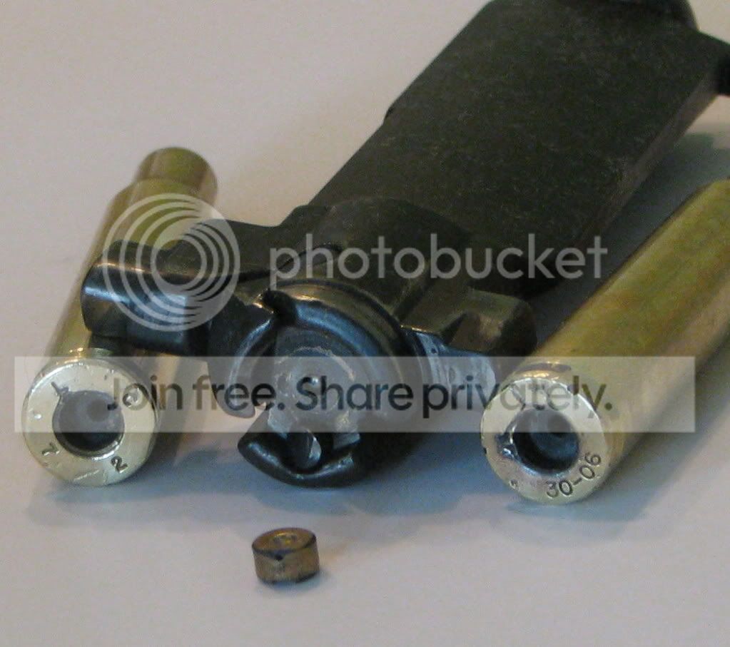

Hmmm. Load data appears to vary by manual. The Lyman 49th edition lists 44.0gr of IMR4320 as max for a 150gr SP projectile using Federal 210 primers. The Hornady 8th edition lists 40.7gr of IMR 4320 as max for a 150gr SP projectile using Winchester LR primers. The primers may be the key element as the WLR raise the pressure slightly higher than the Federal 210. At least according to Lyman's data on various primers. The combination of hot powder load and slightly hotter WLR primer may be contributing factors.
Just reading through the data and trying to put 2 and 2 together. I'm new at this too.
