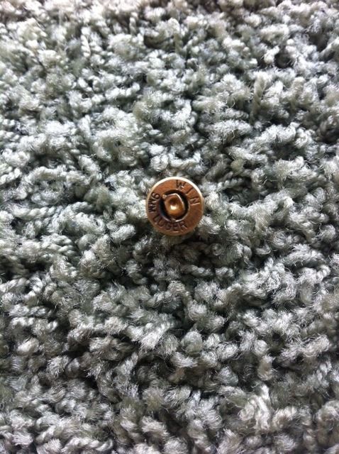

I just heard about several cases of the primers blowing holes out of sides damaging bolt faces with Winchester primers has anybody here on CGN seen this?

Have had is happen exactly like the pic in the OP with a WLR primer. Cut a little channel in the edge of the ejector hole on the face of the bolt.
