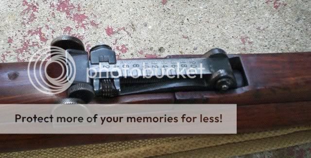

One of my mk III* has the windage adjustible rear sight. And all the numbers match, on all parts. To bad someone masacred it with a screwdriver!:mad:
Here's the bottomside of a windage adjustable sight that was on a 1916 Mklll* RSAF Enfield , which was pinned through the adjustment screw . The knob was long gone . The sight's serial number matched the receiver/bolt/barrel.
A fully functional w.a. rearsight
