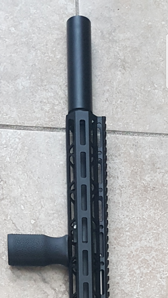

Here's an example done by Wolverine with our handguard and fake suppressor:
17" looks better. Those exta inches make a difference... I can be a real size queen sometimes.
I did the 15" on mine with the reverse fake suppressor, looks awesome and just the right amount of overlap between the two. Was extremely easy to install, just needed a large screw driver to spread the new one enough to fit around the original barrel nut and then tighten. I sent the results to TNA, they might be able to post it.
Yeah, I totally meant 15". I originally ordered the 17" but they had no stock so I settled on the 15". Glad I did because it looks way better. Just like you said, the right amount of overlap.

Thanks for the picture, this is what exactly I want for my setup ( had the Reverse can for my banned AR)~~~ordered a 15' black :p~!!
