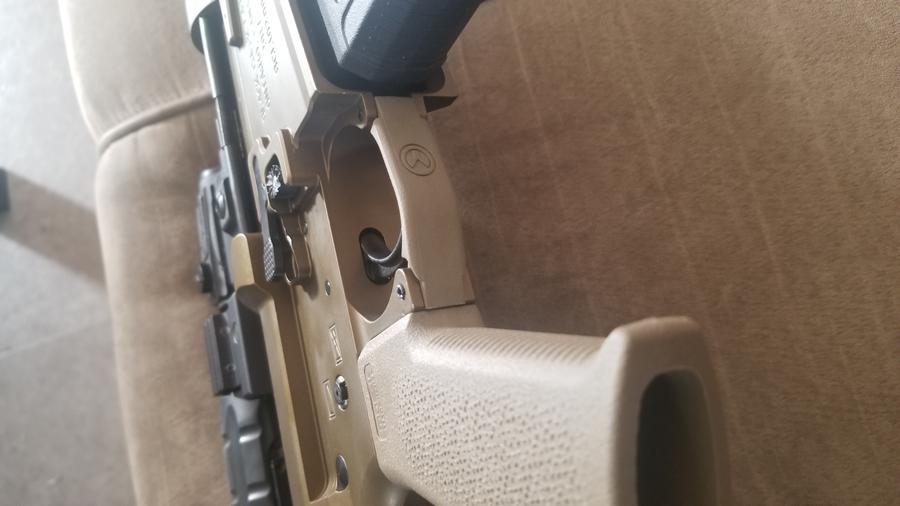

Here's my trigger guard that was fitted with a dremel. If you know what you're doing you can easily modify certain parts without destroying their function or value. It's like working on cars, some mods will add value, some will not, and the competency of the worker is the main factor. If the mod makes you happy and you plan to keep the rifle, more power to you. That being said i personally would not mod the eotech...

^ what I meant was dremel work done on the main frame of firearms, which would be an expensive mistake if done wrong. No doubt it’s possible on a plastic Magpul piece, but I wouldn’t do it on, say, the body of a Tavor. Nice work tho!
