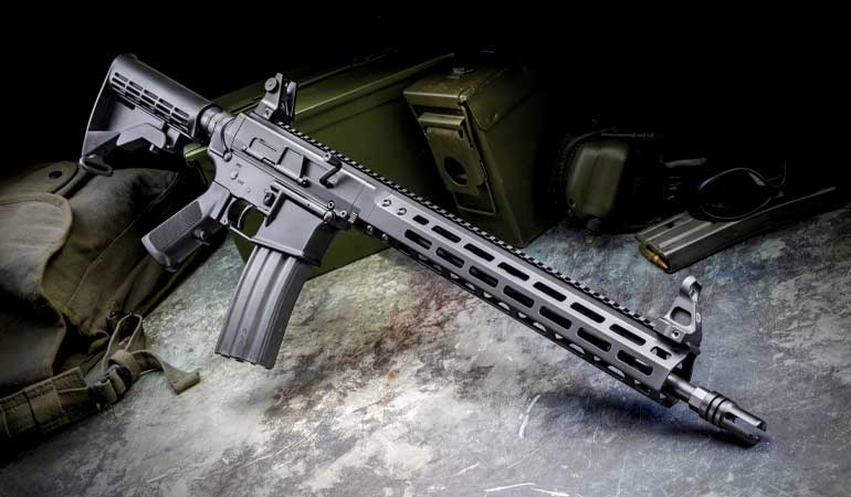

What about a brownells BRN180 handguard, it transitions from square receiver to round handguard nicely any plans to build something like that?
