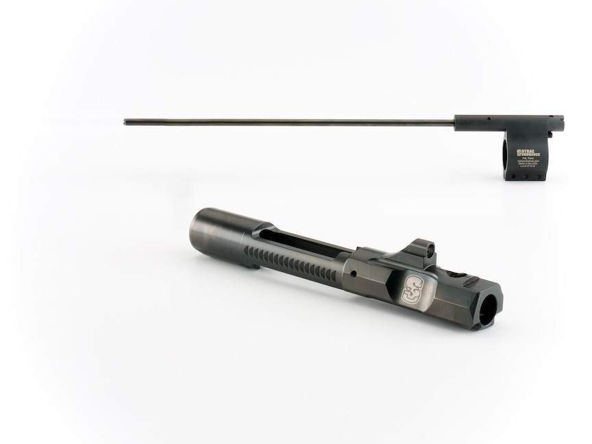

Interesting - I had thought the 'new' hand-guard that they ultimately went to was not interchangeable.... at least you would not be able to get to the gas block without removing the guard.
You could run a DD MFR barrel nut or a standard barrel nut, the gas block and allen bolt on the end is really big, it won't fit inside of a rail. Also since the upper is so wide, you would have to run a handguard without anti-rotation tabs.
I thought it took a standard ar 15 barrel nut, is the gas tube system so big it won't allow other handguards?
It has the standard thread. The gas block is really big. Also since they decided to run the spring all the way to the upper it limits the number of handguards you can use. The spring is a larger diameter.
Most AR-15 piston guns use a gas tube diameter rod, the spring is near the gas port or there is a spacer.
Could you measure the interior diameter of the handguard? I'm sure there are some aftermarket handguards that are big enough to go over the gas block. I'm also very curious as to how much the stock handguard and barrel nut weigh to see if there's even any real weight savings you can get. Although, judging by the barrel nut, that thing is massive and weighs at least twice as much as what it can be with an aftermarket handguard.
