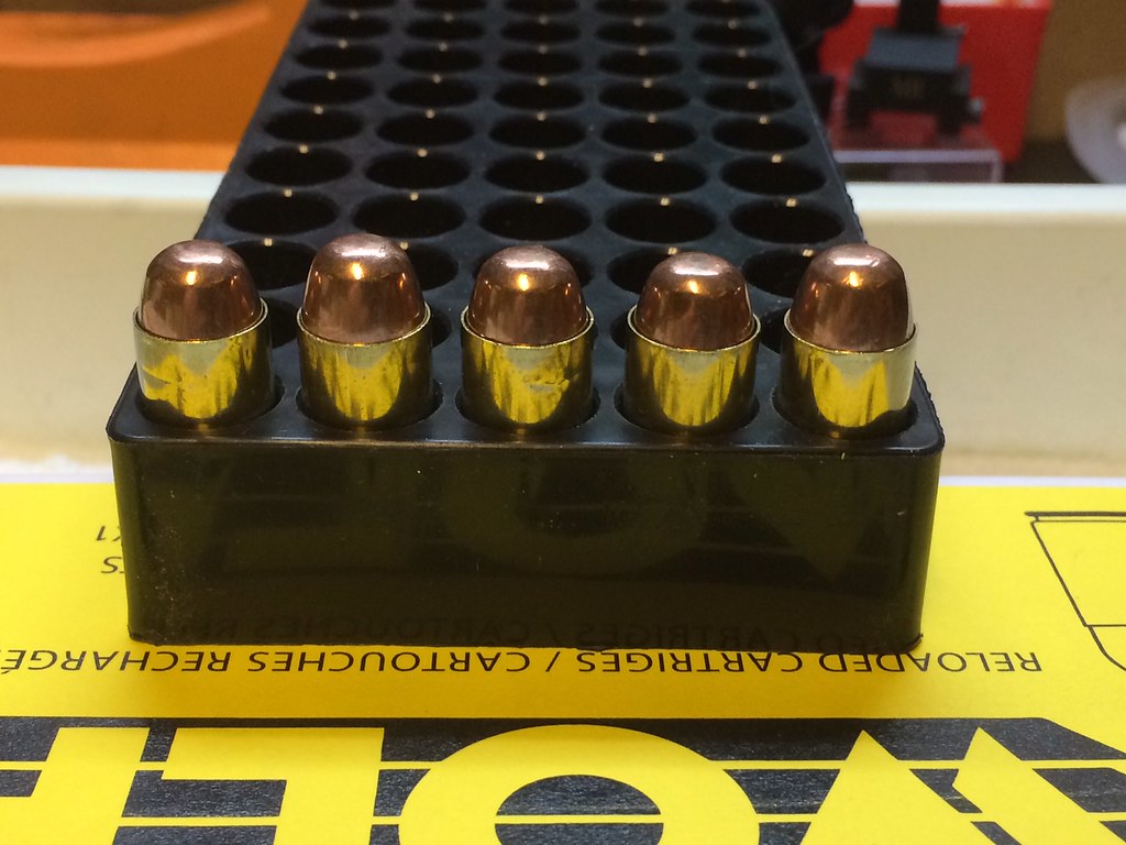

Same here. All the Wolf reloads I've shot were pretty dirty. Then my buddy and I ran into a batch that had pretty loose bullets ie you could push it down into the case with your fingers. Only found that out when my buddy's Ruger 1911 jammed on a round. When he inspected it, the bullet was shoved most of the way into the case. We decided to test the rest of the pack and found 5 that had the problem.
Hopefully they stepped up their quality or someone's gonna end up with a kaboom.
this exact same thing happened to me, and by exact, I mean the same pistol too, along with their .45acp 230grn fmj ammo.
