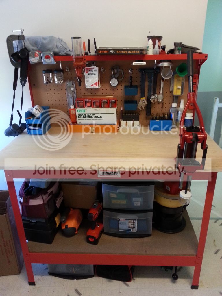

Hey guys, I am thinking about moving my reloading station from my workshop that has a built in bench, to a spare bedroom in my house.
I was thinking about buying something like this and drilling holes in the tabletop to mount my single stage press and powder thrower...
What do you guys think?
I've got a cheapie CrappyTire workbench. Looks similar. You might want to double up on the counter top or it will eventually crack from regular use from your press. You will loose the use of one side of the drawers because of the press unless your mount it off the side instead.
I use the Black&Decker Workbench as a dedicated reloading bench. I added a larger, thicker wood plank on top and a small one at the bottom that serves as a shelf. It's not a big setup but it's sufficient space for my Hornady single stage press, my 2 powder throwers, my scale, tumbler and dies.

That looks pretty flimsy. Remember you will be torqing on it pretty good, and usually from one far side or the other. I made my own from 2x4s and plywood and the first time I sized a case realised I needed to inforce the legs more because when it loaded up the bench twisted a bit. Now its rock solid.

I made mine from scratch but the CT one you pick out and beef up on the work top will be fine. Mine is similar in looks. Though, something to be mindful of is workbench height. I am 6ft, so I built mine with a higher workbench height to make it easier to work at while standing. IE, working height while standing with elbows bent at 90degrees. My wife bought me a pneumatic adjustable height stool which is perfect for my reloading bench. If the CT bench seems low, just put it on a platform and bolt it down.
+1 on the strengthening the top. I'd also put something underneath it so the steel legs don't chew the ####e out of your BR floor. I built my own with 4X4s, 2X6 top rail and 2X4 shelf rail, plus double thick 3/4 plywood glued and screwed together. Made it about 72X32 to give lots of space for 2 presses and "stuff". It's really not that hard if you can use a saw and drill.
If not, get the strongest frame you can find, you're going to be beating on it pretty hard. If it flexes when you lean on it hard, move on. If you're going to double up the top, I'd see if you could make the top bigger too, need lots of space for "stuff".

My bench is 3 layers of 5/8 plywood glued together, and it still would flex a bit when the press was bolted directly to it. Now that I have the press bolted to a steel plate 1/2 by 8" square, the flex seems to be gone. The back edge of the plate is bolted to the bench top 7" in, inside of the top rail of the bench frame, instead of 1 1/2" in from the edge....
