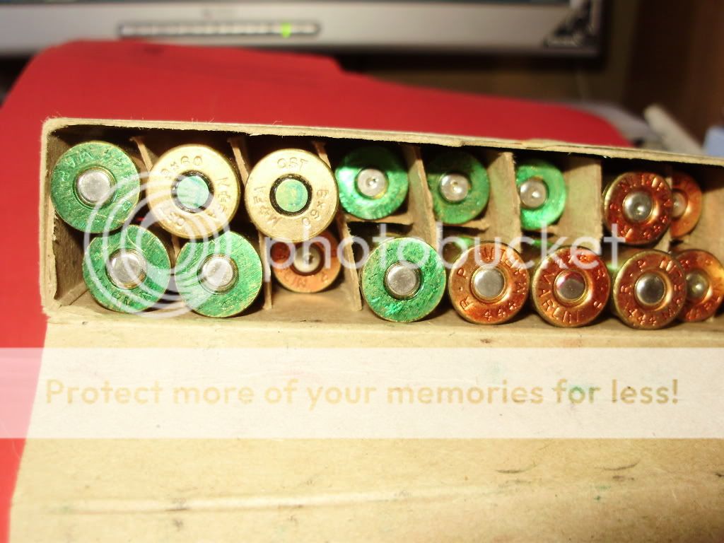

If you are unlucky, you will find that a pair of different powder charges are needed to make each barrel shoot POA. That is, you might find that 55 gr in the right barrel and 59 gr in the other shoot to the same place. I have a rifle like that. I mark the case heads with red and green ink and load different ammo for the left and right barrels. The range or game would determine which barrel I shoot first.
