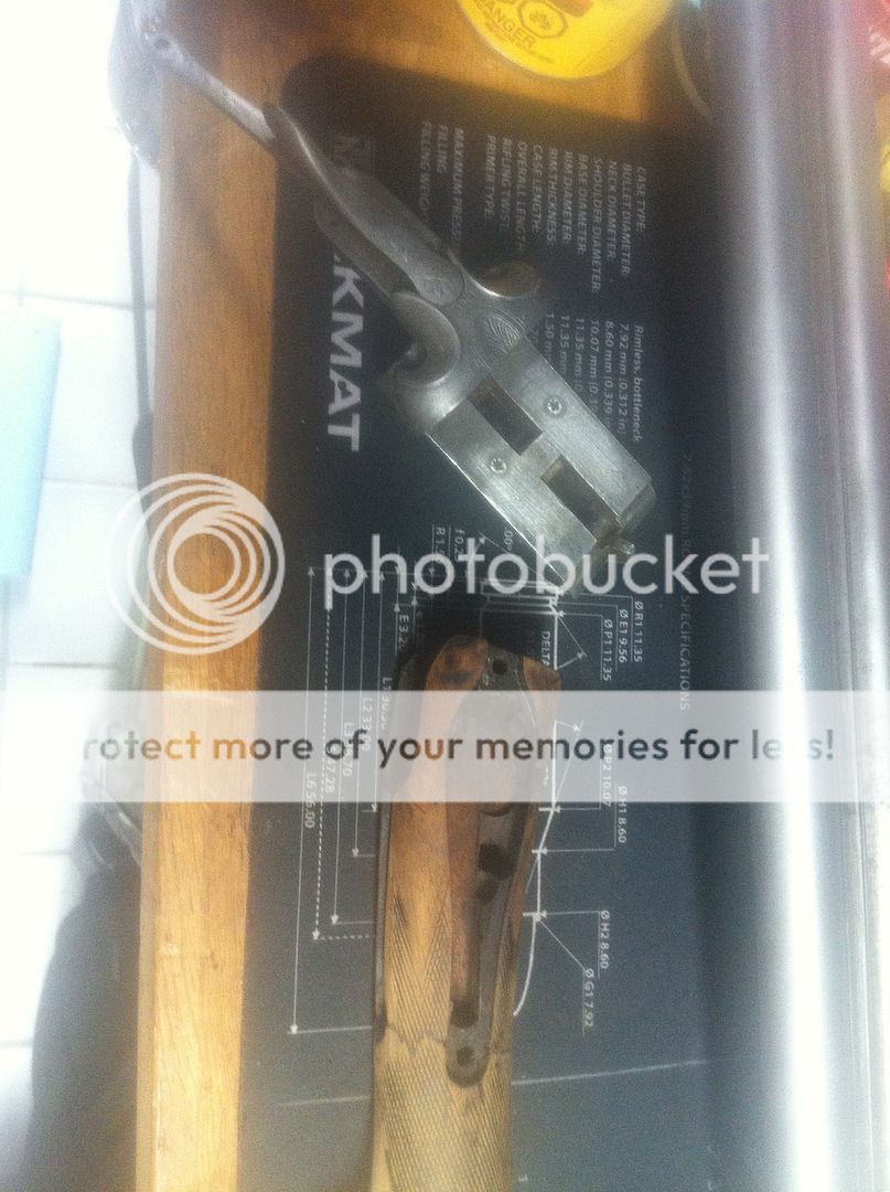

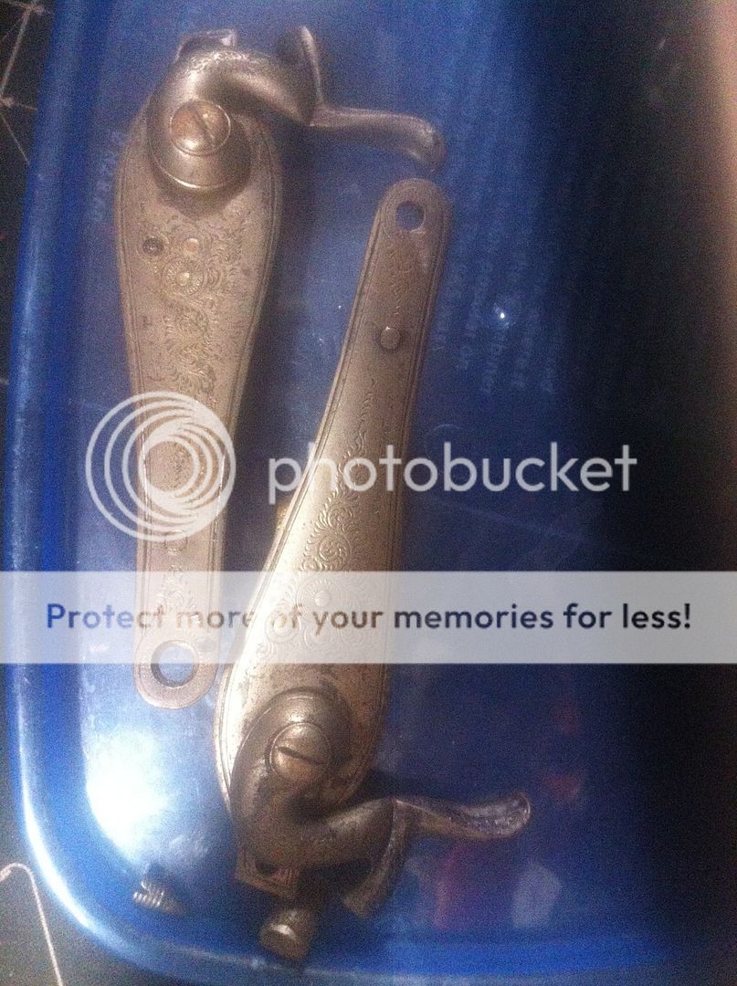

Certainly did not mean to take this long but life really got in the way. Ended up with eleven pins in all and quite a bit of epoxy. My honorary post doctorate in hindsight tells me that I should have researched more on colouring the epoxy before mixing. In my defence the nearest hardware store is 2 and 1/2 hour round trip. Not sure I can hide those glue lines now. Lesson learned. My cousin probably would prefer if it was green and yellow (JD colours) anyway. The shrinkage was very pronounced throughout the stock and that beechwood sure chips very easily. I went with Tung and Teak oil ,about 8 coats. There is a nice subtle curly grain in the stock. Putting everything back together was a long process. Finally got everything lined up and functioning properly. Still on the lookout for a new firing pin spring, not too concerned about that. Check out the checkering, looks like the guy was late for a hot date. The other side is perfect. There is a very excellent repair on the forearm, no idea when that was done, maybe at the factory. So no manufacturer's name anywhere, your basic utility gun that did rather well over the years all things considered. This was my first major rebuild and fully appreciate the help from all those who took the time to answer my questions.

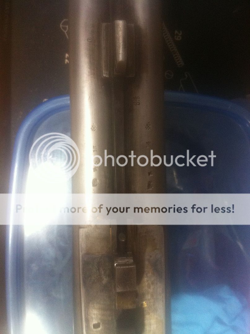

So now the big question...... Researching the repair of the 'off face' issue opened up the option of Tig welding the hook and then hand filing. I thought ( and we all know what thought did) that welding of any kind was a no-no on doubles. Mr. Midway on youtube says otherwise. He also shows a method using Loctite and shim steel. Opinions on the Tig weld method would be much appreciated. There is a welder in Smithers who is a magician so if it is a viable option that is the way I will go. Thanks in advance.
Actually Claven2 ,both ways are acceptable ,I know a little about this ...not every gun can be put back on face via a new pin ,and there are other acceptable ways as well ,a shim can be a viable alternative for a cheaper gun ,not the "right" way by a long stretch but it will work when there is just a little slop in the action .
The shim is the simplest alternative ,the other methods need to be approached with caution and education when filing metal from a set of barrels it doesn't grow back easily! and damage can be irreversible.
Bland, feel free to pm me with any questions .
Welding the hook is a very common method--as long as whoever is doing it knows what he is doing. There is also a video by Jack Rowe showing where he displaces metal on the barrel lug by striking it with a hammer. Apparently this is also an accepted British method.
Peening the lug (hook) is a method that I considered but was not recommended on a gunsmithing webpage I was using as reference. They claimed it was temporary fix at best. I prefer the weld because it would be more permanent. The welder in Smithers is very experienced. The shrinkage really contributed to the breakdown of the stock. As Claven2 mentioned the finish for the NA market was not the same as for the European one. Oiling this stock from the beginning would have been the preferable method IMO. So any guess on manufacturer?

Thanks for the interest, your basic hardware store special, I guess. Will be picking her up next town trip from the welder and get the files out and see how well I do bringing her back on face. My cousin is looking forward to getting his Grandfather's gun back. Those racoons better start getting nervous.

This has been a learning project on a gun with nothing left to lose. I see where you are coming from. To date my expense has been the dowling the rest has been 'found' in my cluttered basement. The weld will be very affordable and the rest just my time. Family project so not necessarily a practical one.
Bland, I think your gun is a "JABC". Don't waste your money trying to put it back on face. It's a nice wall hanger project with sentimental value. Hang it up.
