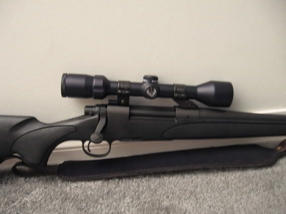

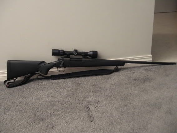

.....this is my Remington SPS DM in 7mm Rem Mag. may as well show a couple pics too.....
