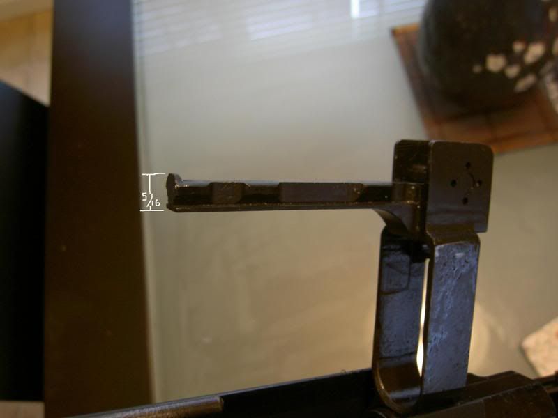

This design isn't really possible with the T97. The rail and handguard on the 97 look like this:
Then the mount is surrounded by a polymer "handle".
A duckbill mount isn't really possible as the design must have a solid resting point at the front of the handguard. The nub at the end of the stock rail kinda prevents that, so really all the stress of a cantilever mount would be right at the nub and the bottom of the back end of the dovetail, which is cut short by the indentations on the rail. It has totally different stress points than the AR design because the handle design allows it to sit tight against the full metal hand guard, relieving stress from the mounting screw.
